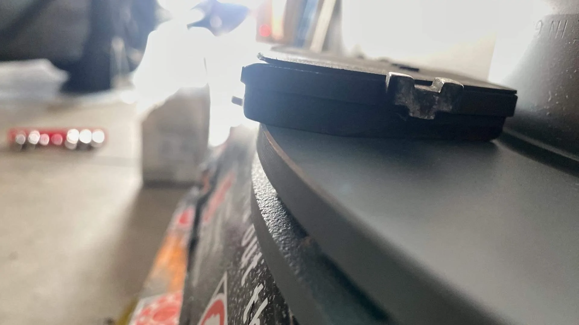

Sorry to bump this, finally putting the rotors on now and the rear rotors that I ordered linked here are smaller than the OEM ones. This should not be the case?
Well d@mn. I compared the front rotor up against the factory front, but I didn't do it against the rear. I'll do that this weekend. I haven't put mine on the car, as I'm waiting until just before I leave for OneLap to flush the brakes and put on the new pads/rotors.
