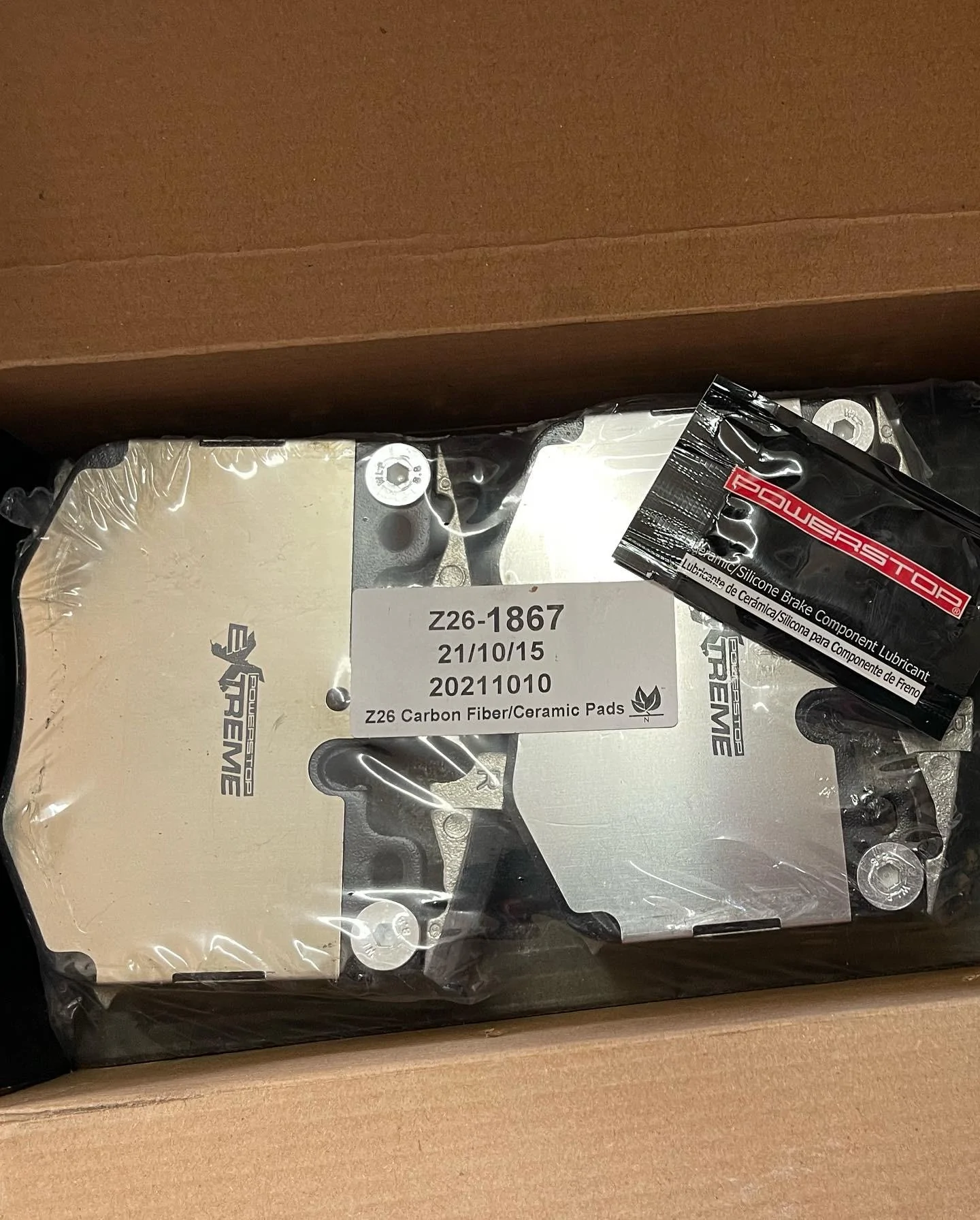

If it is missing shims, then I don’t know what else there is because here is a pic of the z26 pads before installation and you can see the metal shims already attached to the back of the pads, exactly like the OEM pads. I will try to put more lubrication grease on the slides like suggested and give that a try.

shim is definitely there from the manufacturer. have you tried to put oem shim on it? assuming oem did not make the noise, oem shim could determine if the pad is right size. that's what I had to do. shim does work as spring.
I did not try that but I could. Thanks for the suggestion. However, I did put the OEM pads back on and the clunk is still there.

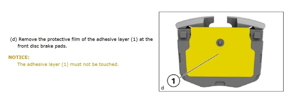

Just showing up to say that there IS in fact adhesive on the stock pads. Here's a snippet from the shop manual. So you're not insane my friend.

Here’s even more definitive proof of the adhesive on the OEM brake pads.
