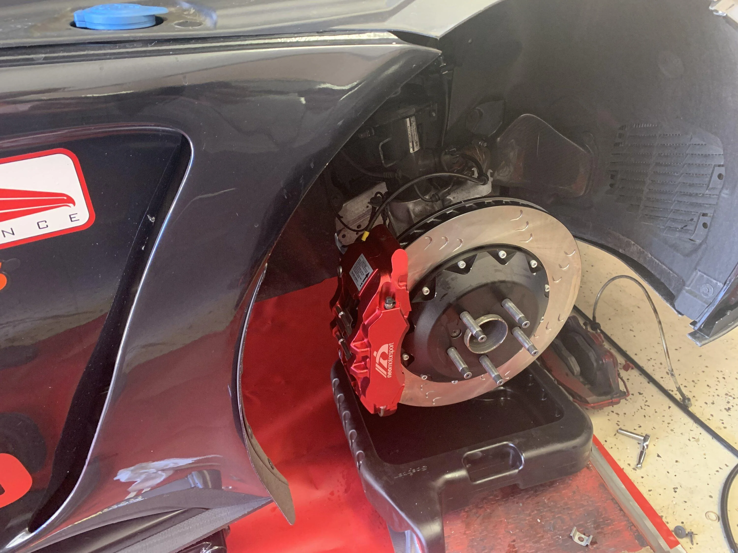

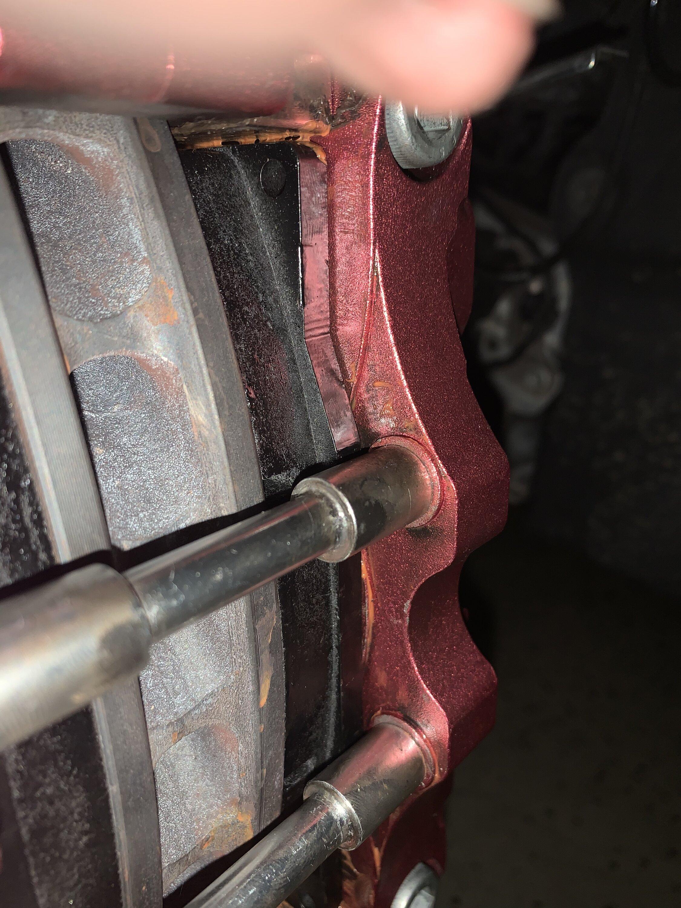

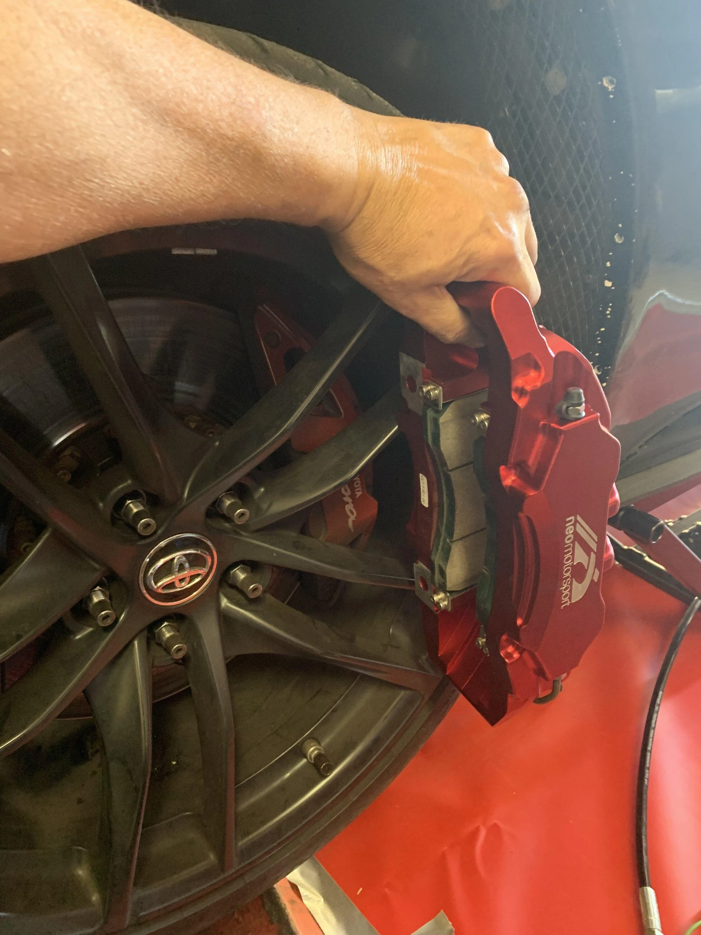

This normally has to do with the retainer clips and pads. They move back and forth on the stops and make a clicking sound on the pins. Should not impact functionality but more if an annoyance. I have a Supra and have used all kinds of pads and rotors on over 50 track days. And recently upgraded to big brakes. So happy to discuss if needed.
Have any of the pads you’ve used NOT had this issue? As someone suggested above, they have not had noise issues with CSG pads. Also, what BBK did you upgrade to and do those have the same issue with the pads sliding around?
I did not have this with any of the pads and stock caliper. Did you get the clips on correctly so they have tension on the top? Also I grease all the points.pad seat, back of pad and piston and even pins / clips. With high temp brake grease. I had to run upgraded calipers with no clips and got the clunking noise as it just had the pins
