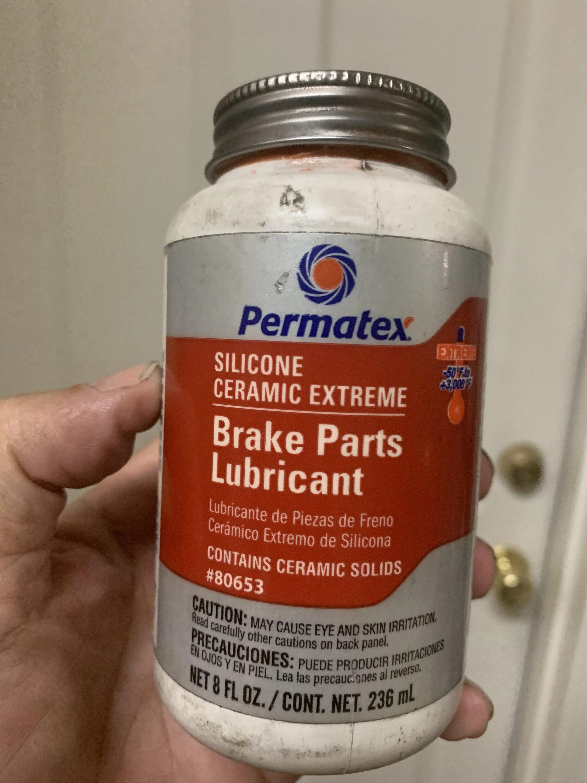

Is that grease for the hardware or adhesive for the pads?
I am not sure what you are referring to. You do not use adhesive on brake pads or parts? This us what should be used even for the backing plate /piston contact. Are you referring to some of the brake squeal stuff

Well I hate to burst your bubble but oem pads are not glued to piston. My brakes operate 1400 F on the track. (Have heat painted rotors to measure) so these get hot easily. Oem brake grease is lesser heat range than what I showed you. This tends to cook and get hard so will crust up a bit an the backing plate could have stuck a bit so could have app appeared like it was “ glued” but there is no such thing as adhesive. These Brembo brakes with the pins in them will clunk if retaining clips do not hold pad down and allow it to slightly move up and hit pin. Greasing the ears of the pads were they are on the slides also helps. If you just slapped the pads with no cleaning skids and lubricant then this is probably part of your issue.
