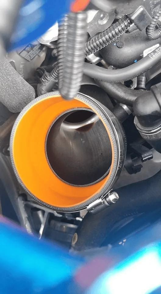

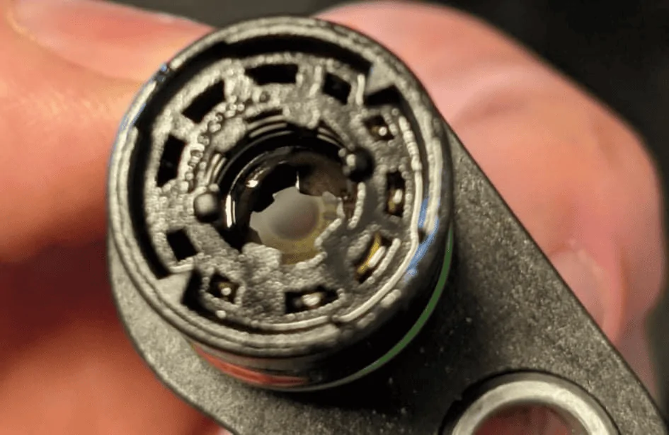

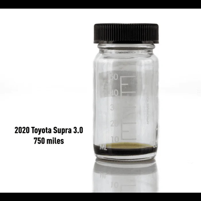

I have personally dismantled and inspected the turbo inlet, PCV port + lines, CCV port + lines. I found oil contamination in all three locations, and a measurable buildup of oil-contaminated condensate in the turbo inlet adapter. BMW has built blowby remediation capabilities into the B58 engine, but they are not perfect. I do not agree that catch cans are not required for this car.
I personally recommend a dual catch can setup for these cars to eliminate all oil contamination of the intake system.
//EDIT: For example, here's oil just chilling in the PCV hose after I pulled it off the block. People have said that the B58/Supra doesn't put oil into the PCV, and here's photographic evidence that it's untrue. I found oil on the ID of both PCV hose ends, and the fittings themselves were oily.
And here's oil-contaminated blowby sitting in the intake pipe just 200mi after cleaning it out. I took it apart again 500mi later for another mod and could physically pour it out of the pipe into a jar (didn't take a photo). It was at this point I put catch cans in for both vents.
And here's what Mishimoto collected off of the CCV after < 1000mi of driving.

Just FYI, I just swapped out my intake and found oil build up on the bottom of the intake tube right next to turbo inlet. So there is oil making it down there.

I definitely saw some down there last time I had everything opened up. Not as much as @Thraxbert, but it was an amount.
