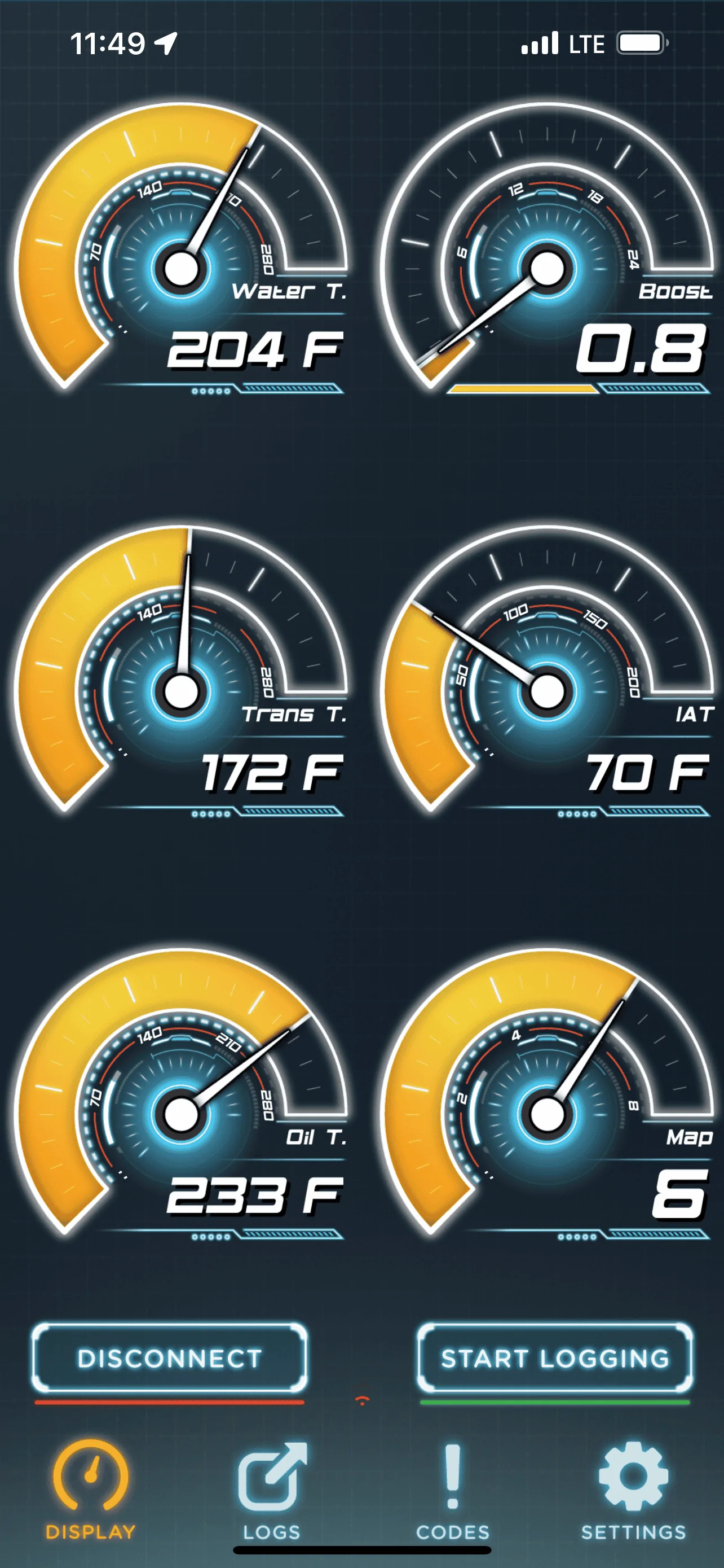

I don’t know why my temps are so low, but it says 70….you can see my car is fully warmed up and that’s after hard driving… @Jesse DaBears am I reading this wrong?

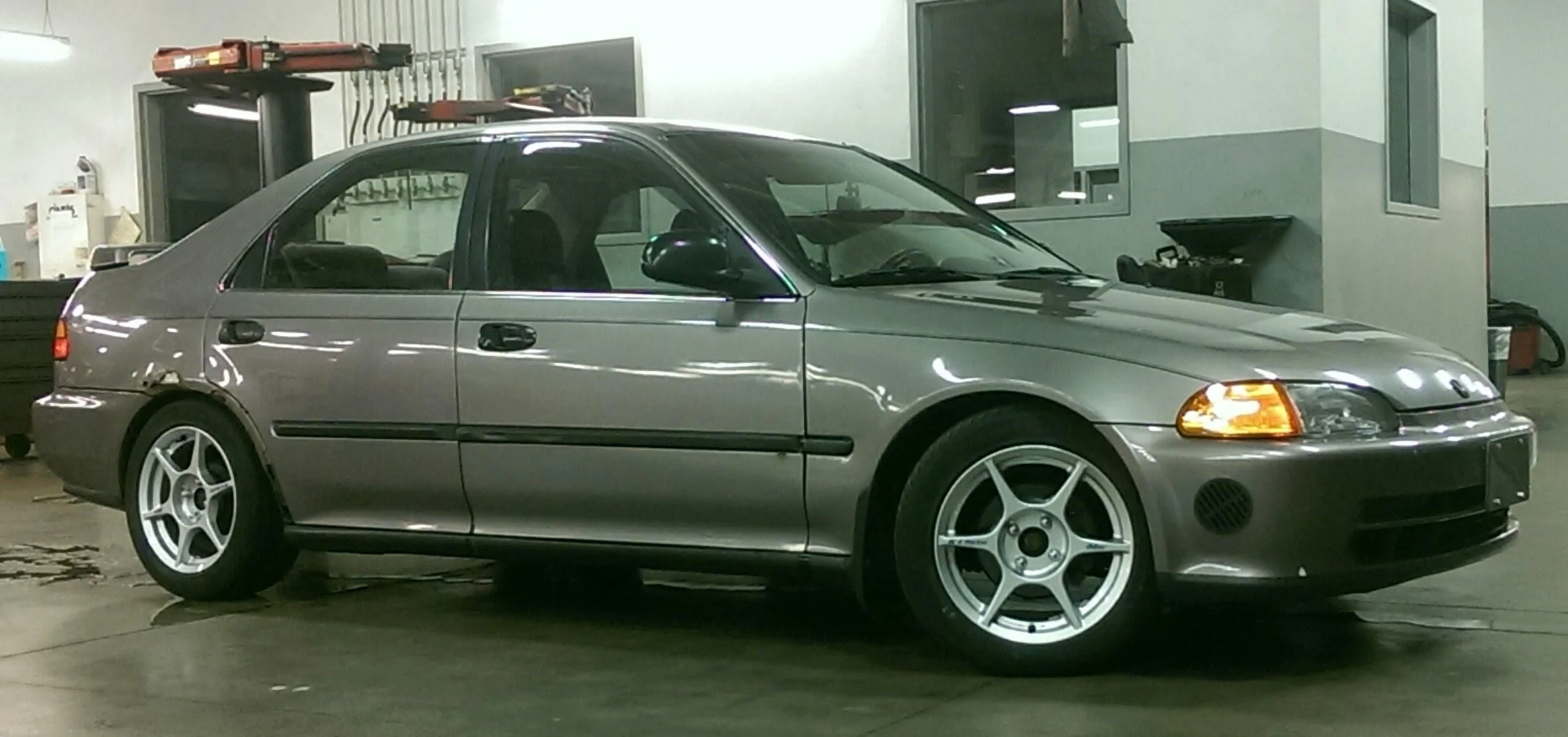

I love this! I did something similar on my old EG8...
..and yes, it's a polymer shower drain, and it's even "clocked" in a way that netted the airflow characteristics I was shooting for at the time, because when you have nothing but time, a shop vac, leaf blower, & fog machine at your disposal..why not?
We made several DIY systems with enclosures & heat shields over the years, and nicknamed them "iceboxes" because in the fall & winter, you could be out thrashing on the car, pull over, pop the hood, and the intake tube & plenum would be freezing cold to the touch.
Probably not. Is this while tracking? I’ve never had any problems overheating on the street with Jesse’s sweet custom map 6. He really knows how to dial it in perfectly. I can mash on the throttle all I want in town for freak on a leash Mode. Even down here in schweaty FloRida, in the summer ?
Go under your user settings. Sounds like the IAT spoofing is active.

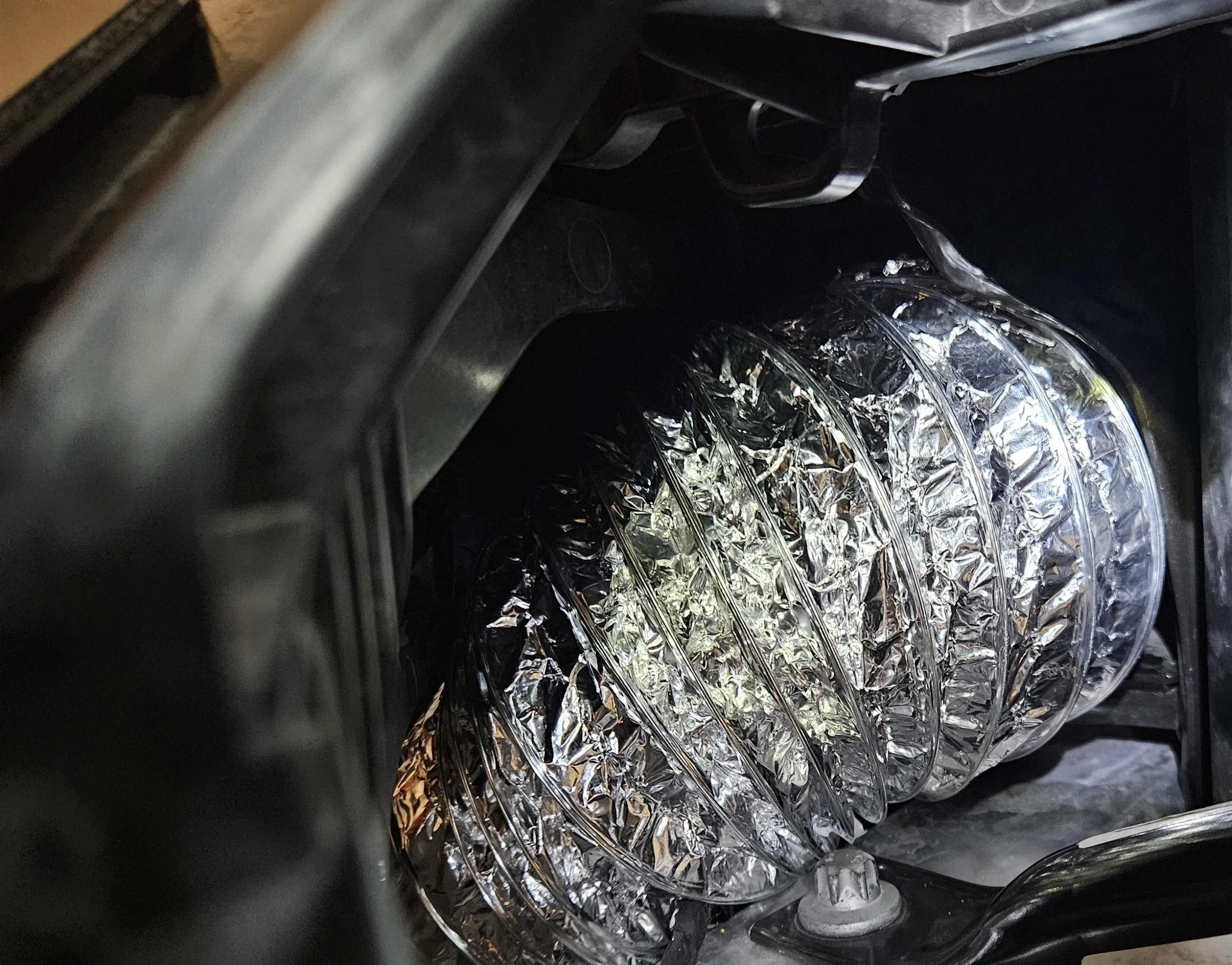

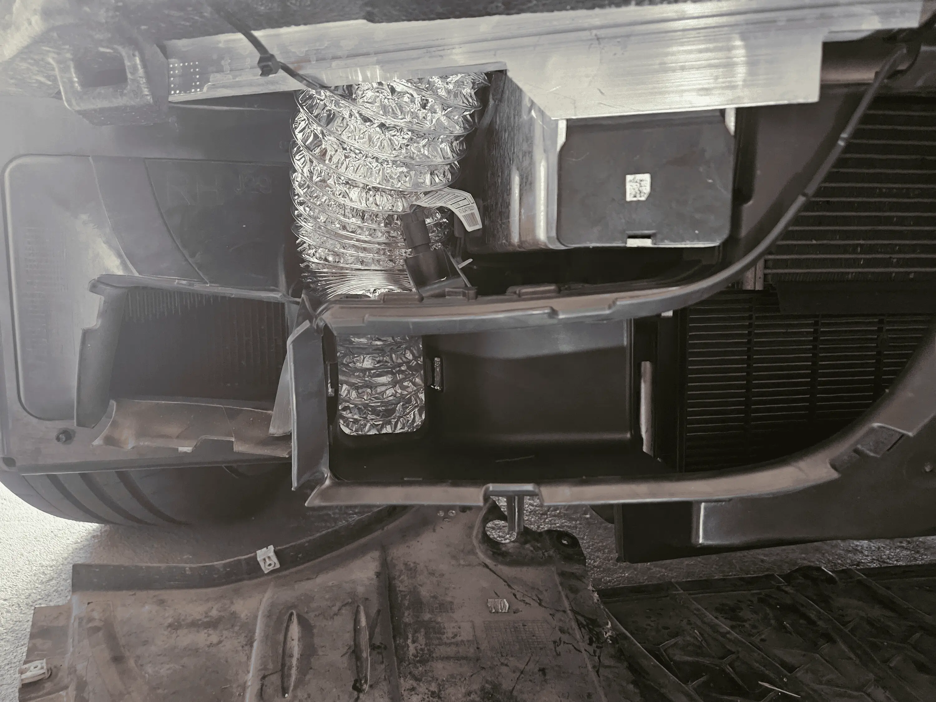

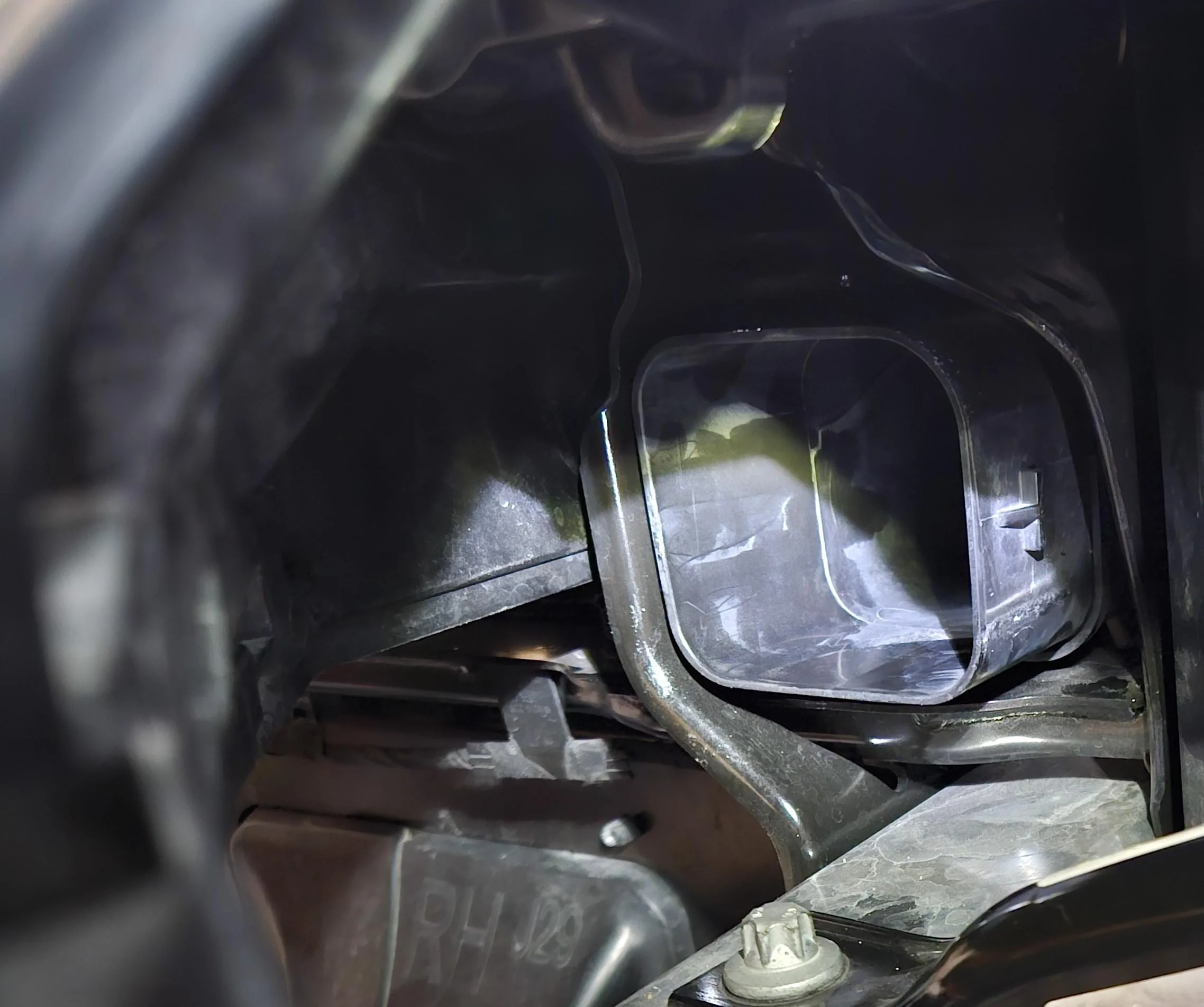

I'm noticing ~10f lower iats with a similar approach (modded stock airbox).
Rerouted the passenger brake duct.
Removed the stock velocity stack to fit the duct.
No drilling or cutting, front bumper has to come off.
Did you need to remove the fender liner to delete the brake duct?
