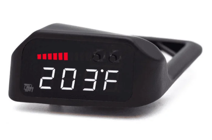

Theres a few competitors to this venture, shown here for comparison:
P3 V3 OBD2 - $399
Notes:
- Simple clean install
- Easy to understand
- Only one reading displayed at a time
- Manually controllable dim/bright (and dim is not dim)
- Unintuitive UI.

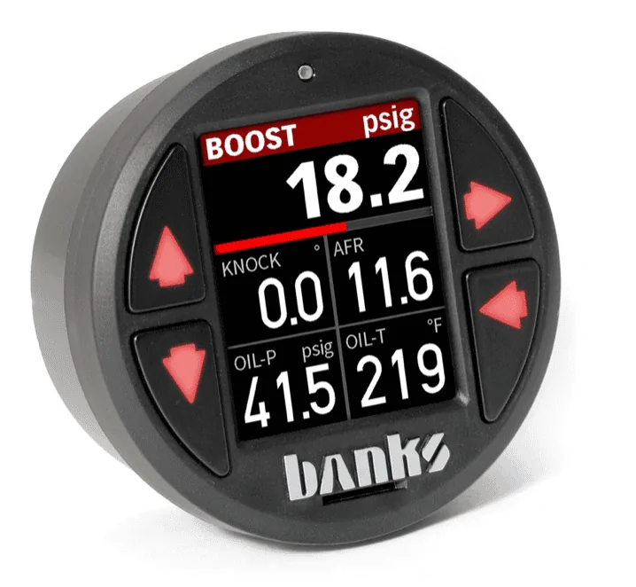

Less than $300 USD. https://bankspower.com/products/banks-idash-supergauge-datamonster
Not as polished compared to this render, but has the ability to show 8 metrics at once and can be daisy chained.
These gauges are limited to OBD2 data.. if you are looking for more comprehensive data metrics, power train data, driver input data, you need something that can access PT-CAN and D-CAN.
Any data device that does not splice into BOTH can modules in the passenger footwell, will be limited in what data it can display.
That only shows generic obd2 data that any obd2 adapter and your phone could show.
OP is creating something that will show BMW specific data like what ecutek and bm3 can show/log
The CAN-CHECK product can do this as well but quality is a bit crap and support is bad.

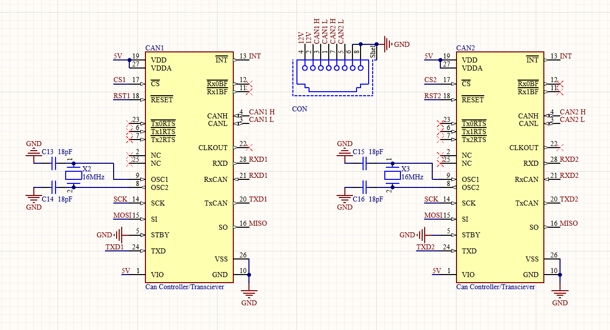

Also my module is designed with 2 CAN controllers, which means you can tap into BOTH D-CAN and PT-CAN AT THE SAME TIME, which most gauges or data loggers don't offer, you either tap into D-CAN or PT-CAN. With mine you get 2 sets of CAN High and CAN Low wires you can use to tap into both modules.

He makes a good point, however. The Banks gauges are excellent because you can show up to 8 simultaneous values in a standard 52mm gauge form factor. Banks does this even after giving up nearly 50% of the display surface area to tactile buttons. I have two Banks gauges myself, and I like them a lot, but you've highlighted my pain point: no BMW-specific PIDs. Banks under-delivers on data, but sets the bar for a compact and functional interface.
I would dump Banks gauges in a heartbeat if you could deliver an analogously functional and adjustable Ux with the addition of BMW-specific data like knock, trans tempt, ethanol%, etc. I would probably pay any price you chose.
