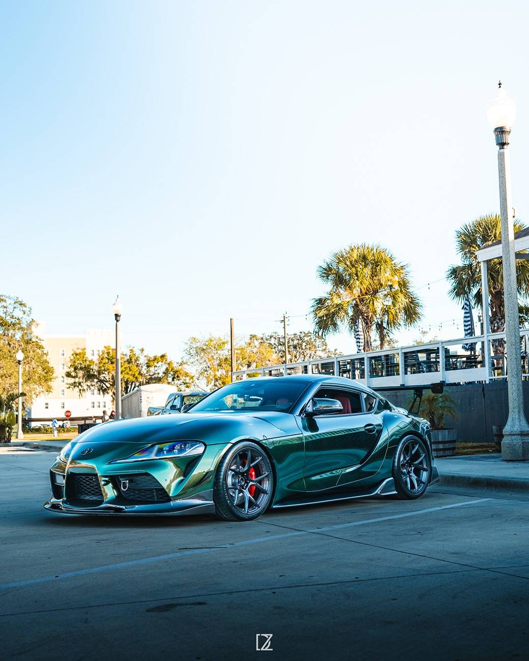

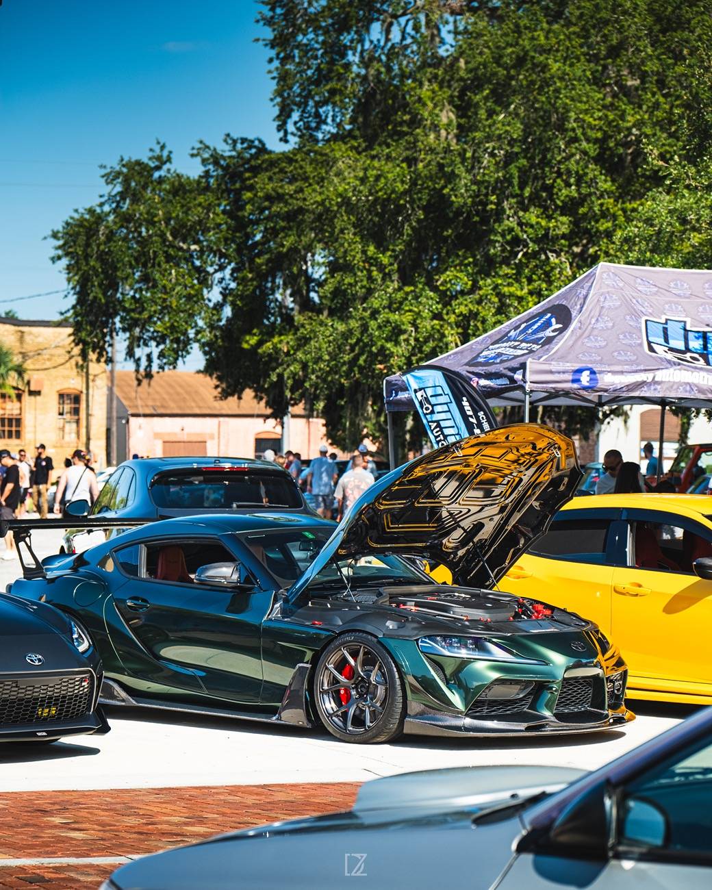

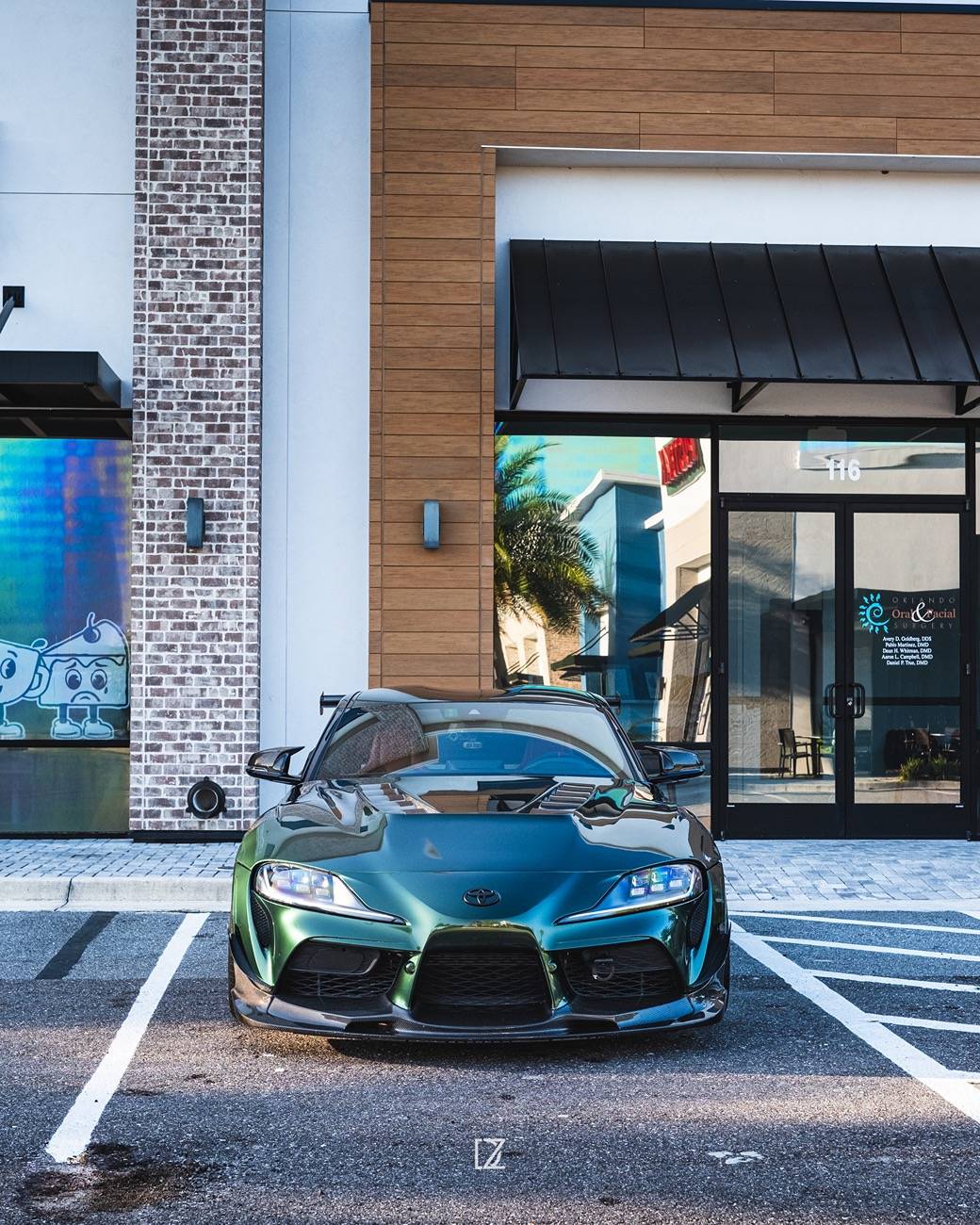

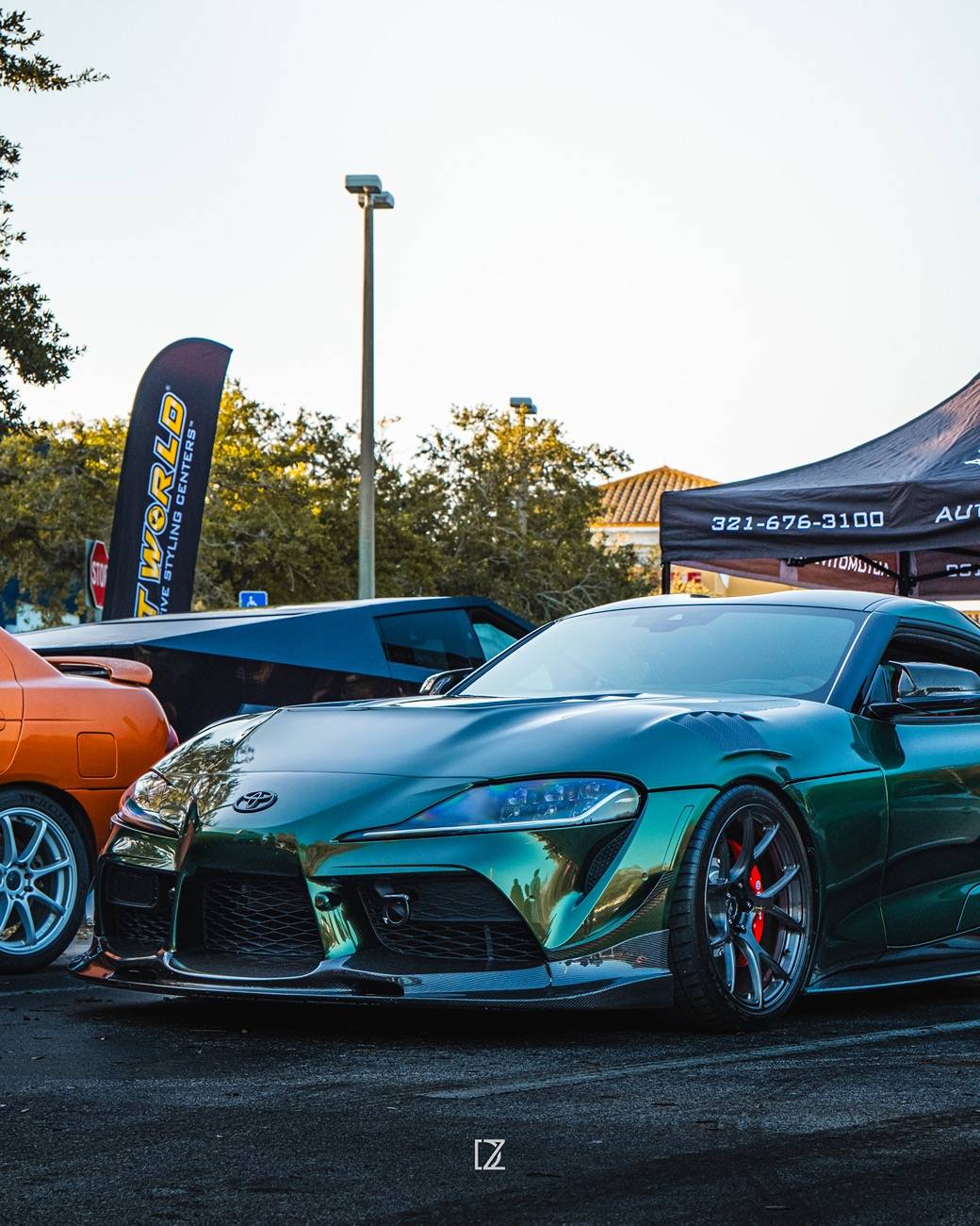

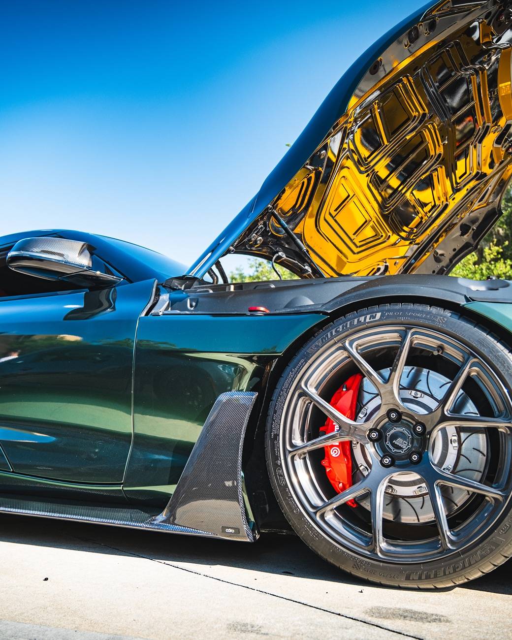

Havent updated in a while.
Finally got the KW's installed.... and I am rubbing, badly in the rear. Started another thread about it but it gained no traction. Talked to BC whos surprised, they have lots of sets with the same offset/tires and even guys on bags, and none of them rub in the rear.
I ended up having to raise the rear to deal with it, but it still rubs over bigger bumps. Got an alignment in case that was it, but the rear camber is not adjustable and was at -2.5, I cant imagine ill need more, but I ordered SPL arms anyways so we can try it. Hopefully i dont have to go crazy with camber to get these to fit. I guess worst case I could go down to a 295...
Other than the camber arms, not much on the way. I think the wife got me some small stuff for xmas, we will find out soon. Trying to decide what to do next, but the rear rubbing issue has me kind of down on the car.
Anyways, heres some pics of me installing the suspension as well as some wash/show pics. Enjoy!
