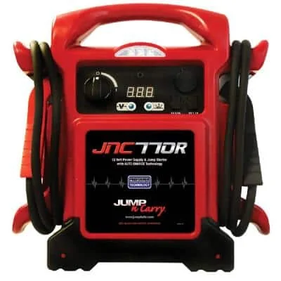

I had the same exact issue until I fully charged my jumper box, then it started. I even tried jumping it with my 4Runner and that didn’t work…

@NewSupraOwner I don’t know the brand name, but it’s just a standard jumper box that shows how many volts it has. I have no idea why this worked and my 4Runner didn’t, but it did…
