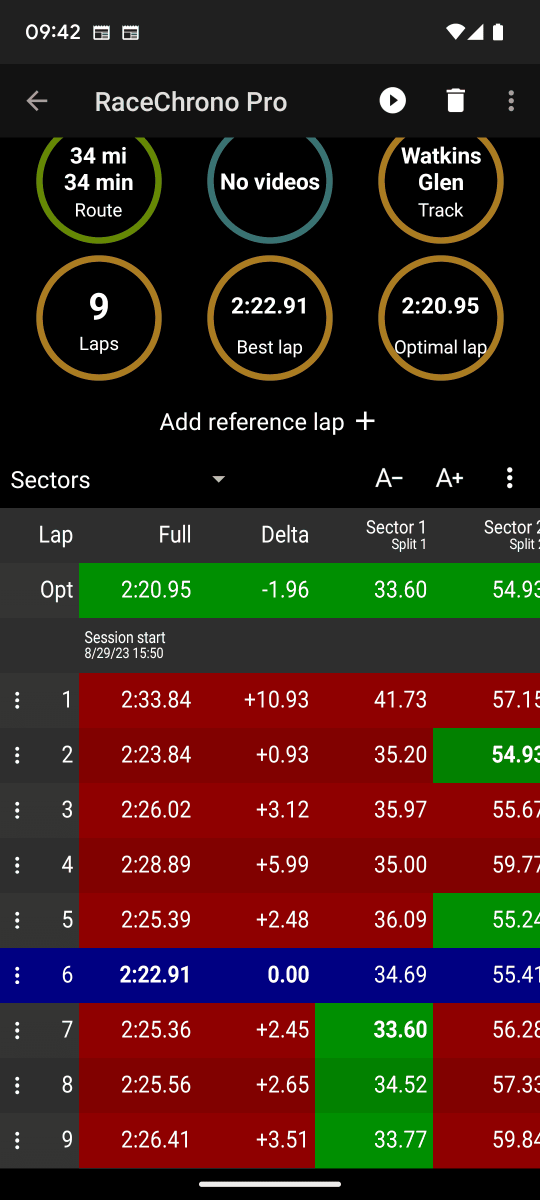

The RaceChrono Pro is working WAY better with the powered GPS antenna. I was happy with the performance at The Glen.
Next step is to get the data logging working. After I'm happy with that, I'll look at video capture either with my phone camera or a GoPro Hero of some sort.

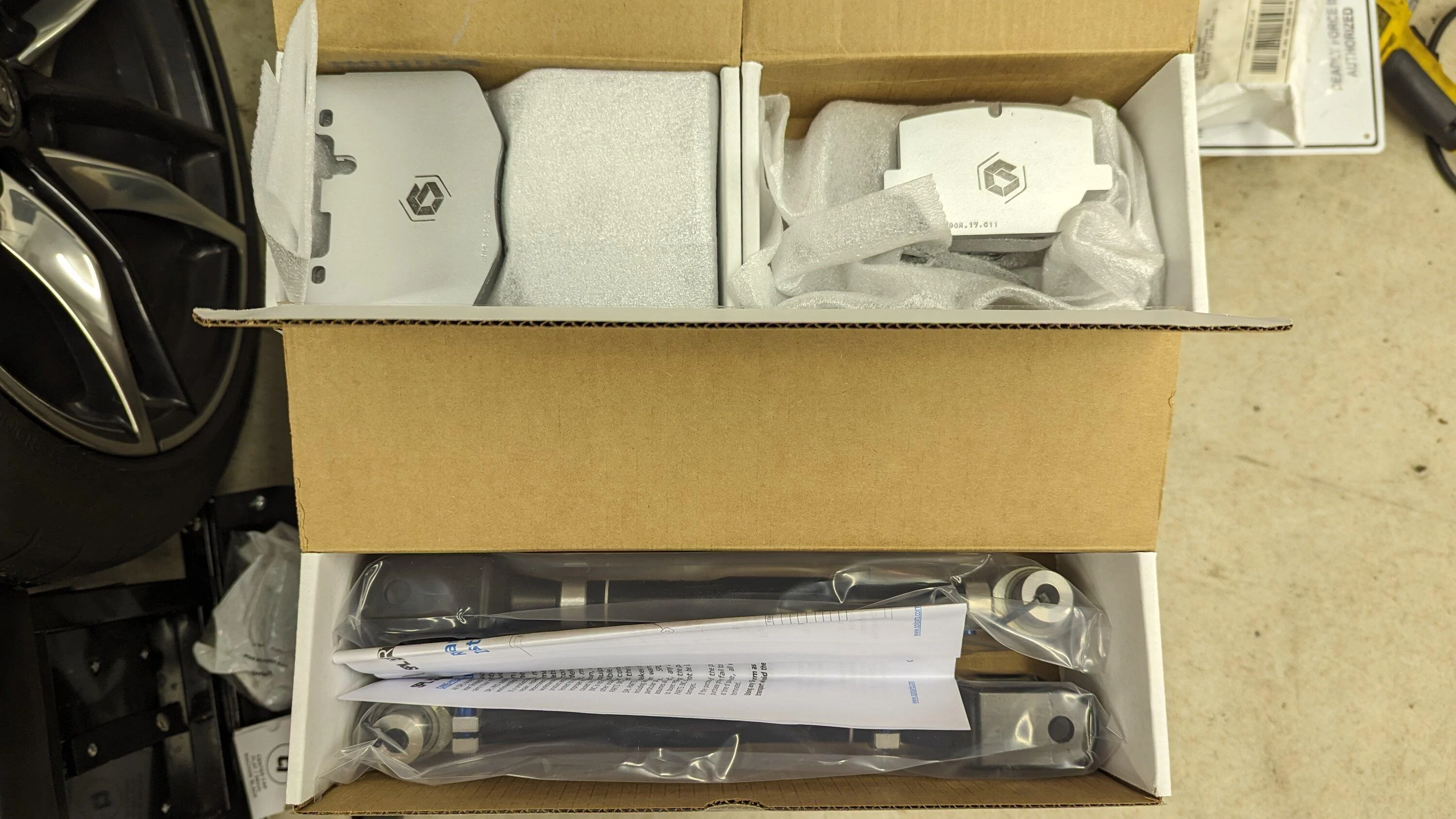

I bought some new Zimmerman Z-coated rotors from FCP Euro that I'm going to use with the opulence pads. The pads were $300 more than the set of rotors. ?

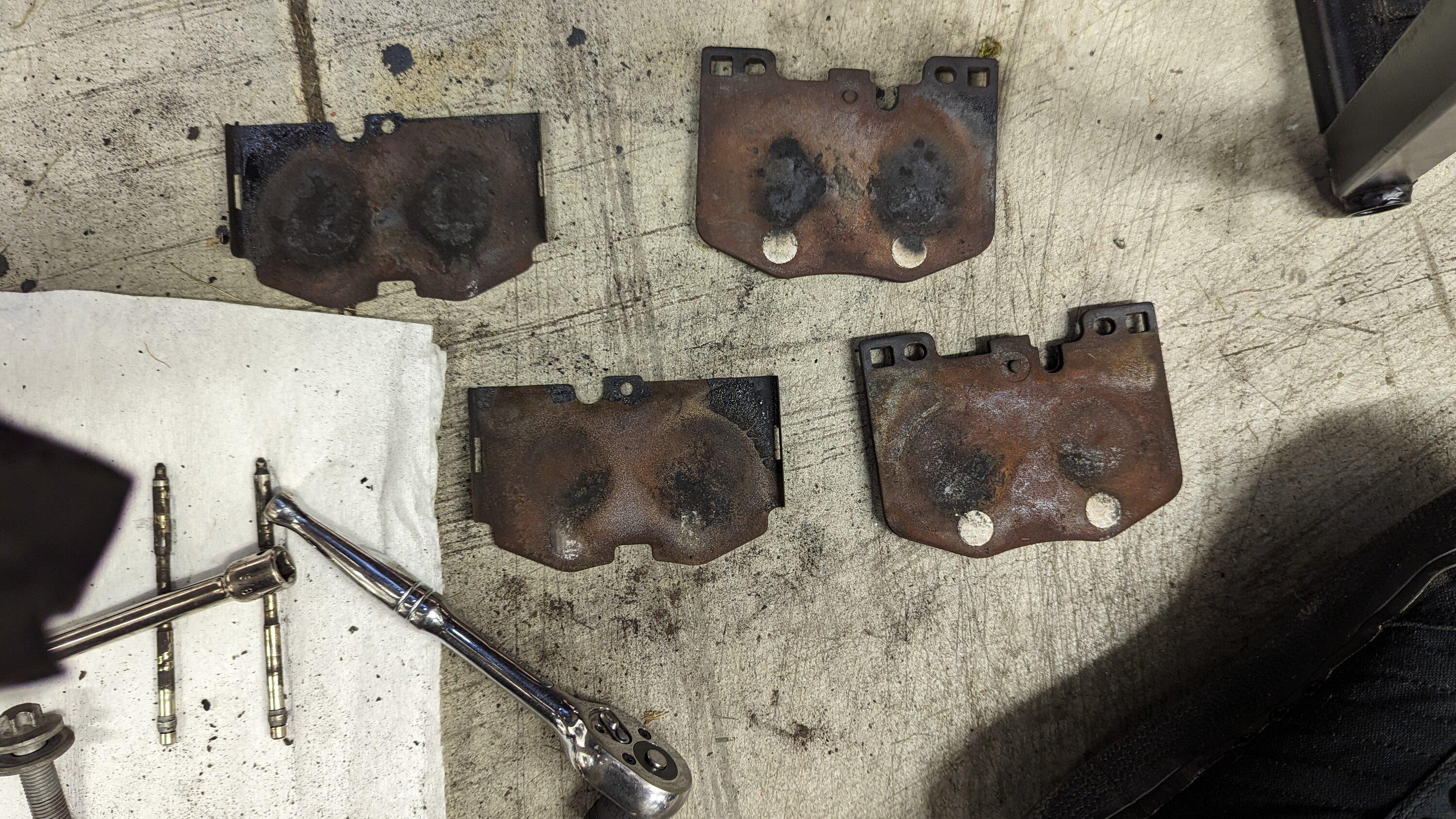

The old rotors that I used with the PMU pads are going on the shelf until I get another set of front pads. The rear pads as well as the front and rear rotors actually still look okay. It's a bummer I couldn't find a set of front PMUs anywhere, that's really all I needed.
Decided to pick up the rear traction bars too to hopefully eliminate the last of the bump steer. Hopefully these will make Turn 9 at Thompson feel a lot better.

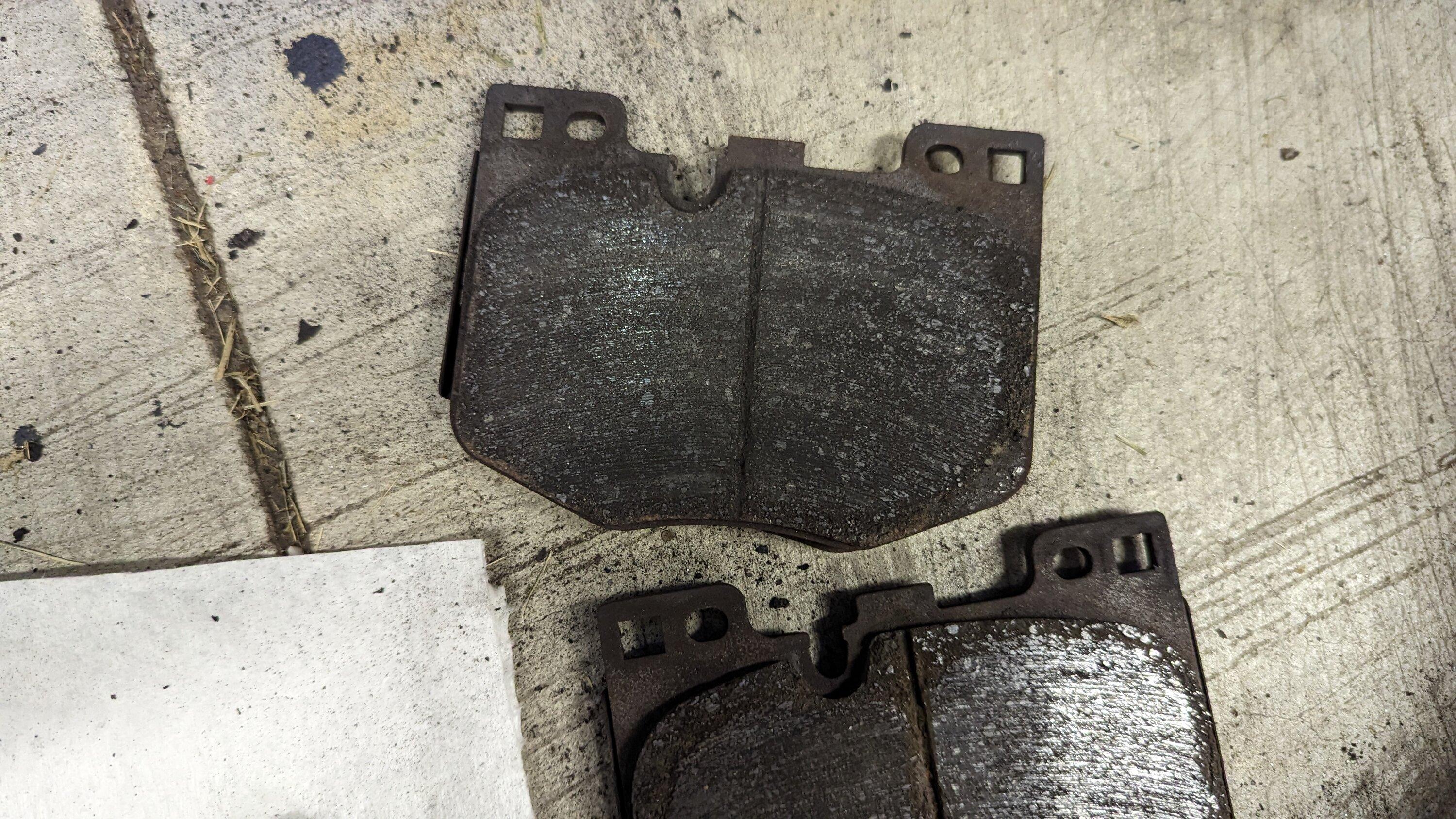

Some pics from the brake job...
Old PMU front pads...

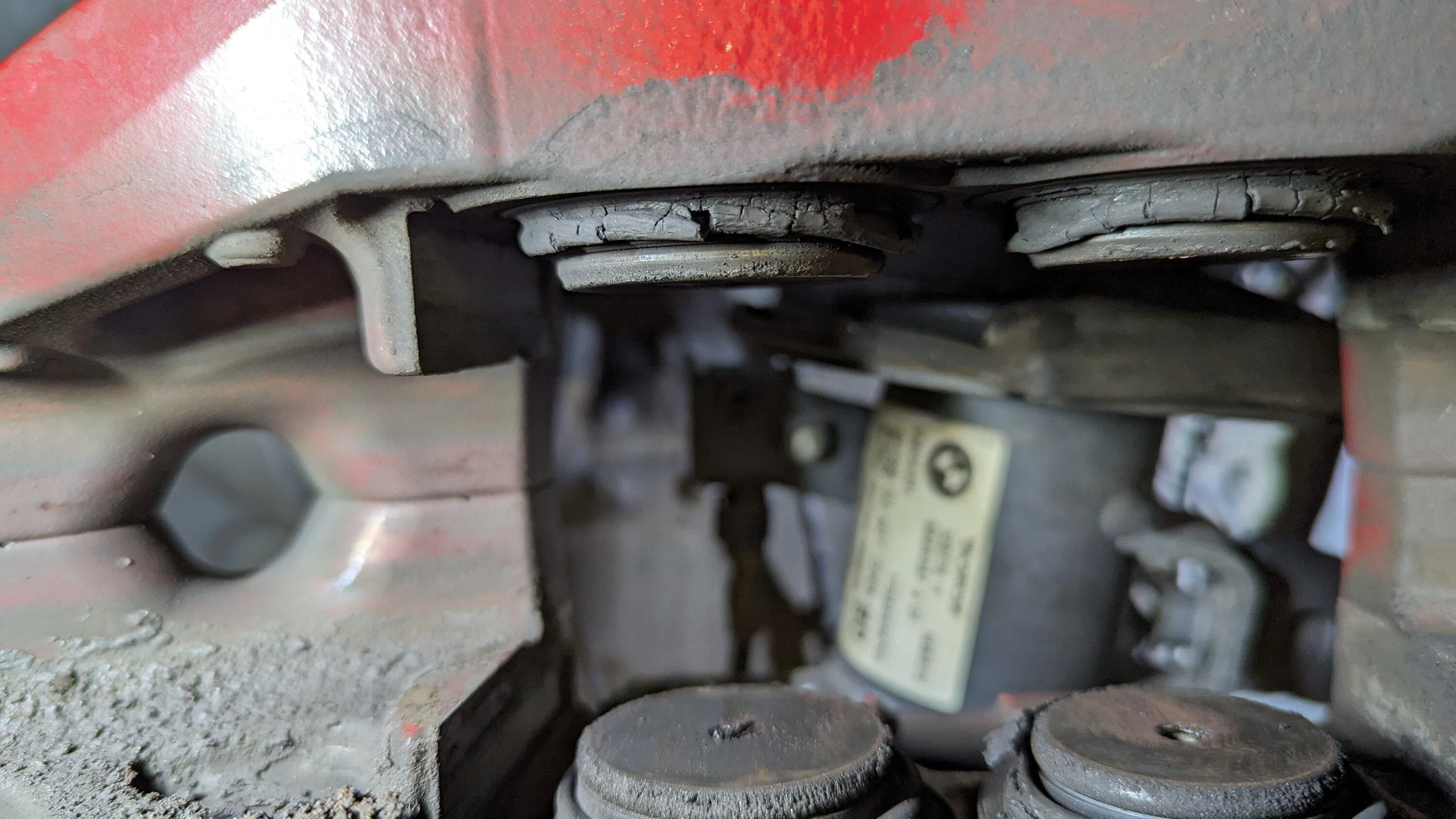

Looks like the rubber dust covers on my calipers are starting to give up the ghost. I'll replace these this winter.
New pads and traction arms.

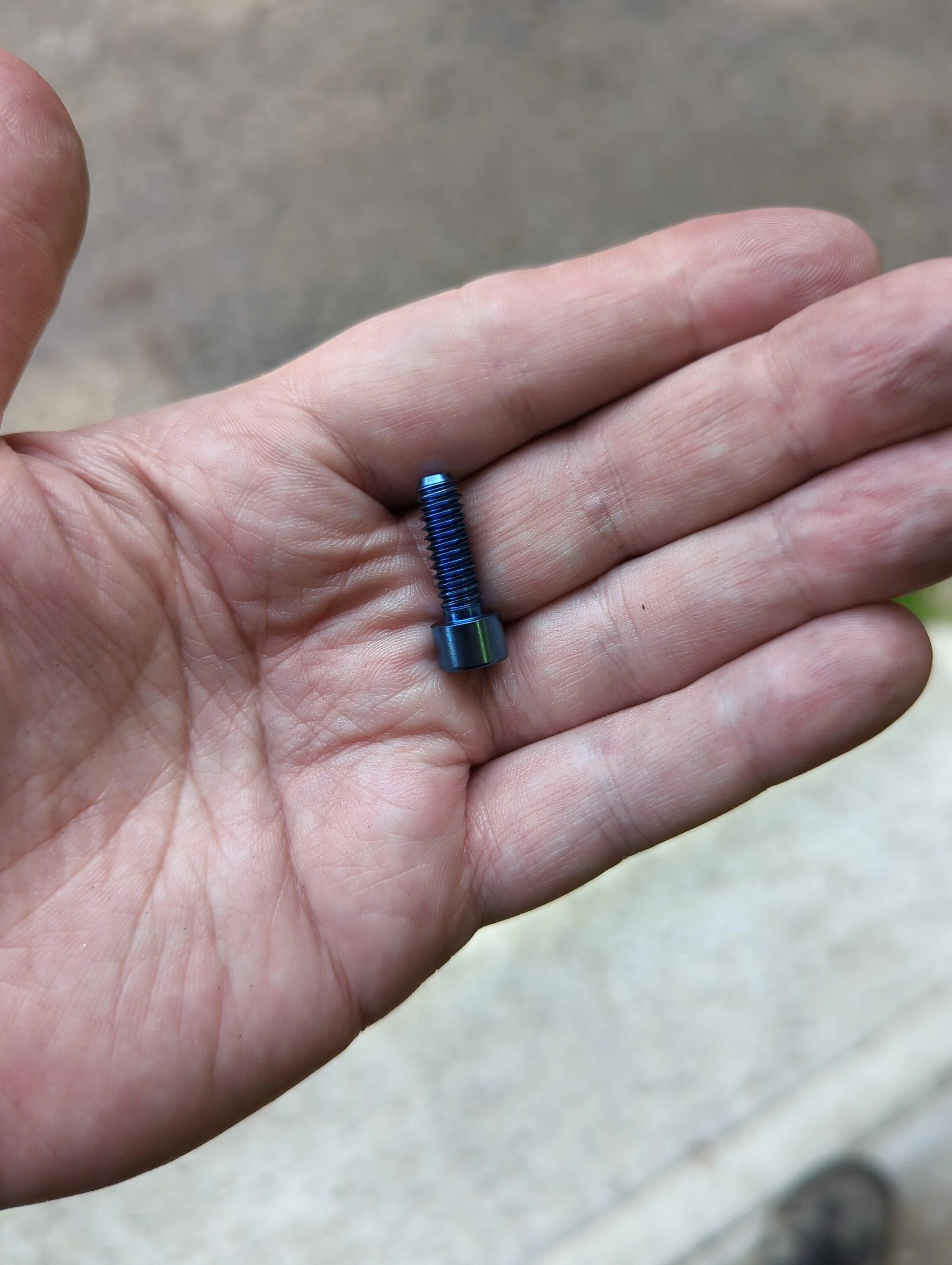

Misplaced one of these:
Luckily it's just a 1/4-20 stainless steel socket head cap screw and the Ace two miles from my house has replacements. I bought a handful.

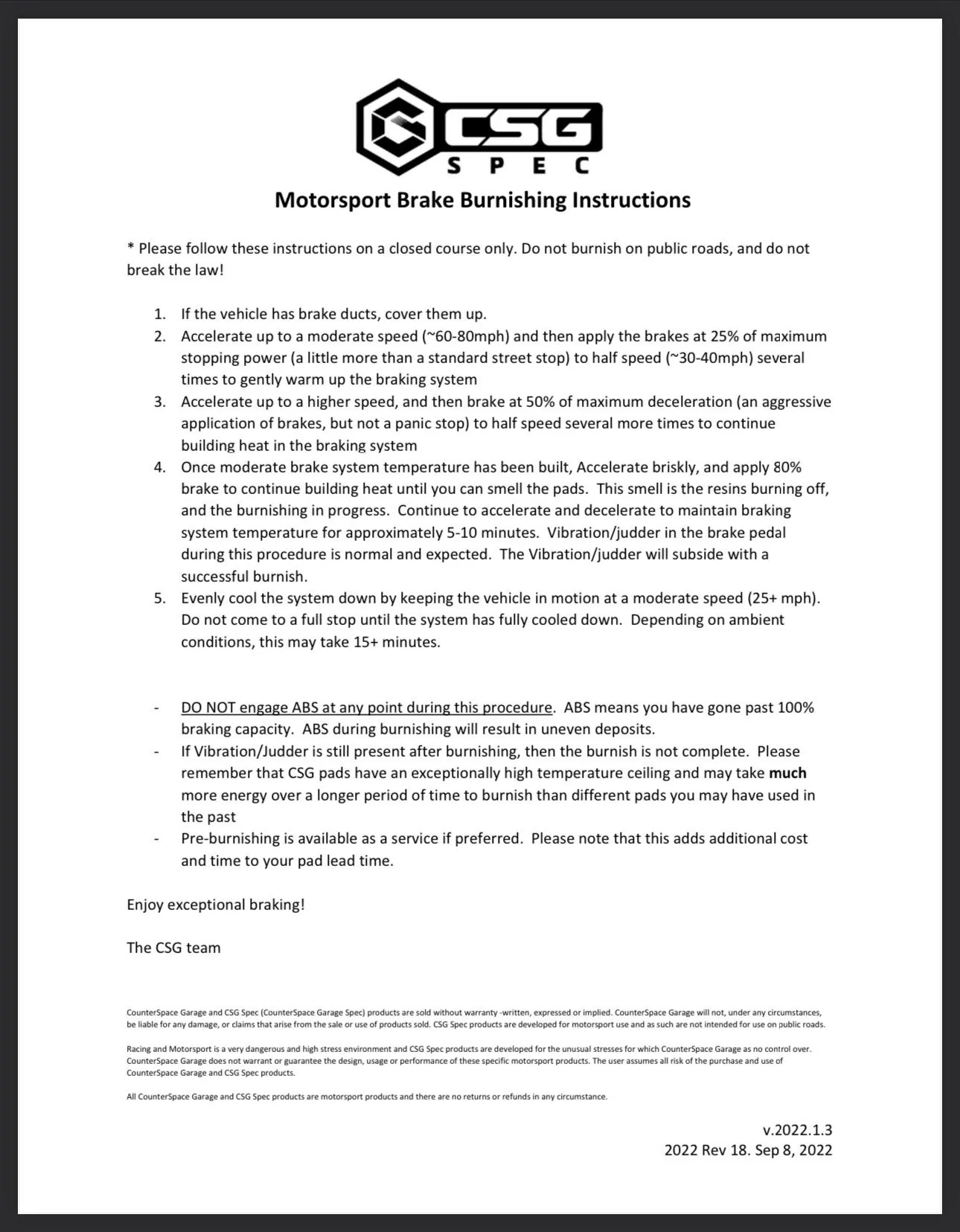

Light sanding to the rotors to remove OEM brembo material first?
i don't. it is an agressive material it will sand and or smear its own coating
i do 50-10, 60-10,70-10,70-10, 70-10, 90-10 that will get a good base. and then on track you will feel it laying down more material trick is to get an even transfer. If it goes on uneven or you get any shuddering, just drive and brake even harder at the track.
This is all solid info! My wife works at CSG, so figured I can forward you this document, hope it helps.
Great info just as Rock said! Takes a lot of heat ?
Maybe your wife can get us a group discount? ?

Dang dude you’re going to have sooooooooo much fun! Especially with such an aggressive pad ?
I’ll look into my caliper dust covers as well. Those are pretty crispy ? Do you have a part number for them yet? Probably cheap to pick up I’d assume

It's been an awesome summer!
No PN yet, I'll be looking at doing the work in a few weeks after my last few HDPEs for the year.
