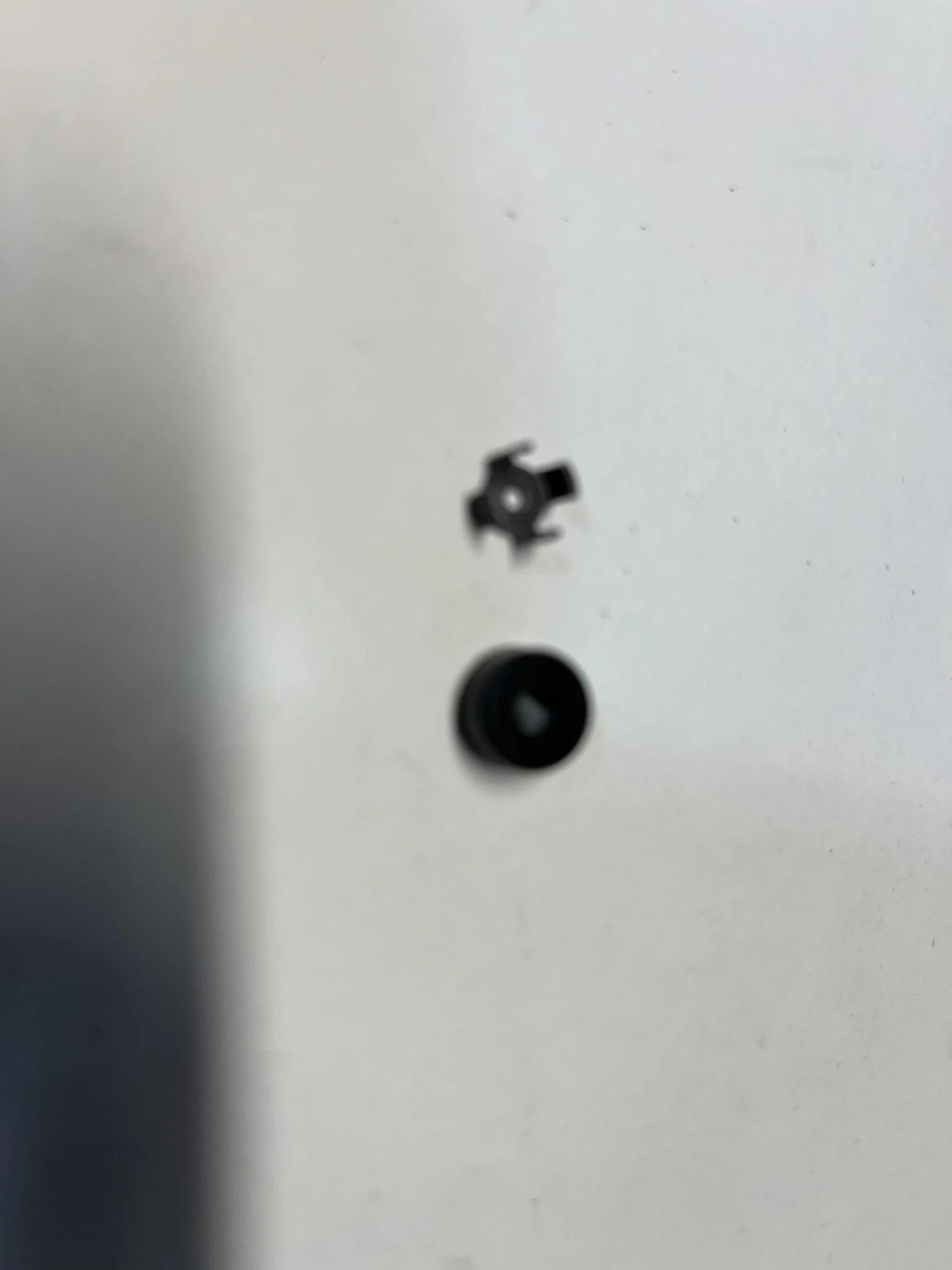

One thing to note is that the CDV is tiny, way smaller than the pictures make it look. The screw needed to pull it out was much smaller than I expected.
