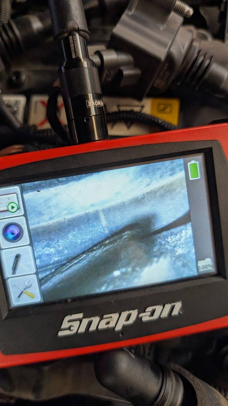

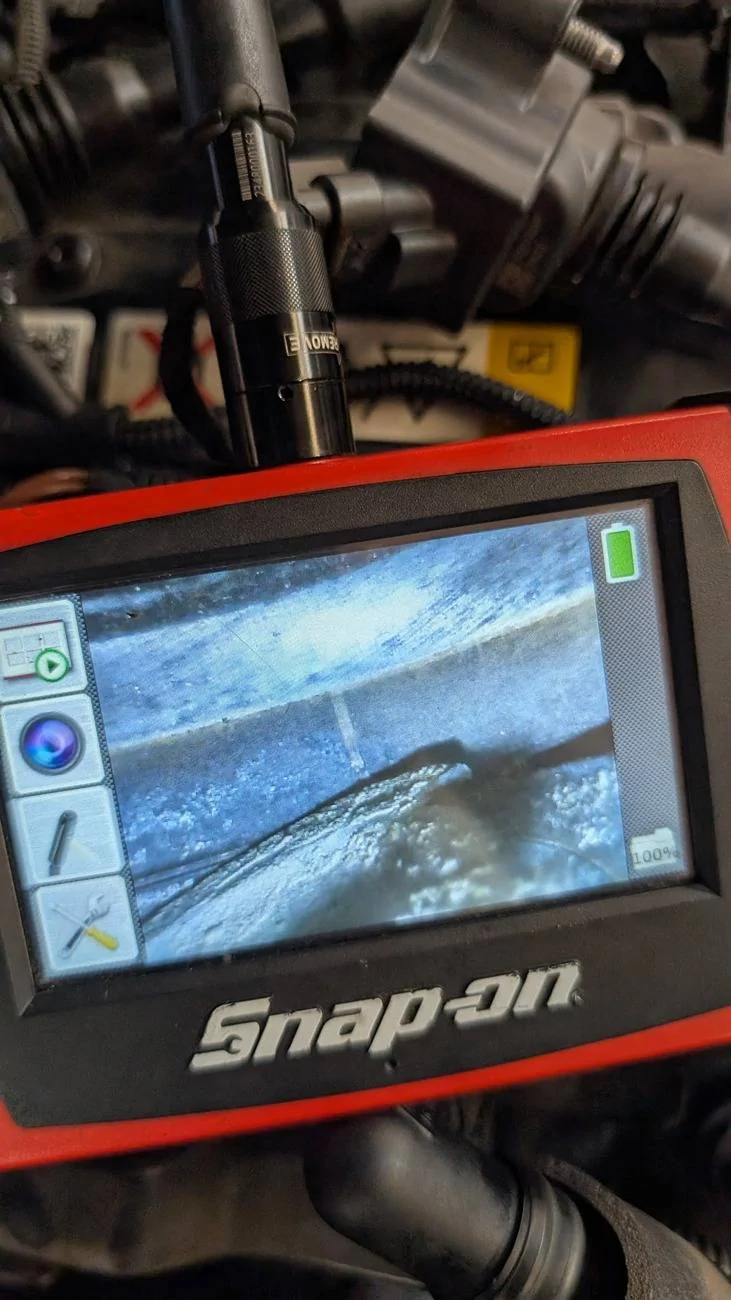

True to form, can't see shit with that insanely expensive Snap-on tool.
What are we looking at there?

It's a given the head has to come off. Once it's off you can rotate the crank and move the pistons to check the full length of the bore with your own eyes. It means it takes more time if you have to revise your plans after the car's getting disassembled, delaying the decision on needing a block or doing any work on the current one, but you'll get in there with your own eyes,
Yea I remember you talking about the snap on boroscope even my work said those are horrible pictures. Just gonna have to tear it apart

you think if he deglazes cylinder 6 and move up to a 50 weight he can avoid oil consumption issues?
LOL
Now that you flipped it, that does look like a valve up top with an interesting portion of it seemingly torn away. Then you have an area where the compression ring never quite makes it, followed by where they do. I want to call that honing crosshatch but i don't think that's what they actually do at the factory (or, is it?). There's a specialized electro something process needed and not your normal Sunnen hone you'd use on something a lot older. There does look like some scoring but it's past where the rings ever go, so...?
