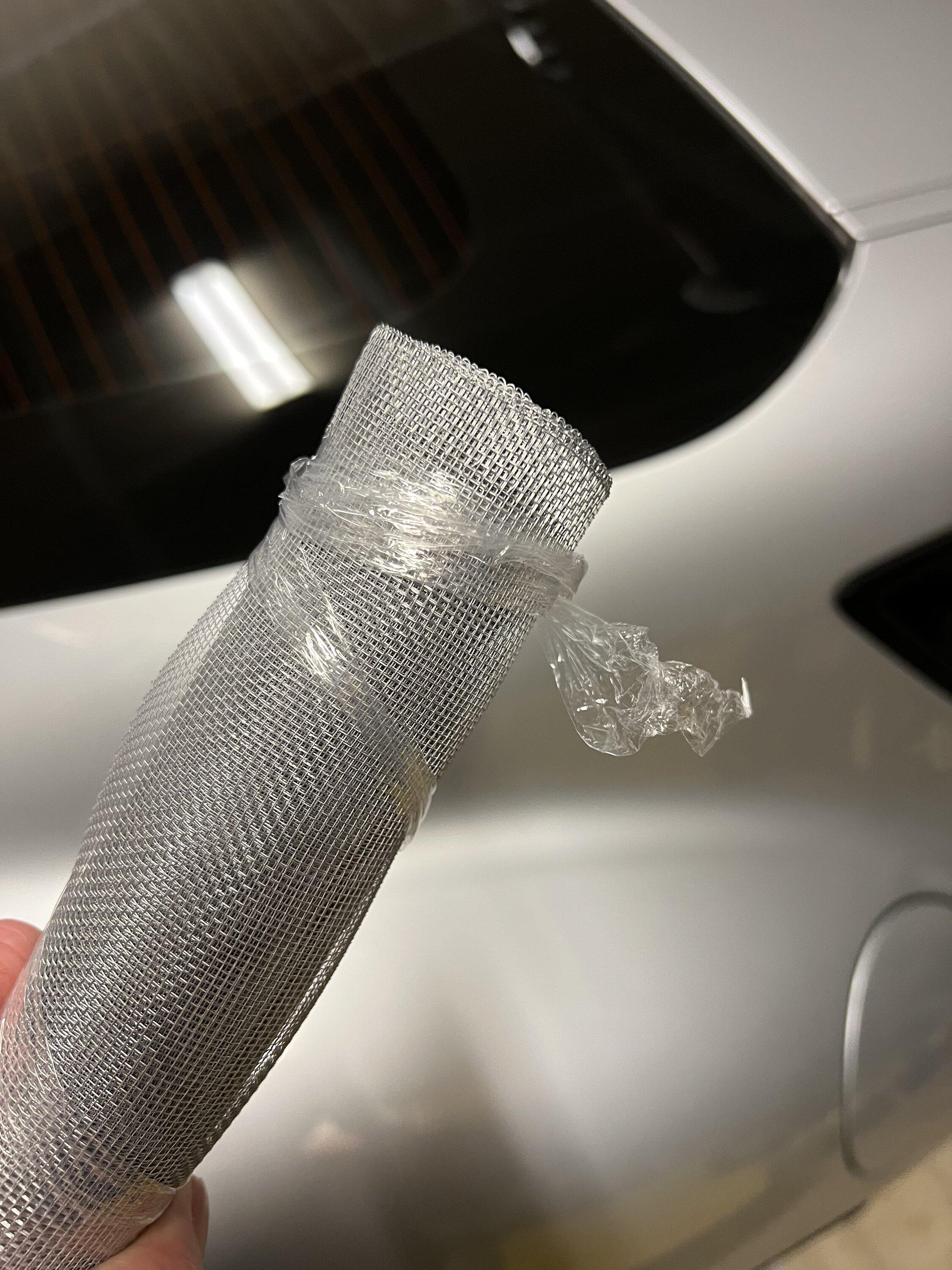

Hence the OP's mention of using a double mesh screen. With a fine mesh screen erosion will be an issue but FOD should be ok. Personally I wouldn't do it myself but if you're asking for opinions then you get both sides of the story.

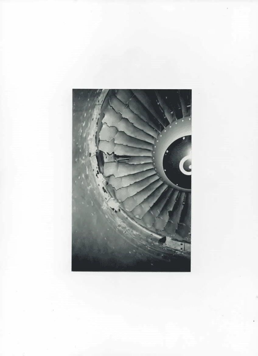

Not caused by a brake disk rock :lol:

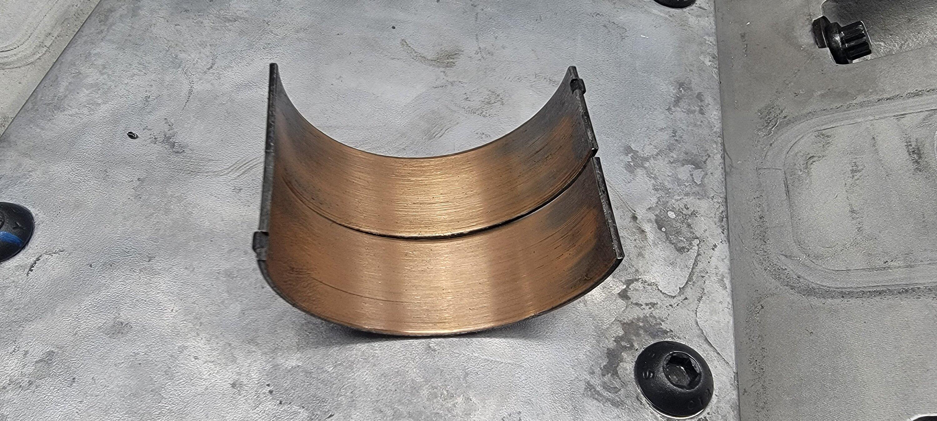

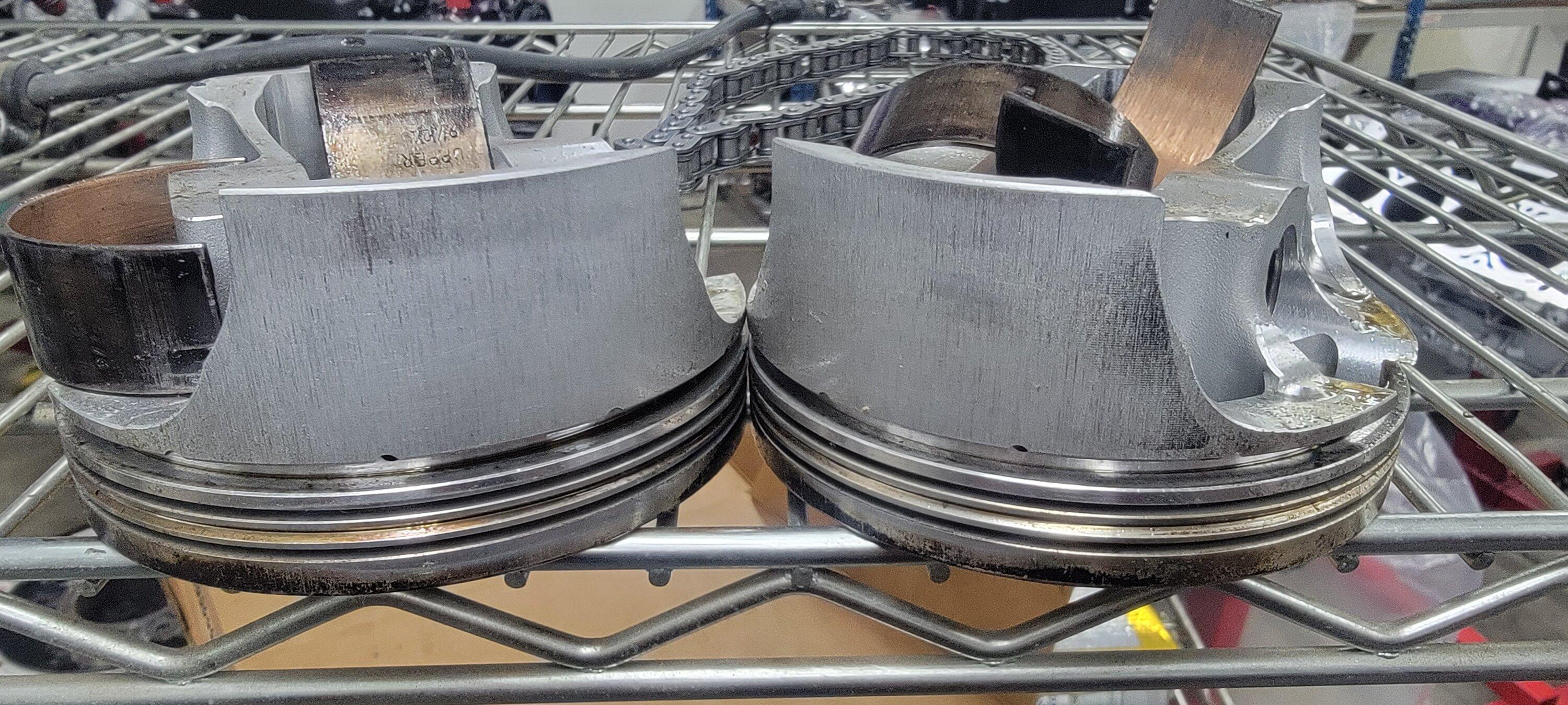

Here is a real life example for you guys. This is a bit exaggerated for street related usage but this is what happens when you run your vehicle in the dirt for 20 min with the wrong air filter. Was a brand new build before this.
Note - the skirts of the pistons were once fully coated. I dont have the turbos here to show you anymore but they were wasted. Again, this is after only 20 minutes!
Off road engine with disconnected filtering? Whats the details?

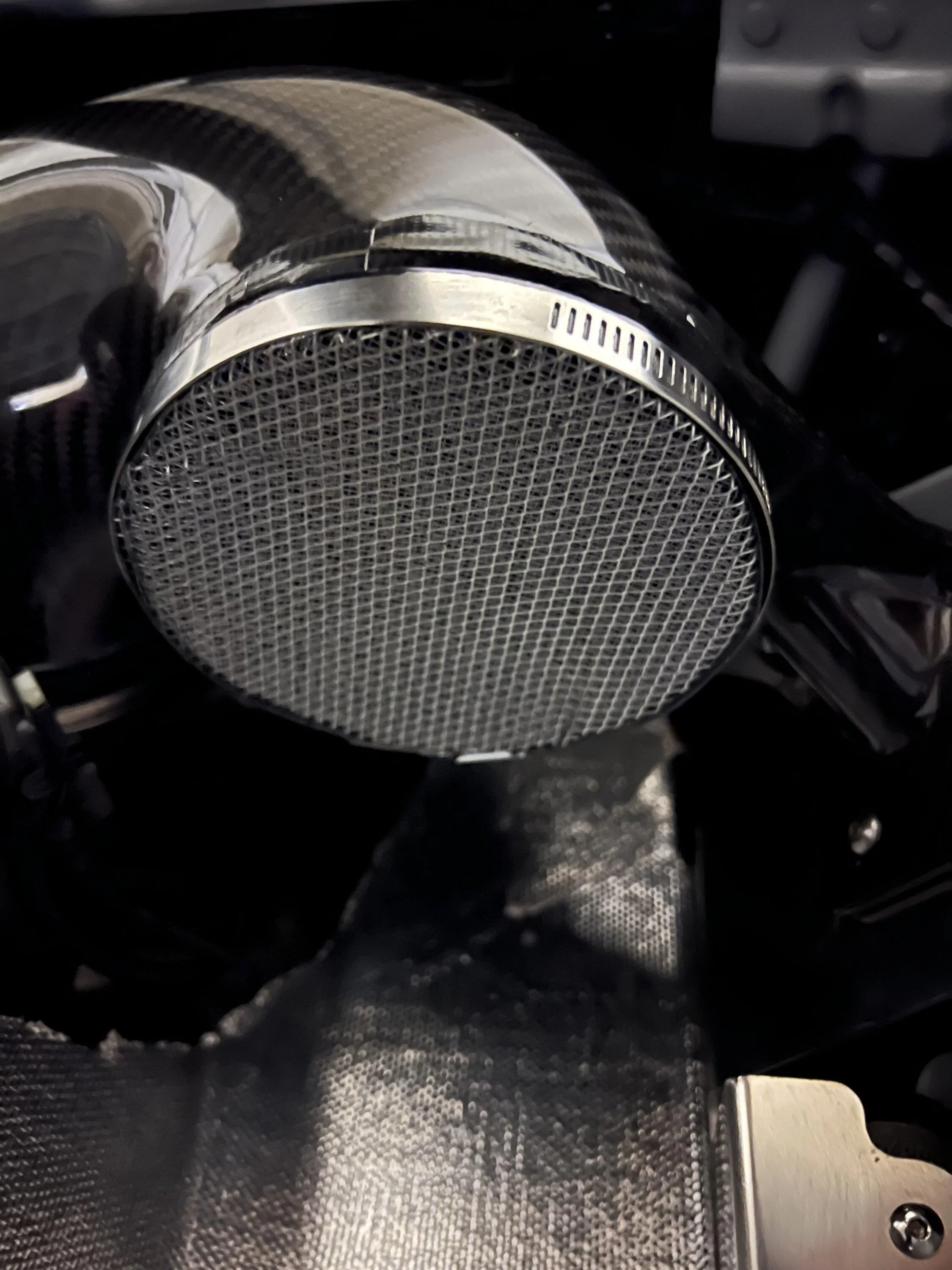

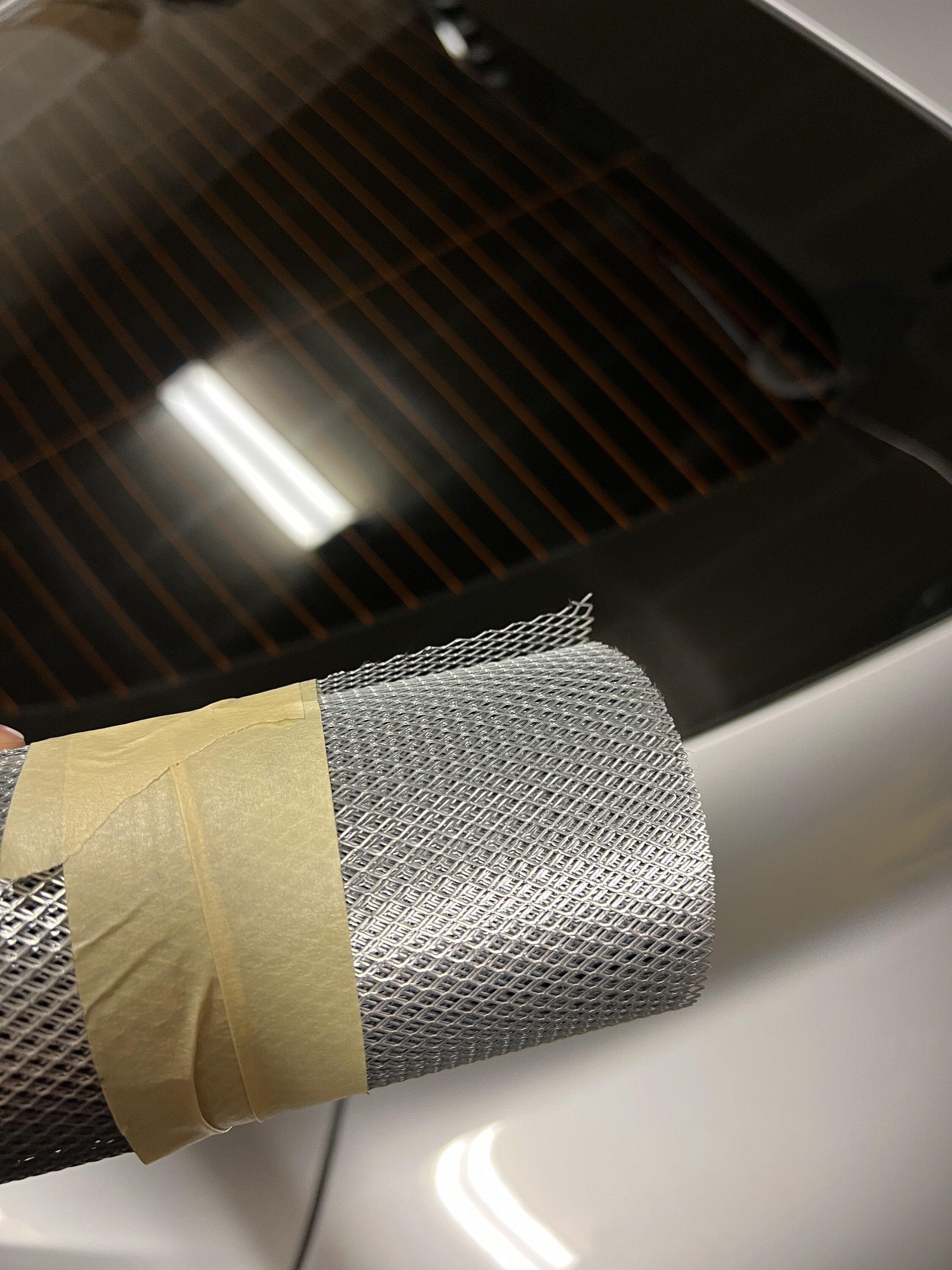

For real tho here’s a small update. It’s now 4 layers of wire mesh, 1st coarse steel mesh, 2 layers of fine aluminum mesh then a last layer of coarse steel mesh. I’m definitely not worried about sucking anything in, but in the case of catastrophic failure, well I guess I’ll start my journey to an 8 sec car, lol…
Phil
Old air filter that was not up to Off road duties. It might kinda work when new and freshly oiled but when old, all the fine particles get by. Turns your oil into liquid sandpaper. This is why we manufacture Off road specific air filters and recommend to replace yearly if used a lot.
this might be a bit exaggerated, but this could happen if you fart in your car when it’s too hot outside!
Exaggerated for a street car but still a real world outcome of what happens when things like dirt go through an engine.
So you made the equivalent of a boats flame arrestor.... notice the lack of reference to being a filter.... boats don't have to deal with dirt and dust.

@Evolution its not a filter my good friend…
Then why run it on a car!? Cars come from the factory with an air filter for a good reason!
