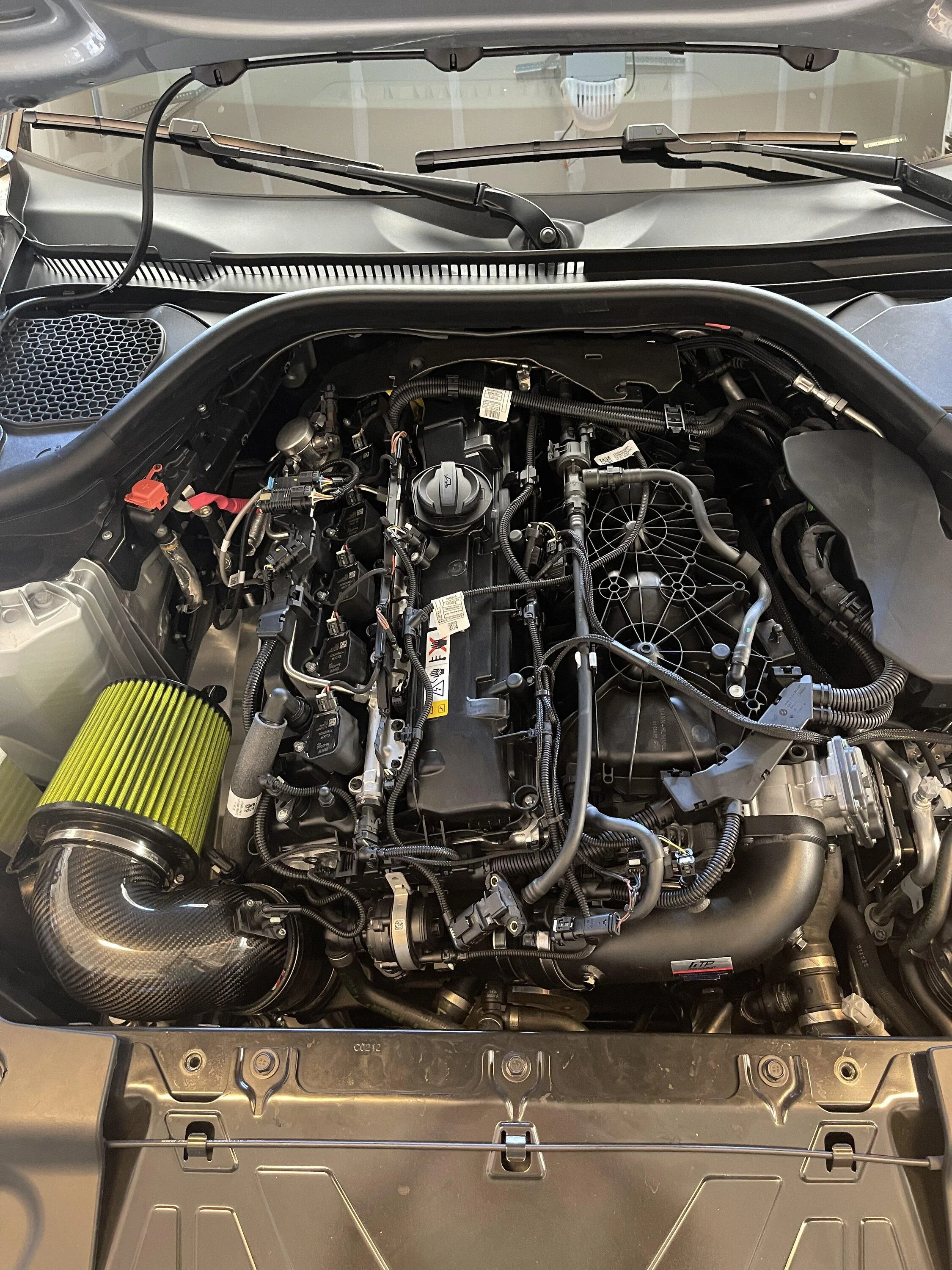

For real tho here’s a small update. It’s now 4 layers of wire mesh, 1st coarse steel mesh, 2 layers of fine aluminum mesh then a last layer of coarse steel mesh. I’m definitely not worried about sucking anything in, but in the case of catastrophic failure, well I guess I’ll start my journey to an 8 sec car, lol…
This might be ok temporarily but I'd recommend finding a way to pipe in an intake filter. Even if its a reducer or a 90 down or up to some other part of the car. Yes you'll lose some power but there are ways to gain that back.
Dust and dirt really do damage to an engine over time...Your oil filter is basically evidence of this. Neglect either and you may shorten your engine life.

I have the filter just changing things up…

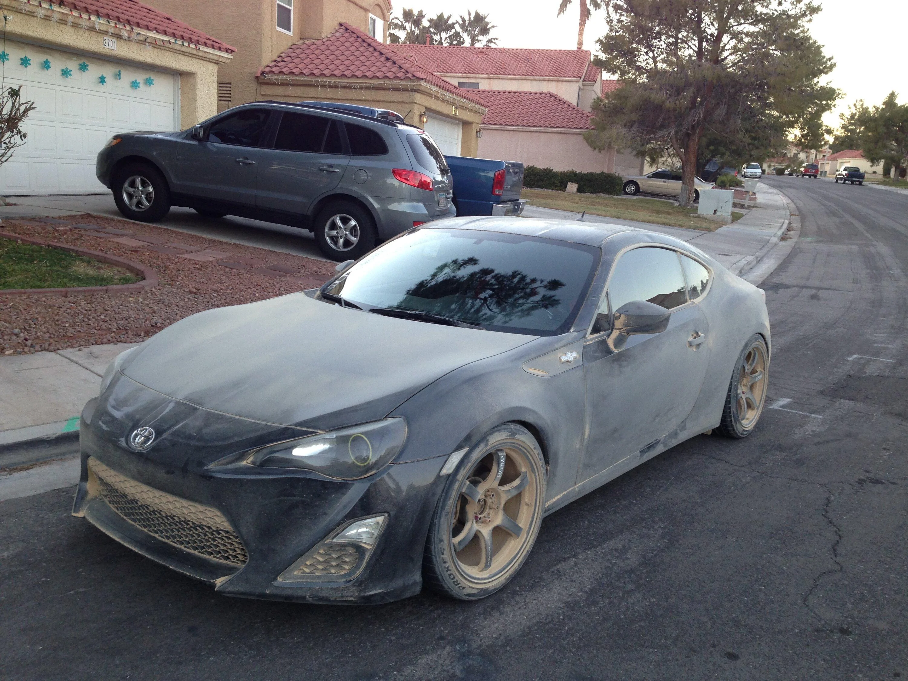

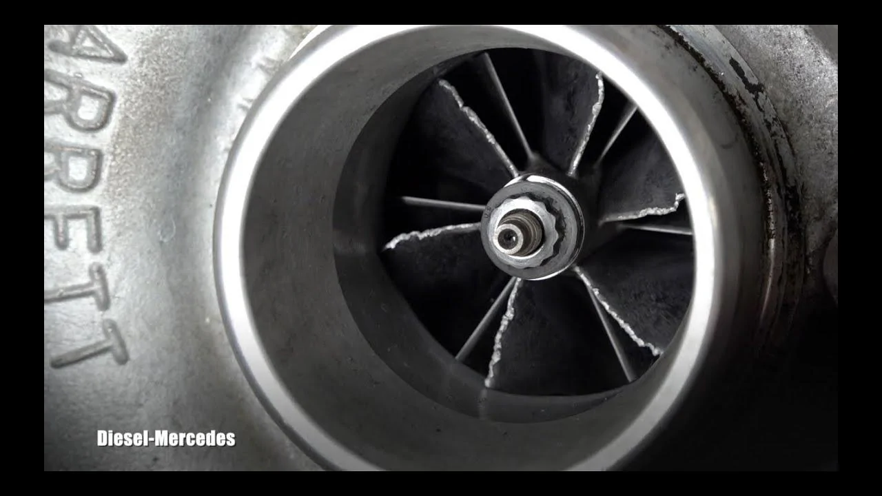

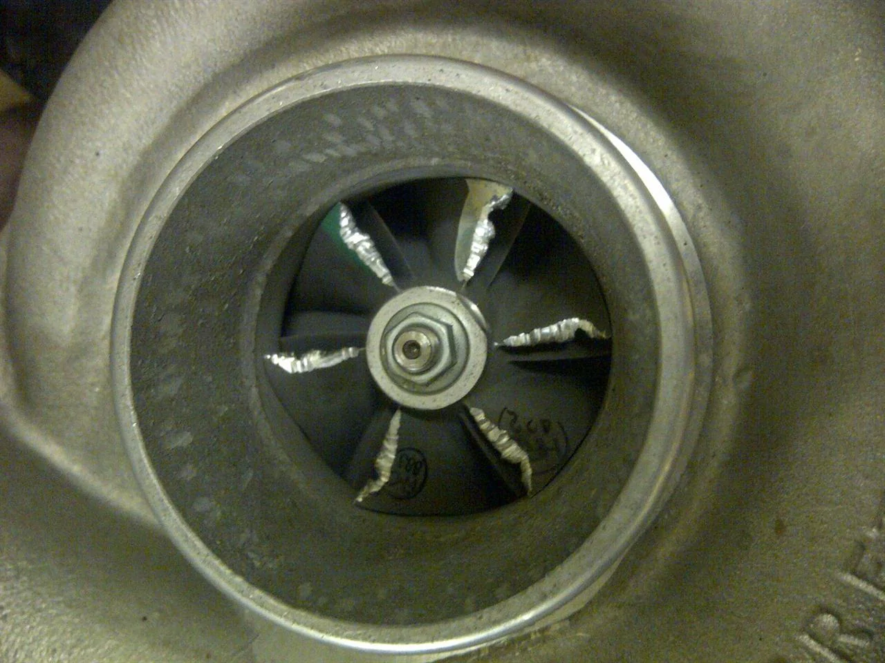

Living in the desert I’d never run without a filter. Long long time ago I thought it would be cool to take my FRS out to the dry lake beds, one of the WRX’s in the flat4lv group went also and had no filter. I’m not apart of that group and don’t want to go looking for a picture from 9 years ago, but on the way home he was stating how much power the car lost. After 4 hours or so of honing around on the lake bed with no filter his compressor wheel was just fucked. These are pictures I googled but his looked more worn out then these.
like one of the guys said these turbos spin tens of thousands of RPM, just little dust will wear blades out.
of course if you don’t care about how long things last, then it doesn’t matter.
