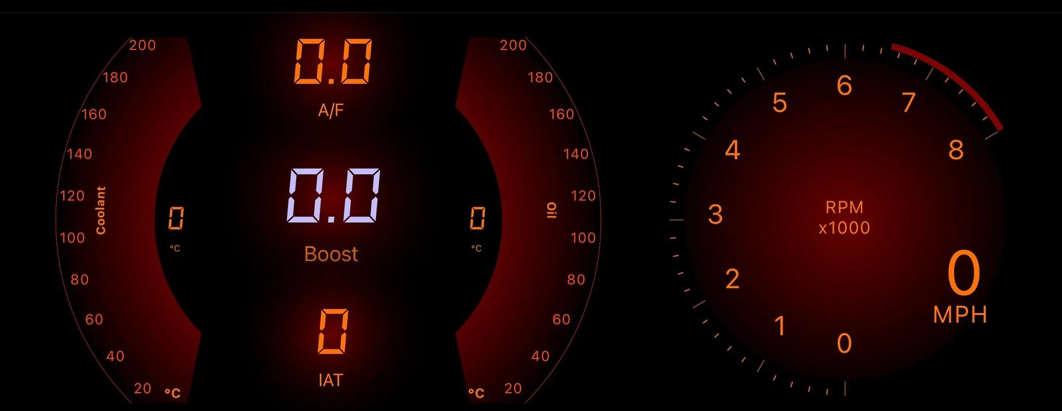

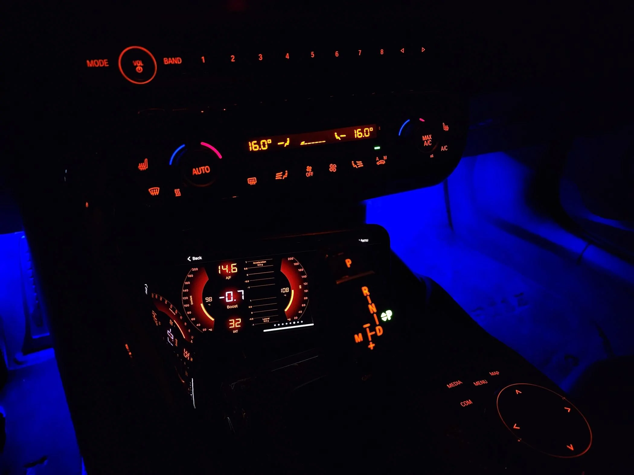

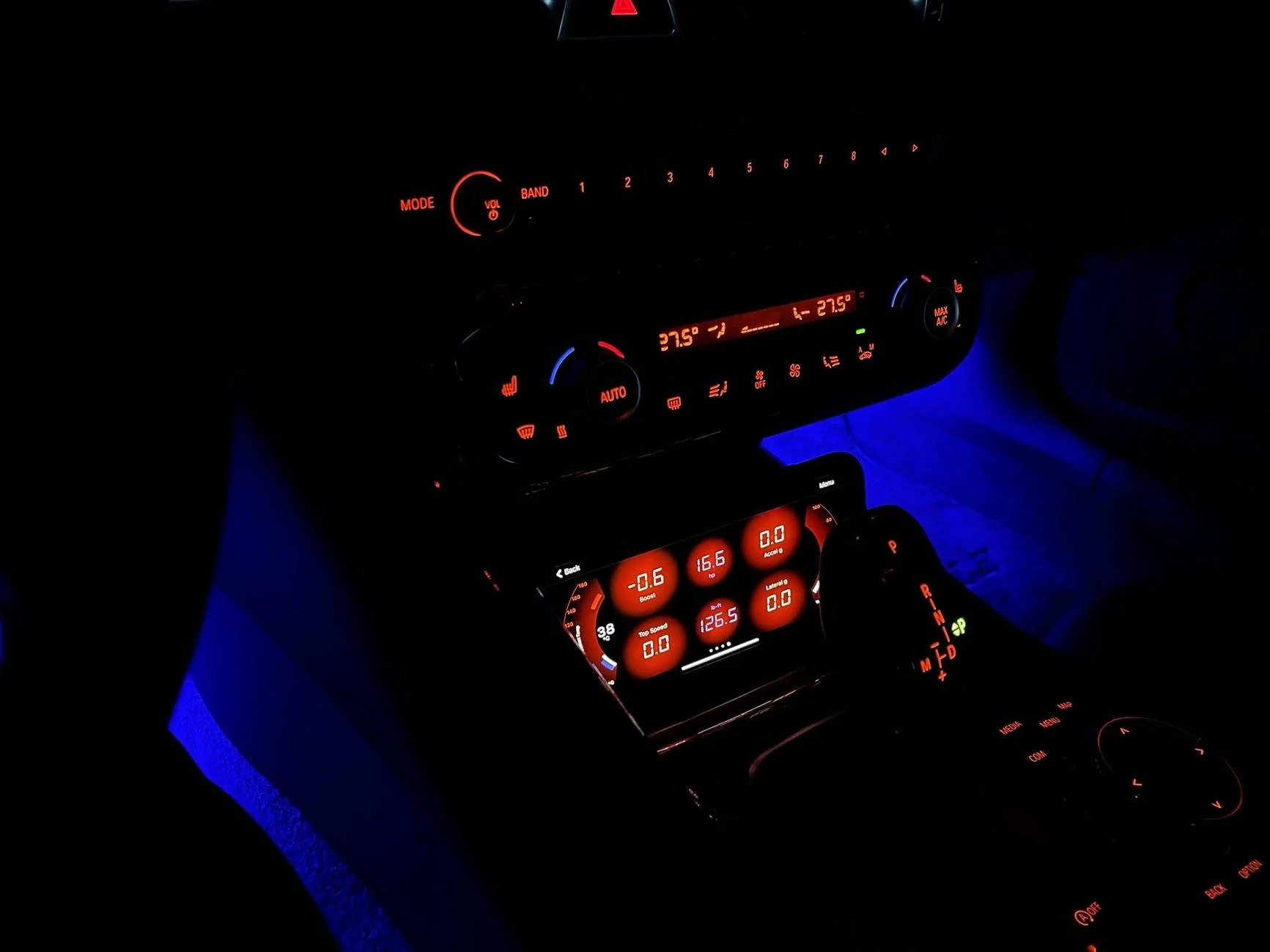

Thought I might as well update this thread for those who want to try this method of mounting their phone and displaying some further information while driving.
Here is a closer picture of the phone as it is mounted. The far right side of the screen is blocked by the shifter but there is still enough screen visible for a lot of easily visible information.
I have also updated my display. Maybe someone will find this useful. I moved most of the displays left so that I can see everything without the shifter blocking anything. I then put a speed/tach readout on the right so my son can see them easily while driving (these are blocked by the shifter so I can't see them). The colours match those of the temperature display fairly well.

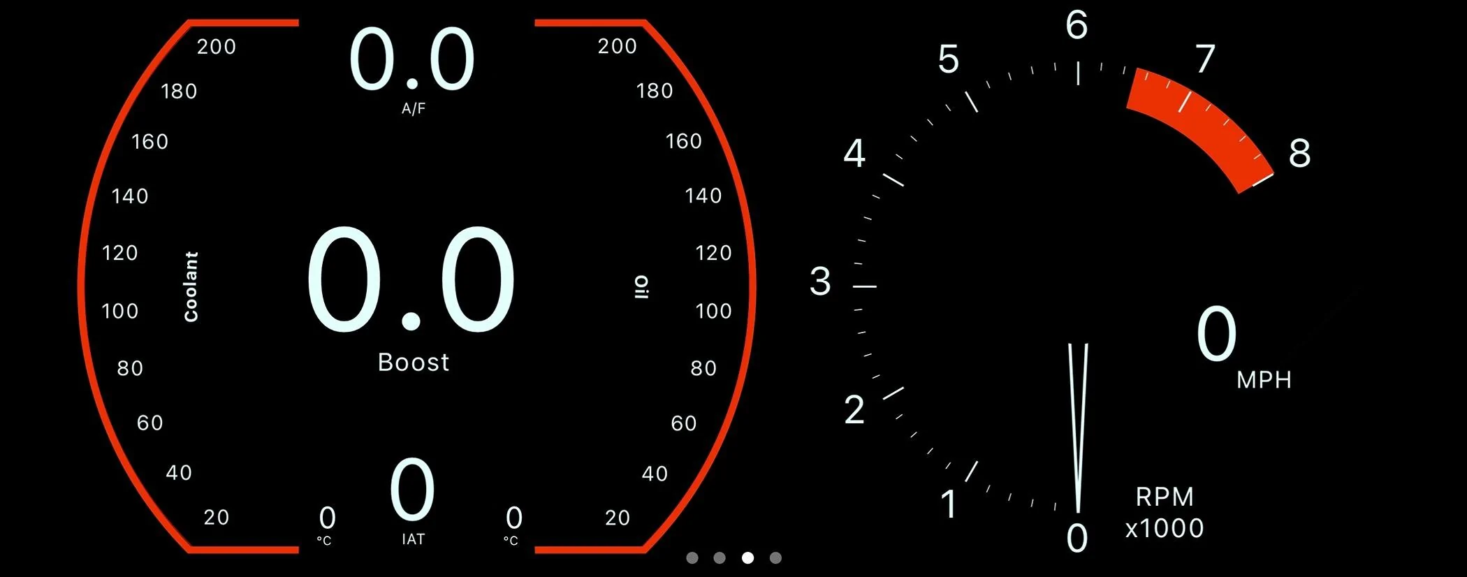

I also made a display that more closely resembles the gauges. It's obviously not a perfect match. It would be great if this app allowed us to use different fonts. If they ever update it to allow this, we could get pretty close.
Hope some of you find this helpful!

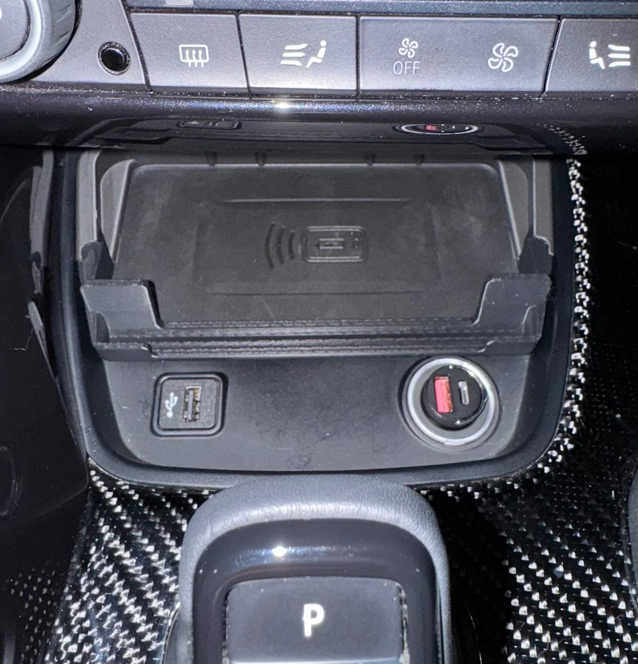

To mount my phone I used this Scosche magnetic mount. It mounts to the cover above the wireless charger and holds the phone securely with no vibrations or rattles (note I'm using an iPhone 11 Pro Max with a case).
I hope this was helpful! Good luck and I would love to see what kinds of "dashboards" anyone may create with this app!
Thank you for starting this thread and all the information.
I updated my version of the dashboard with your settings and it looks fantastic!
I had an idea and a super smart friend who made this 3d printed tray extension to another tray from another thread which allows the phone to be placed sideways.
Hope you all like it:
https://www.supramkv.com/threads/replacement-wireless-charger-tray-3d-printed.16126/post-402901
