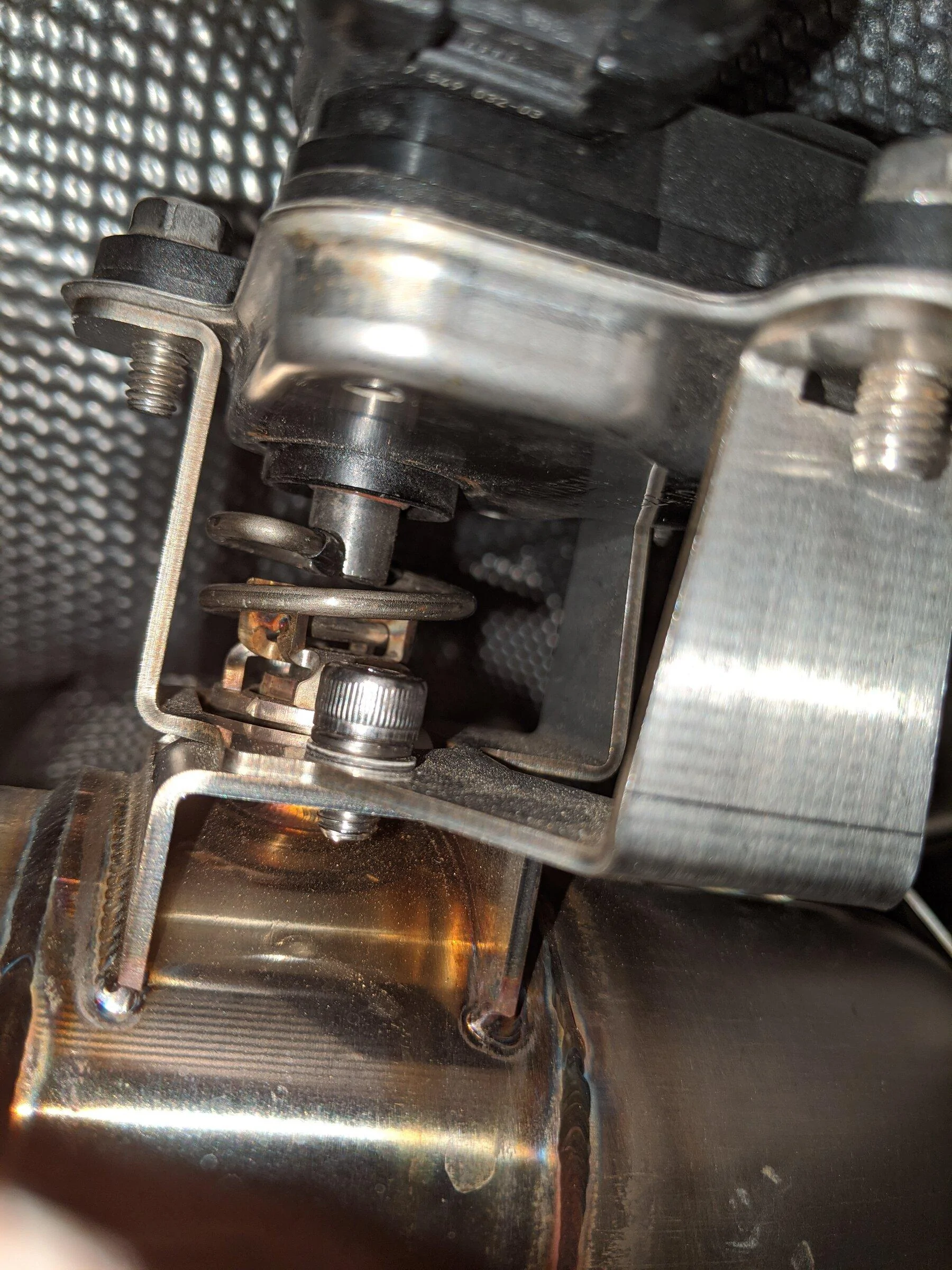

I have an APEXi catback, and on cold start I get a slight rattle from the valve. This catback uses its own type of spring/clip that mates with the actuator, the end on the exhaust side is welded, so it is not removeable. I tried stretching out the spring a little bit to try and provide more spring force with the actuator attached, and it actually did fix it for a day or two, but now it's back again. I'm trying to think of a way to compress the spring instead for that extra force..

I have the APEXi resonated, and I also have the rattling valve issue. It's quite annoying. I eventually installed the valve in the open position, and just let it hold the valve open all the time, until I can figure something else out.

It's a bummer since I specifically wanted to have the valve option for quieter moments. Though, I tried playing with the clip again and it's been over a week now with decent results.
I used light force to bend the clip counter-clockwise (toward the closed position). Then I wrapped a couple layers of electrical tape on the end that mates with the actuator to give it a little more thickness. Also made sure to hand tighten the three bolts with a good amount torque without overdoing it.
Now, I hear a little rattling on cold start when the engine starts at ~1300 RPM. Then when it goes down to 1000 RPM, I can't hear any rattling unless I literally stick my ear next to the valve, and even then it's very slight. Once idle drops completely there's no rattling. And when it's warmed up a bit more, I can't say I hear any rattling at low RPMs with valve closed.

I should also update on my previous posts. The rattling came back and I just gave up ? it doesn't seem as bad as it was initially. Maybe because I just got used to it.
