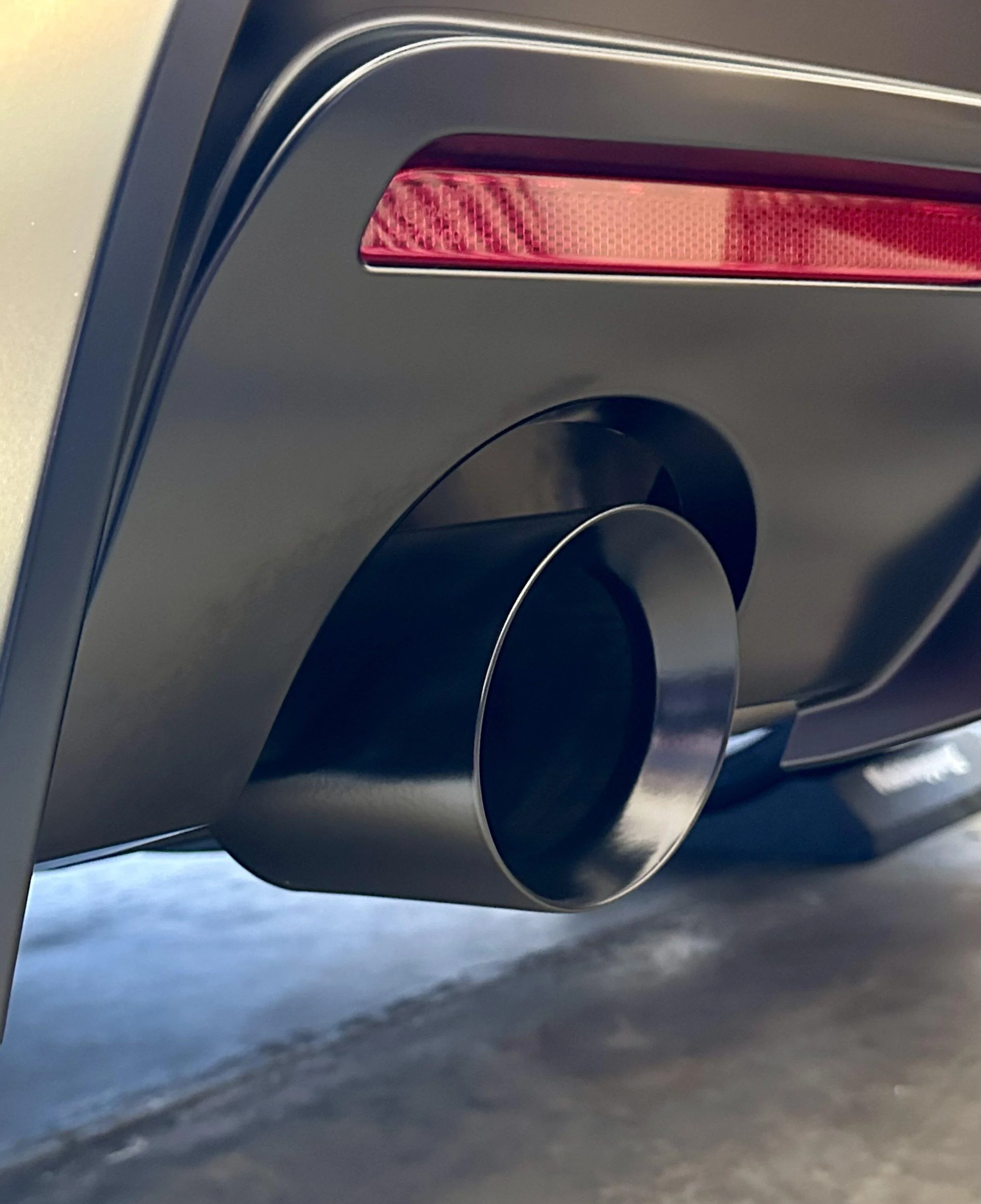

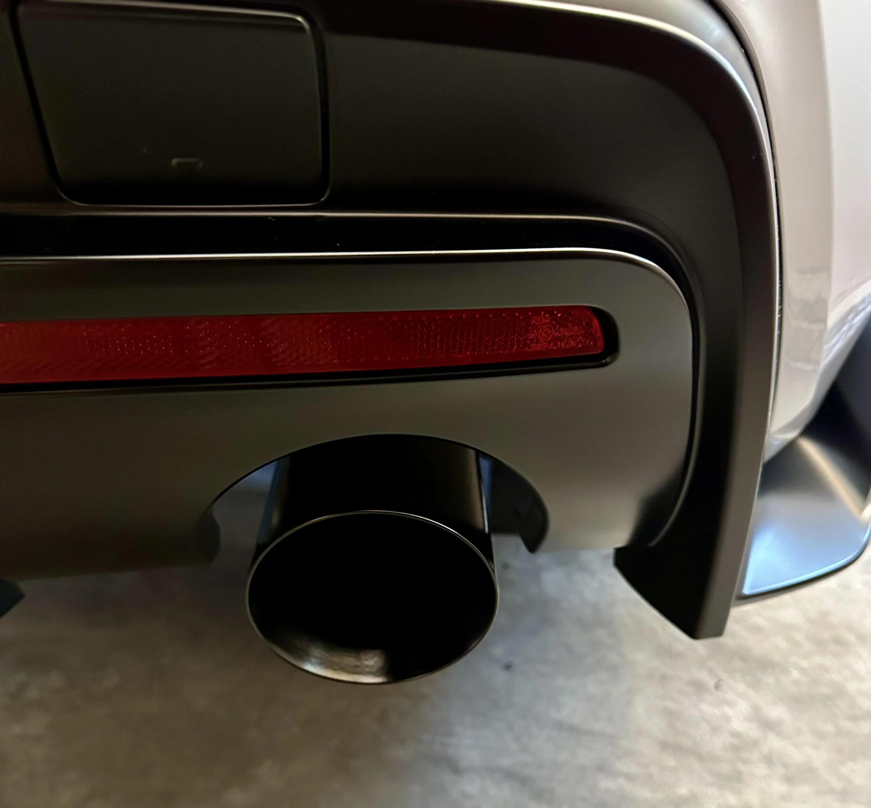

Opted for powder coating the stock oem tips.... prep and product used is key for these.
