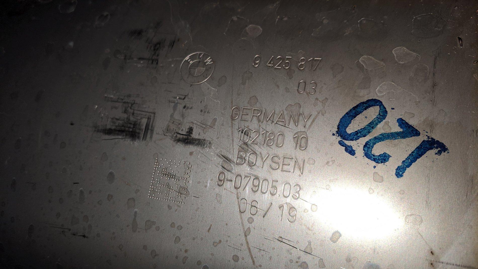

This is a picture from my US Supra. Let me know if you need any more info.

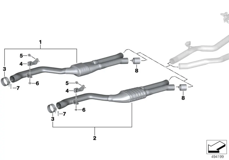

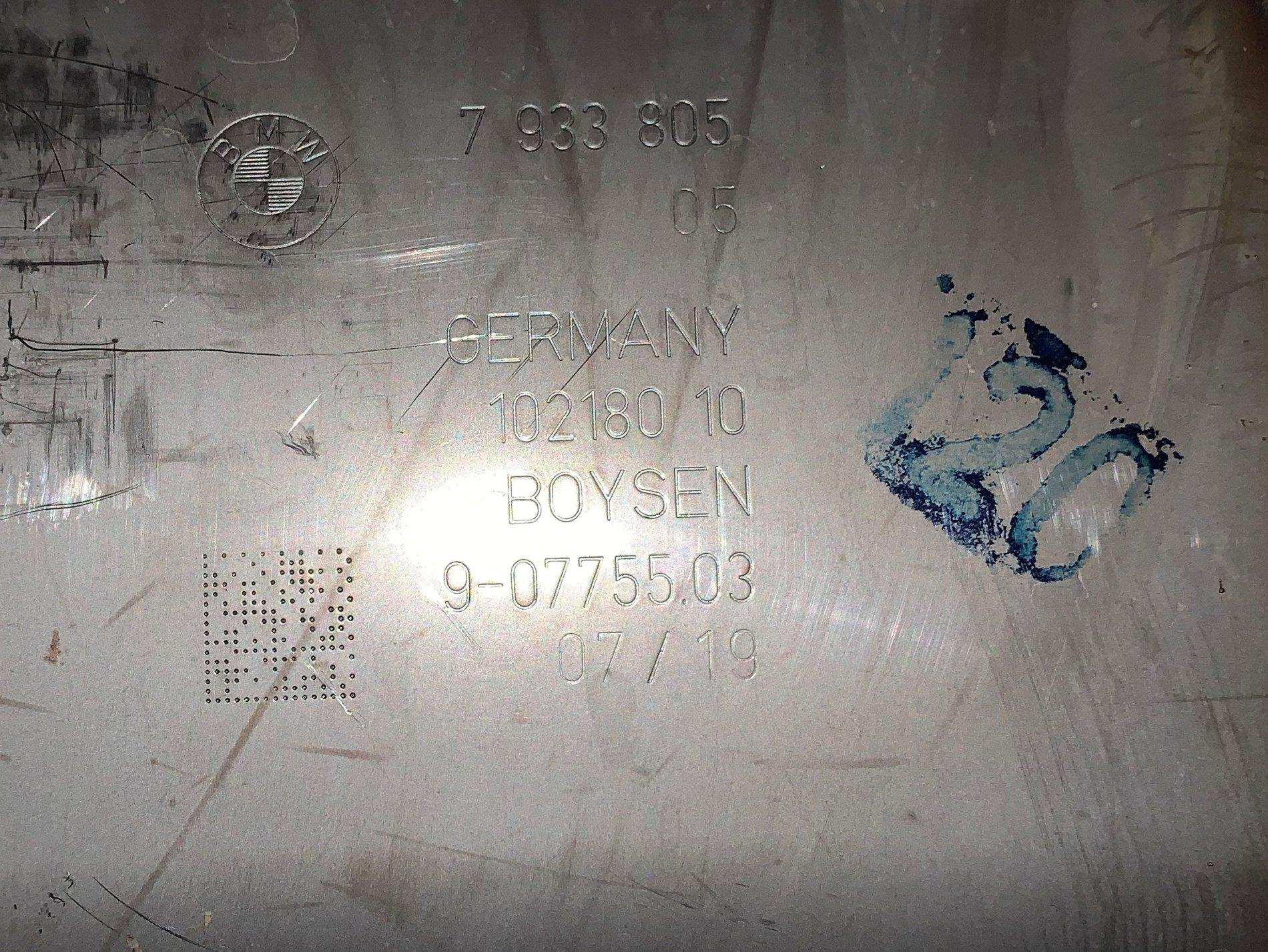

Fantastic, thanks so much.
So it appears that the US does have a different rear muffler to the rest of the world.
So, it would appear the market configuration is as follows:
EU:
Rear muffler: 7 933 805 04
Centre section: (1) in below
V-band downpipe
GPF
"quiet"
AU:
Centre section: (2) in below
Ribbon Clamp downpipe
No GPF
"medium"
US:
Rear muffler: 9 425 817 03
No GPF
"loud"
I wonder what Japan got?

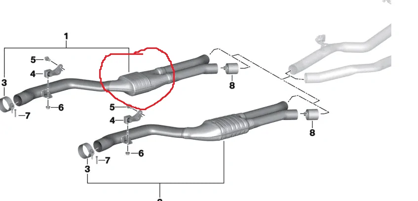

This part (circled red)?
I had it on my C63 and it sounded factory until WOT, then it was a fantastic roar... Was hoping for a similar effect with the A90

No that’s the GPF. That is monitored by a pressure sensor. If you remove it, that is an MOT fail, error code, and possible CEL / limp mode.
I cut downstream, after that, and temporarily removed the whole rear section to the tips including the transverse muffler.
