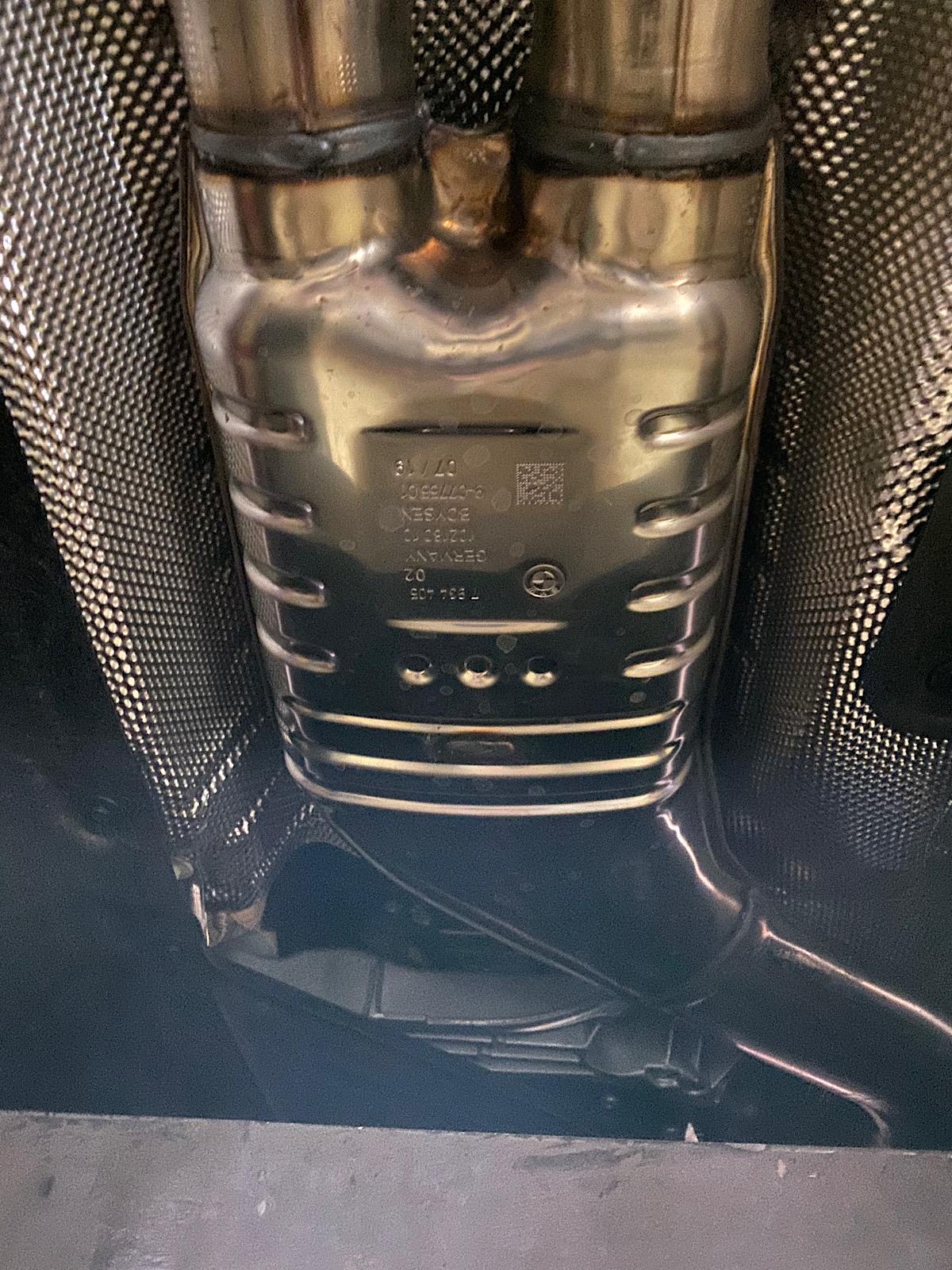

I’d like to bring this thread back up since I have a question on how to spot cars with or without the GPF. My Supra is supposed to be an Asia Pacific spec car but upon VIN lookup it showed the car as EU spec. So I’m wondering if my car is actually equipped with GPF or without one. The muffler part number is similar to EU and AU spec cars. The downpipe I think has ribbon type clamp, but I’m not so sure if that means the car has no GPF.

If your resonator looks like this
Its without GPF

That's correct.
The GPF also has a sensor that has a vaccum line near the dump pipe/turbo
Have a look in your engine bay, near the rear of the turbo. No vacuum line? No GPF

So, there’s no GPF for the RHD version selling in Asia pacific but we do have to same muffler as EU cars.

Exactly correct - just the muffler part, just like the video.
As to whether it's too loud, that's highly subjective. I found it fine, but didn't drive it at speed. Another person may think ridiculously loud, another may think quiet. It's not as loud as the US decat cars. The pops and bangs are there but muffled, not like gunfire on the US.
It's a quick and easy item to test and its wholly reversible with the clamps.
The part no is 18.30.7.560.780 70mm clamps. - ~£30 each, you need 2.
