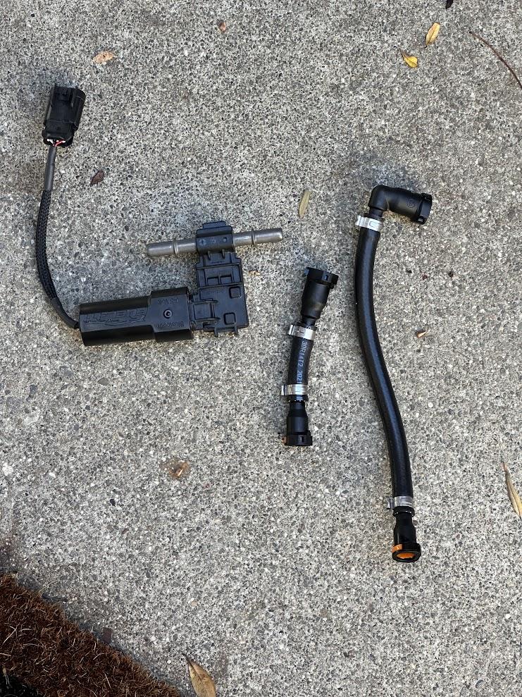

The lines near the clamps are leaking
Wait, what? The braided lines leak? Fuel It doesn't warranty the lines at all? I presume they come preassembled, so any defect should be on them. Is this a used kit you are trying to install? Or did you install new and drive around for some miles -- if so, how many? That's an expensive kit that you'd presume quality for the price.

I bought the kit used for a decent price. I asked Fuel-it if there is a warranty for them they said no since they dont make it with those type of fuel lines anymore. I would have to upgrade to the stainless braided lines.
I went the 360 fittings route for a less priced but better alternative since I'll be able to utilize the OEM fuel line.

no since they don't make it with those type of fuel lines anymore.
Ok, so at least they stand behind their product. Used and older versions understood. Good gosh, the idea of dropping almost $500 on a product that seeps fuel into the engine compartment would burn me up (pardon the pun).

If I knew this version leaked I would of just bought the upgraded version...luckily I didn't need to start the car to notice the leak.

Yeah for sure, I've never done any mods like this and all ive smelled all day today was fuel. I refuse to start the car in fear of starting a fire! I'll have to wait until I get the fittings to feel any reassurance I"m doing this right!
How long have you had your Fuel-it on the vehicle? I've had mine installed for a little over two years and my fuel lines look brand new, never had any issues with leaking, "YET"....
Got it used and never got to use it. Are you on the old fuel lines too?

I believe so because my lines definitely aren't stainless-braided. Those lines look like someone installed something incorrectly to me.
