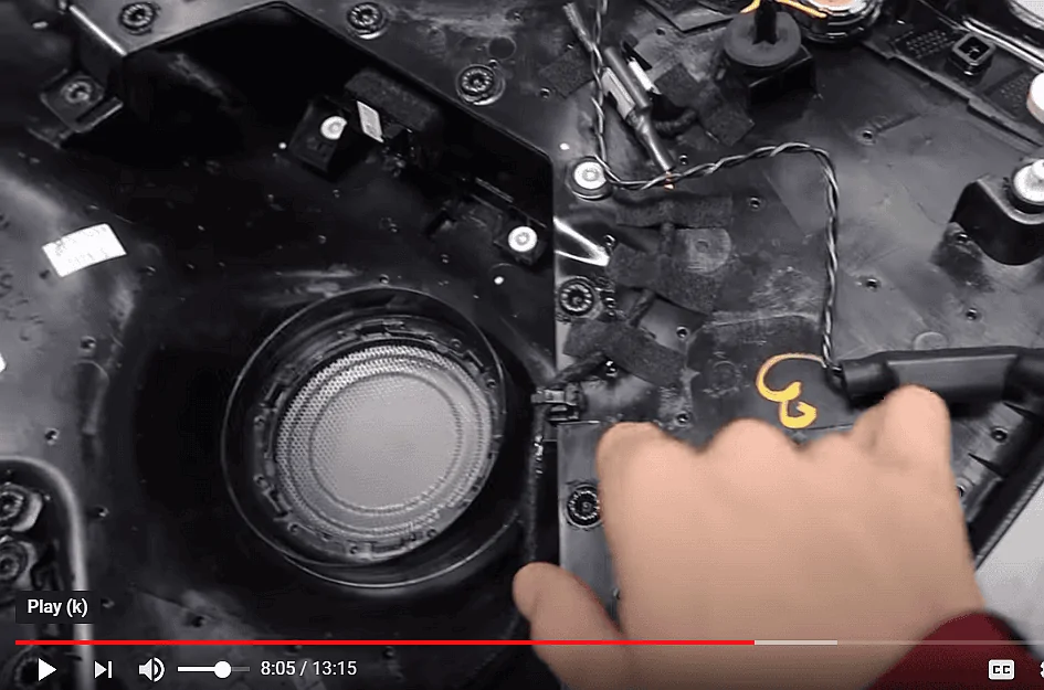

Here is what the door space looks like covering the mid speaker..yikes!

Noico is typically applied over thin layered (CLD) i.e dynamat for additional damping and noise suppression...
With the sub improvement project I used the Noico foam backed adhesive to suppress / isolate noise and fill gaps...I also used dynamat to cover the floor of the rear trunk space....
I intend on using both dynamat and Noico (as an overlay) for the doors...
Sounds good i will check with just some dynamat first and then if i need to improve the layers i will go buy some Noico. I was actually going to go back over the sub project and where the exhaust ports were i was going to line the metal with Dynamat as well, but may not be needed or a bit overkill
Which video is this? i would love to see this in more detail as it would allow me to figure out where to put material
The speakers do sit flush against the waveguide as they have a foam seat, so it could be much worse. It stops it from being a complete echo chamber.
With that said, I have applied some CLD there for stiffness and will fill the door with Thinsulate.

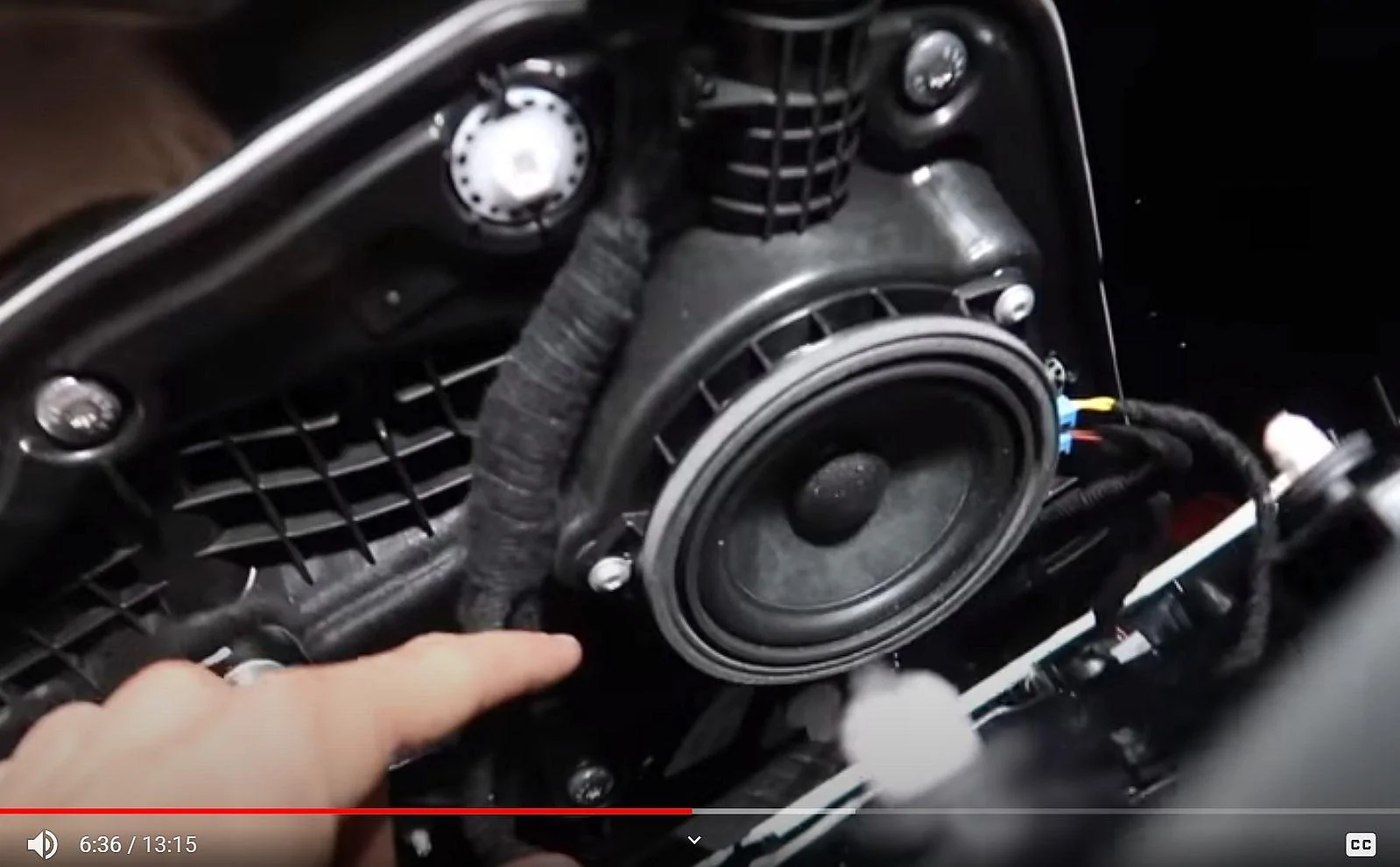

Yeah, the door vibrations around that mid area are terrible! I plan on applying both CLD and foam around that entire area as I've found (as you probably have) that the plastic area around the mids, particularly that thin wall, vibrates like hell during lower midrange passages...
