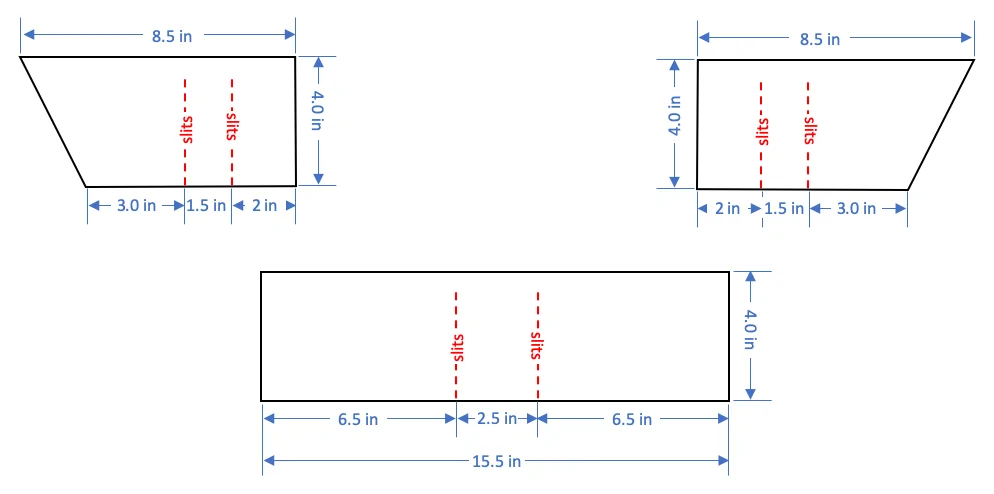

Thanks for the correction. In my defense, it was very late when I made the drawings ... lol
@tadda here you go
Thanks!
I updated my original post with corrected drawing...

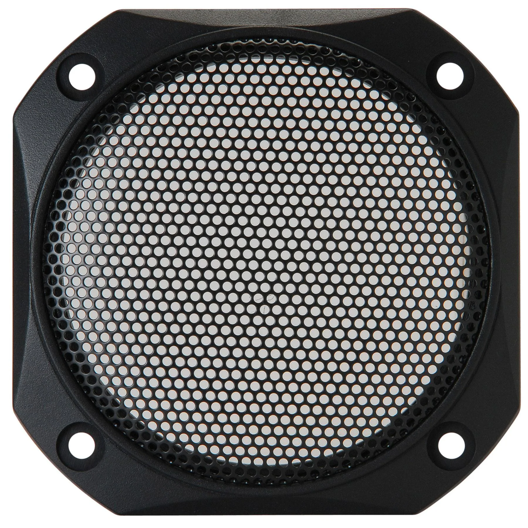

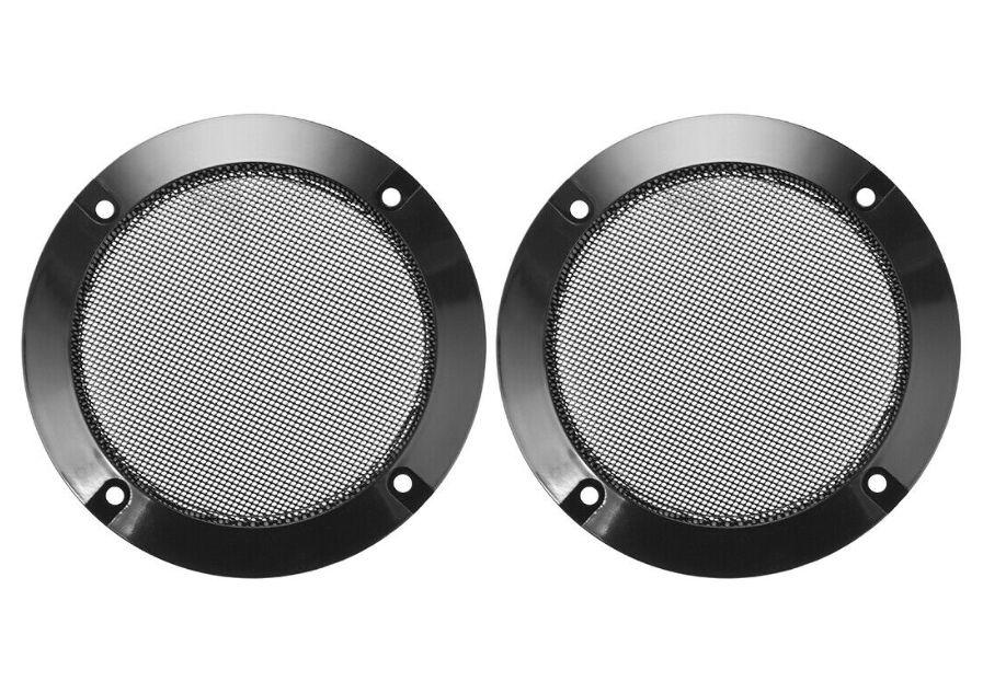

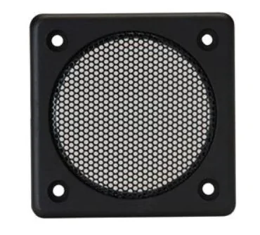

Here are other options I also considered (replacing the 2" ports) which would secure to the narrow rear panel....
2" square grill cover
2" round grill cover
As I mentioned earlier there is also another alternative to adding a port and that would be to simply cover the rear cover panel 2" exhaust holes with a grill cover as shown above...This will also eliminate the need to cover the 3 elongated exhaust posts with mesh covering...
Those that already have installed the 2" ports can always replace them with a grill cover...

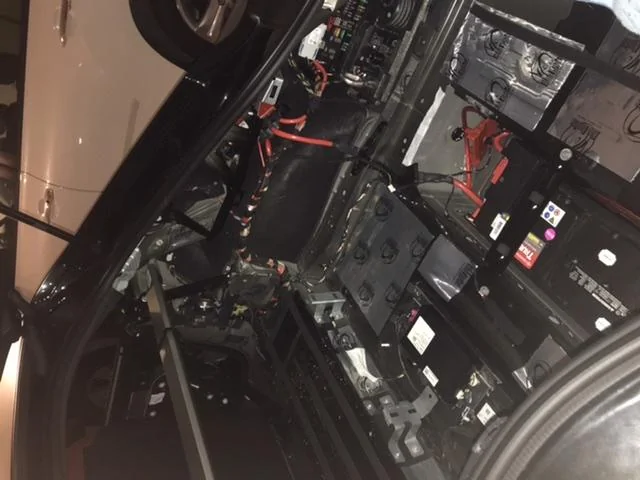

Some additional improvement tips (update added to original post):
For those that have completed this project, which involved lining the walls of the speaker enclosures, placing foam insulation between enclosure and narrow rear panel, and adding exhaust ports, I've also identified that there is one final area that needs to be addressed....
I discovered this after implementing all these other improvements, thus allowing me to significantly increase volume along with raising bass EQ settings...What I found was that there was some exhaust port energy escaping from under the long narrow rear panel (which as I show in a few pics below) causing the rear floor panel cover to vibrate...Keep in mind that this is yet another design problem which causes the floor panel cover to vibrate where in-turn this vibrational energy is transferred to the cargo areas' side and back panels causing them to vibrate as well...
The solution here was to apply some adhesive back foam to the areas show below which eliminated any energy transfer under the rear floor panel cover...
Shown below, I first applied 1.5"d x 4" L x 0.25" h adhesive backed foam strips above and below both exhaust ports
to isolate them further from the top cover and floor....

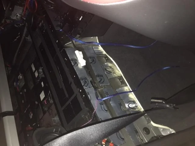

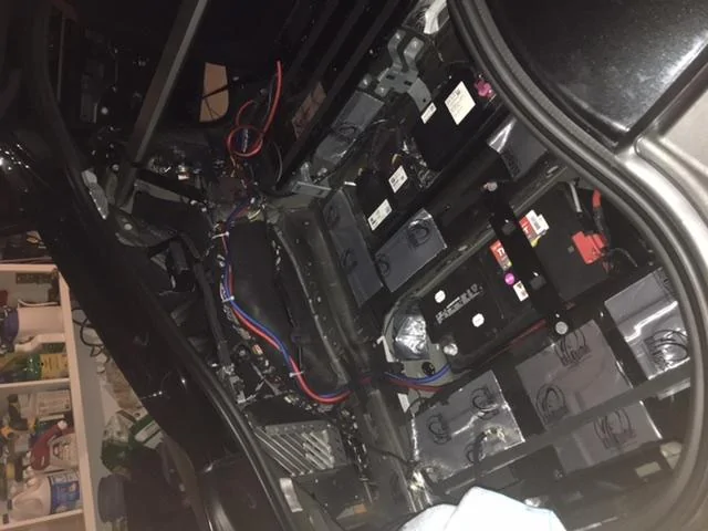

Next, the image below shows where some exhaust energy from the 3 elongated ports was also being released under the large rear floor panel cover causing it to vibrate greatly...With the floor panel removed simply place your hand under the narrow panel and you'll see / feel the exposed gap ...
Below shows locations where 2 adhesive back foam strips were applied to underside of exposed narrow rear panel ...The left adhesive backed foam strip was 1.5"D x 11" L x 0.25" H and the right foam strip is 1.5"D x 6" L x 0.25" H...This essentially sealed off the gap where the exhaust energy was also being channeled...
As a result the large rear floor panel cover vibration has pretty much been eliminated and side and rear trunk panels no longer vibrate during low bass / high volume music passages....
