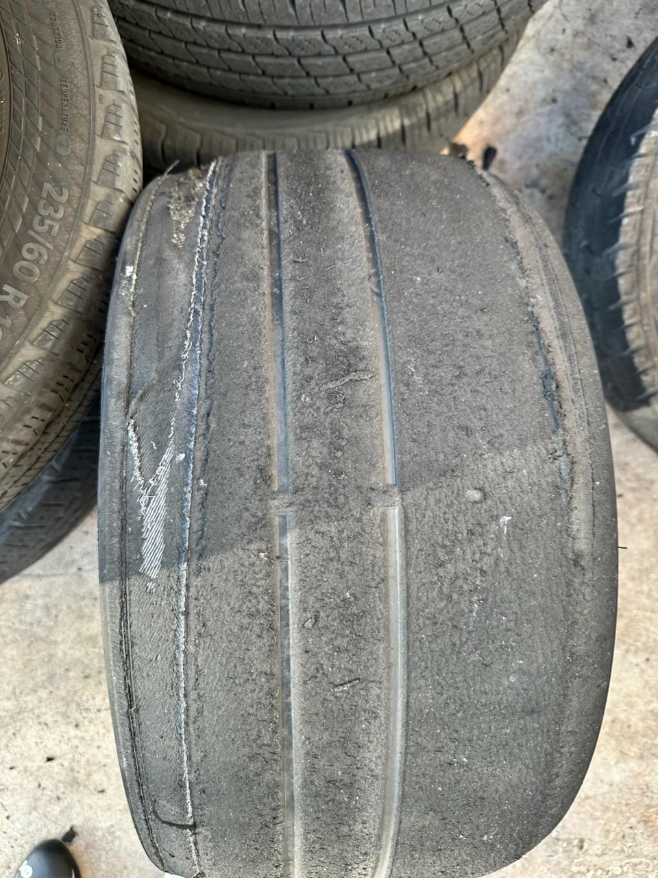

Just a quick mention for anyone doing a lot of tracking. Under high speeds and compression these springs may be too low (or perhaps soft). I’m getting tire rub & therefore switching to Ohlins coilovers. Just wanted y’all to be aware - if your intent is to do lots of track days. Also, I’m on 275/35-18 tires. Great size for different brands, compounds and ability to rotate. But it does contribute to a lower profile.
No hating on Eibach by any means. I have their sway bars and love em. These springs would be great at canyon carving, for looks or maybe even okay on track with the stock wheels ✌?

Are you running wheel spacers too? Where exactly is it rubbing on the fender liner in the wheel well?
Yessir. 10mm spacers all around for a different issue. The plastic wheel well cover and hood was rubbing the tires under high speed compression.
I should have known better and really high speed sweeping turns on track did me in. This won’t affect (or is it effect lol) most people. It looked really cool being that low. Gotta admit.
So now I’m on Ohlins. The added space looks weird now, lol. But it feels great! Driving over to Homestead today and will be testing/playing with her all weekend.
