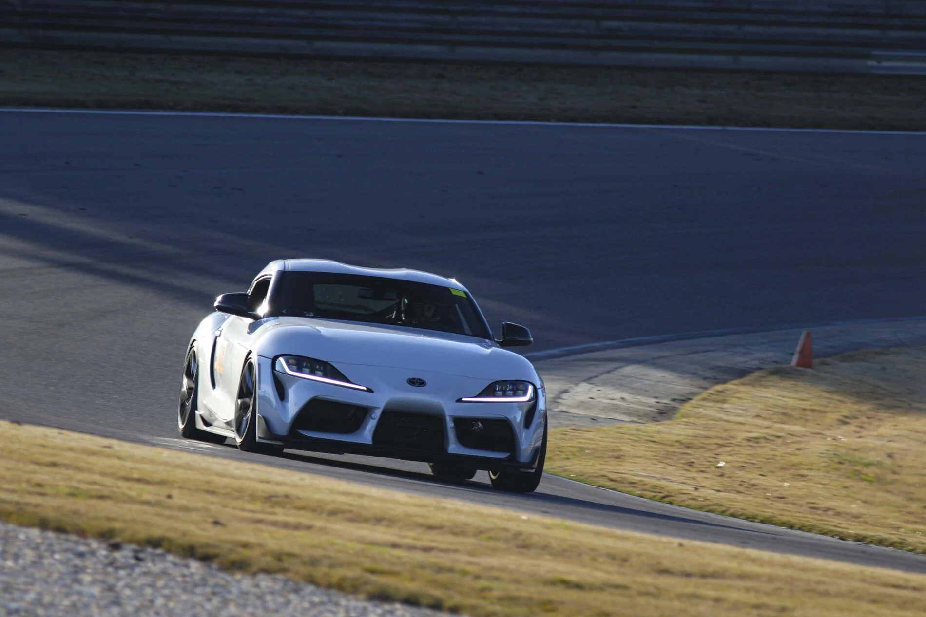

I agree with everyone else about the ride quality not being compromised. It also seemed to make it more planted, or maybe that was attributed to the extra width in track I gained when I added spacers.
I can’t tell if it reduced body roll over stock because there’s still plenty of roll after the install. You can really see it in this picture from my recent track weekend:
