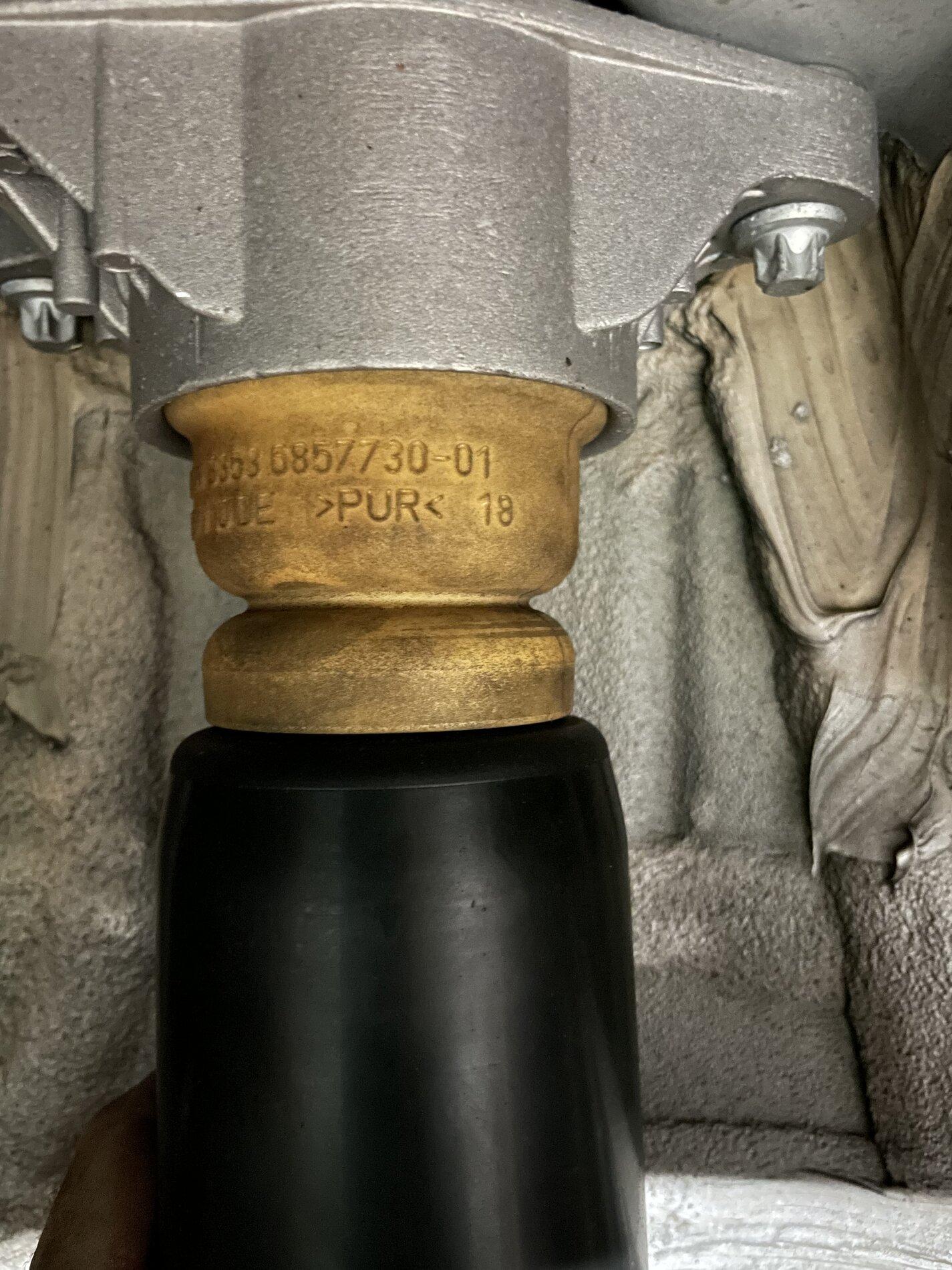

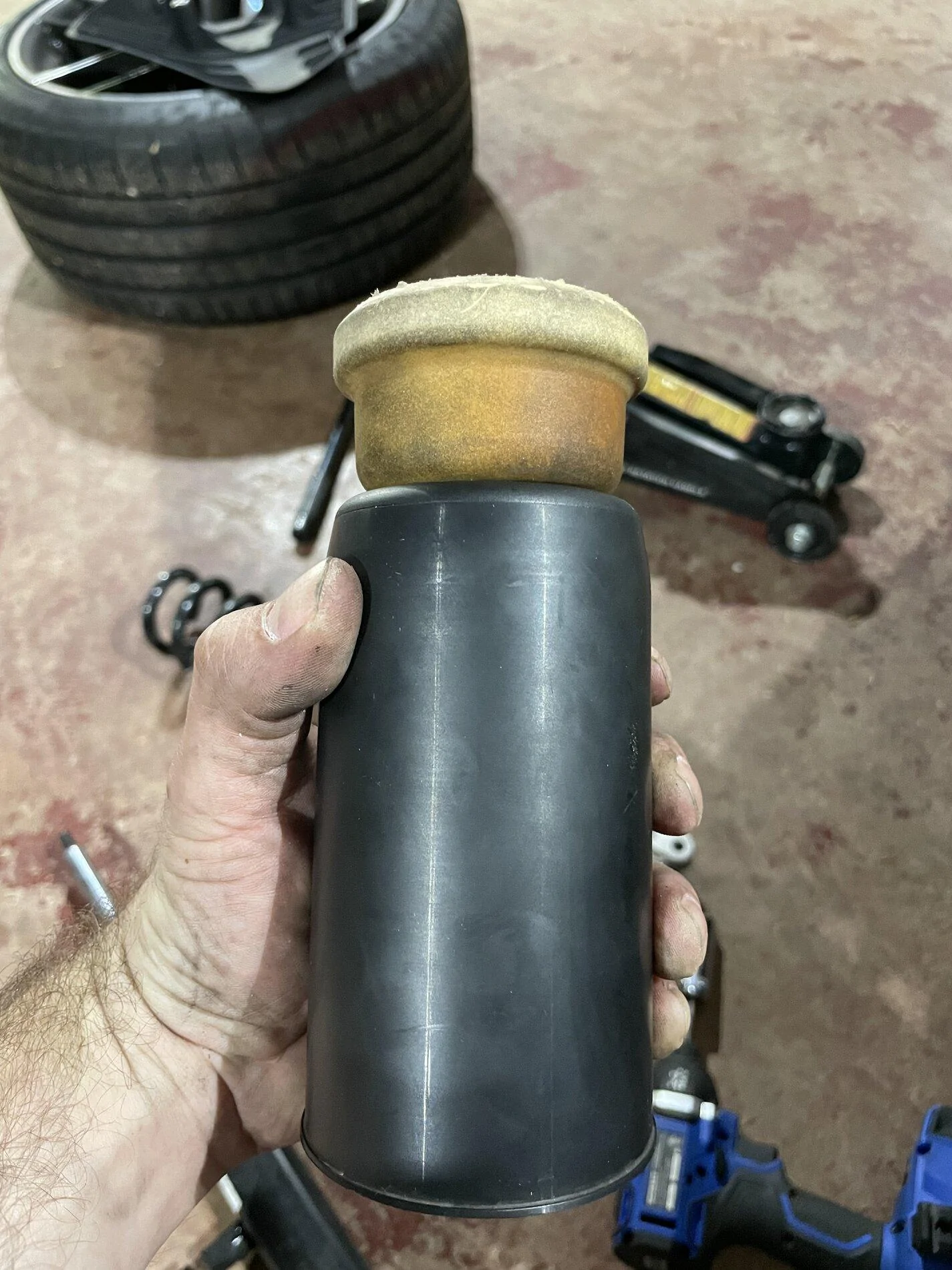

When you guys trimmed the rear bump stop that has the dust boot pressed onto it, what did you do to keep the boot from falling down after you trimmed the last section of the bump stop?
Sounds like I did something different from Andrews……I trimmed mine from the top on these rear bump stops because I didn’t want an issue with what’s going to hold the boot in place. If you pull the bump stop out of that metal piece it sits in, you’ll see the section I trimmed off. It worked perfectly for me.

When I dropped the strut and pulled off the boot and bump stop I was able to separate the bump from the boot. Then I cut the bottom section off then squeezed the next section of the bump stop back into the sleeve. It wasn’t too difficult.
