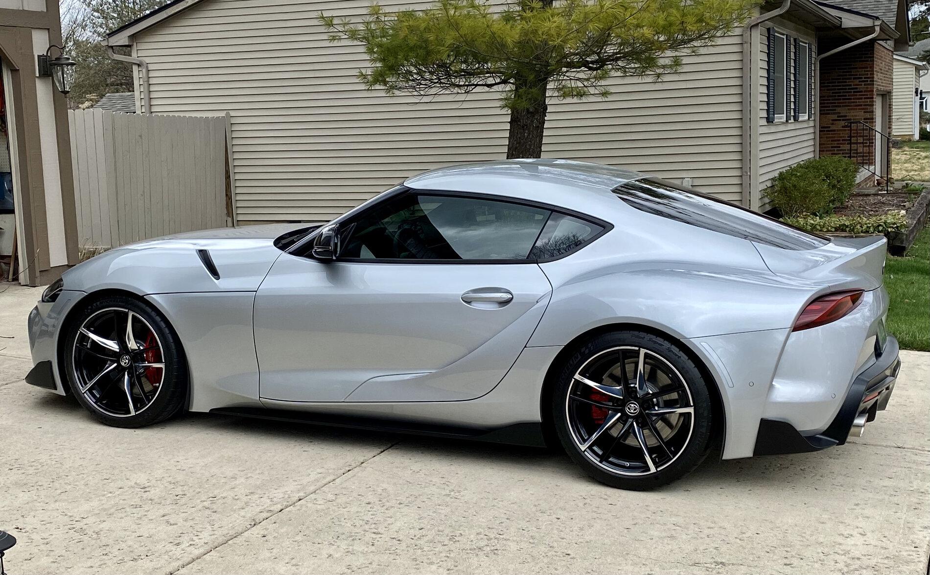

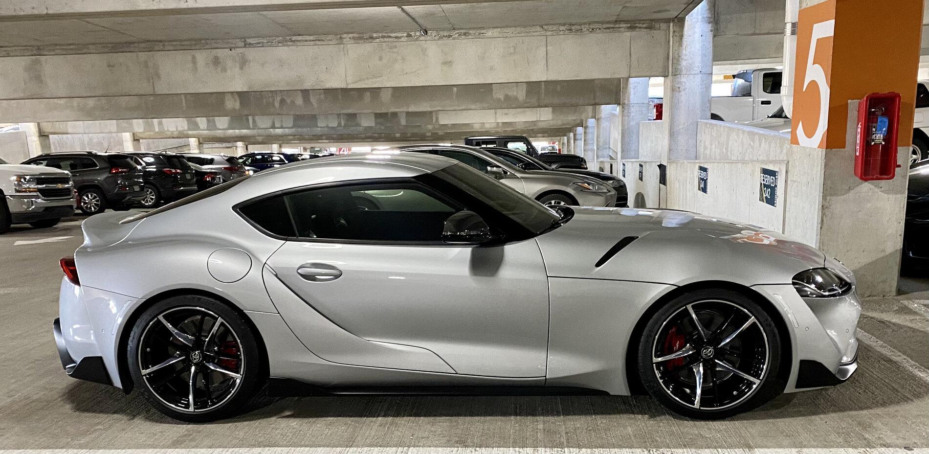

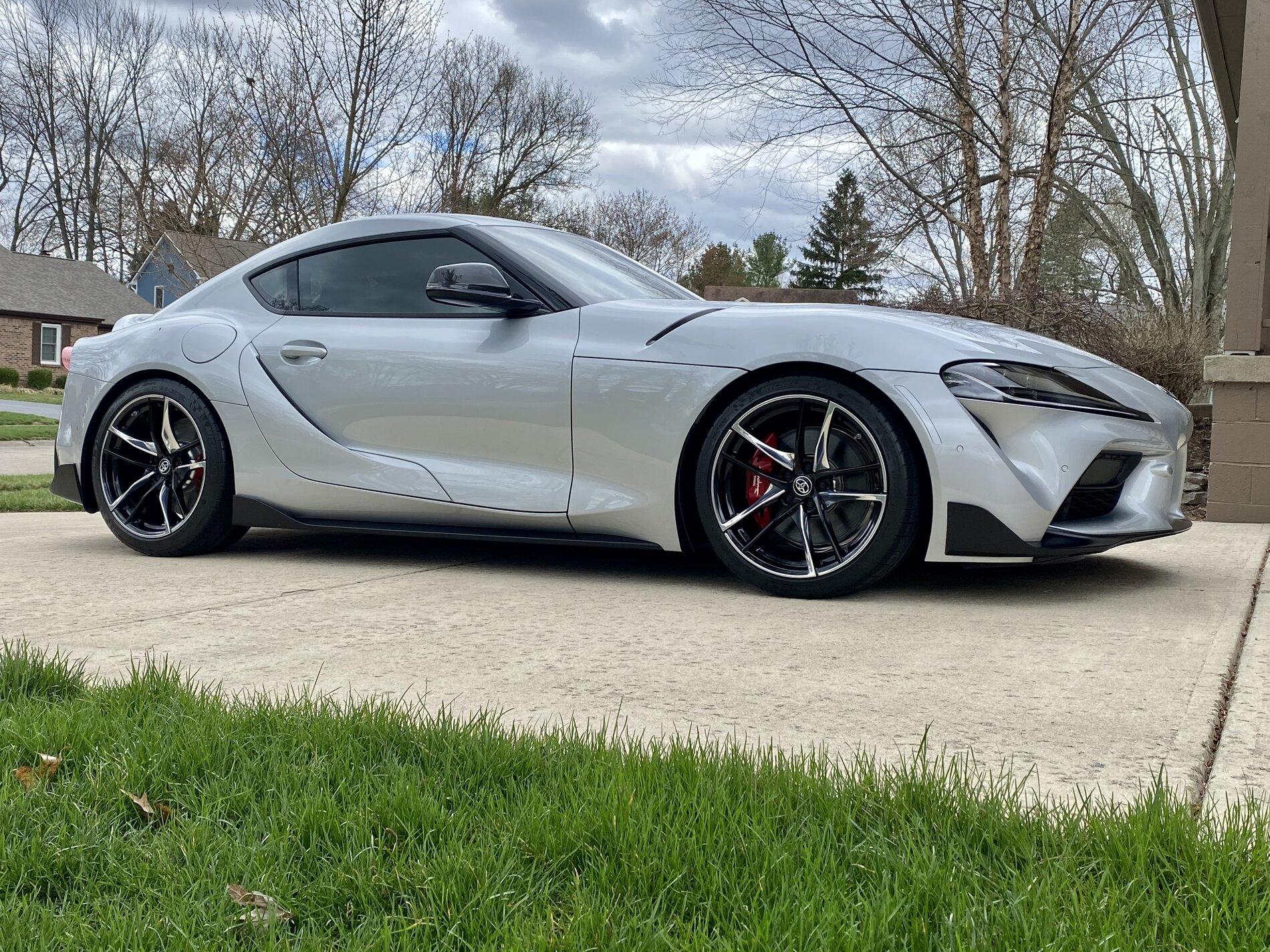

As mentioned earlier, I was in search of an even subtle drop (.8” front and rear*) versus lower than some others prefer.
Here’s the breakdown in the differences of the most common lowering springs.
H&R (Sport) Supra 3.0 -
1” front & .75” rear
Eibach (Pro-Kit) Supra 3.0 -
1.75” front & 1.2” rear
*Eibach (Pro-Kit) Z4 3.0 - (Euro Spec)
.8” front & .8” rear
(These are only available out of the county -
not a US part number)
Part # E10-20-046-02-22
After securing the correct part number I purchased the set on eBay - shipped from Poland (arrived in a few days)
eBay Link Below: https://www.ebay.com/itm/184497855474
