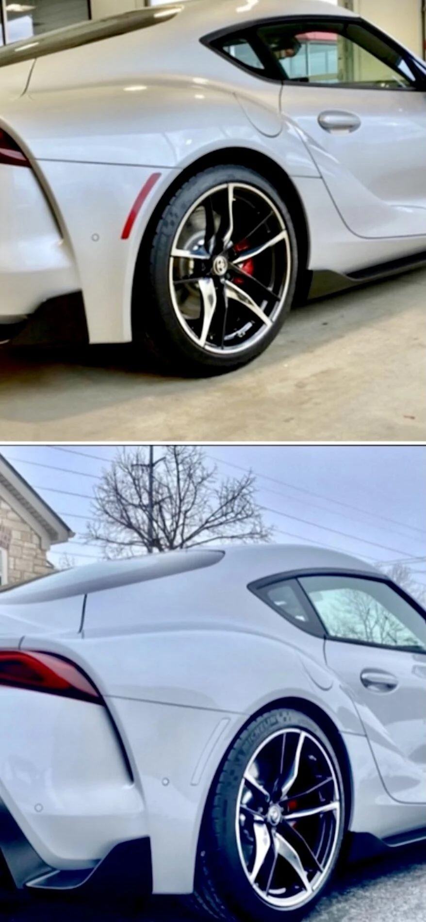

Had these springs installed with 10mm front and 13mm rear spacers. Exactly the look I'm going for thanks to the OP for the tips!
Have about 50 miles on them, no alignment yet, car tracks super straight so far, feels pretty much stock. Front wheel camber looks a little more negative than I remember stock.
I can't feel the difference in everyday driving. I can imagine how the tires would rub the wheel wells under hard compression at the track or in corners, the springs do not feel that much stiffer if at all. Sure looks nice though! ? About a 1.75-2 finger gap front and rear, I definitely would not want the front too much lower for street driving.

This looks fantastic and is exactly the look I'm going for - helps to see these on the same color! Have been leaning this way all along, but planning to do some minor tracking (doubt it will be more than 2-4 times per year and if more I'm sure I'll just swap over to coilovers) and then some recent posts that these are "much stiffer" has had be a little nervous. Doesn't sound to be the case from your experience so far (in terms of drivability/stiffness).
