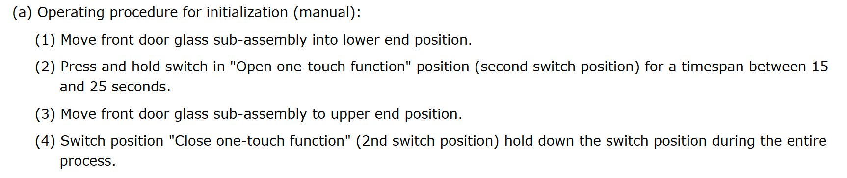

There’s also a way to reset the up / down (drop down) window when I opening and closing the door. It requires holding the window button down or up for a series of time. I’m sure this sequence can be found online. Sounds like it needs the hard reset.
Doing a window search and chiming in from ice cold SWFL. My passenger window loves to go 1/2 way down when fully rolled up or open the door. Did this exact sequence thing a few times and it works…. temporarily. The Ft. Myers, FL Toyota dealer sucks, couldn’t confirm a “Supra tech” appointment, had to rescheduled only to find out they couldn’t hook it up to a computer being heavily lowered with Eibach springs, lol. So I’m going to try the Naples dealer next for a hard reset.

The suggestion is to have the car running and hold the subdue button in the up position with the door closed for about 30 seconds. This will reset the operation to normal specs. Perhaps this is what you already tried? Hope this helps.
No. I watched my mechanic do the ”Honda” reset he called it. He held it for 5 seconds down, then 5 seconds up (or vice versa) with power on, maybe. Thought that fixed it until… it does it all the time now. So I’ll do your method. I didn’t bring it to him for that, he just tried something like it and it worked temporarily. Thanks @Andrew4Supra !!!!
