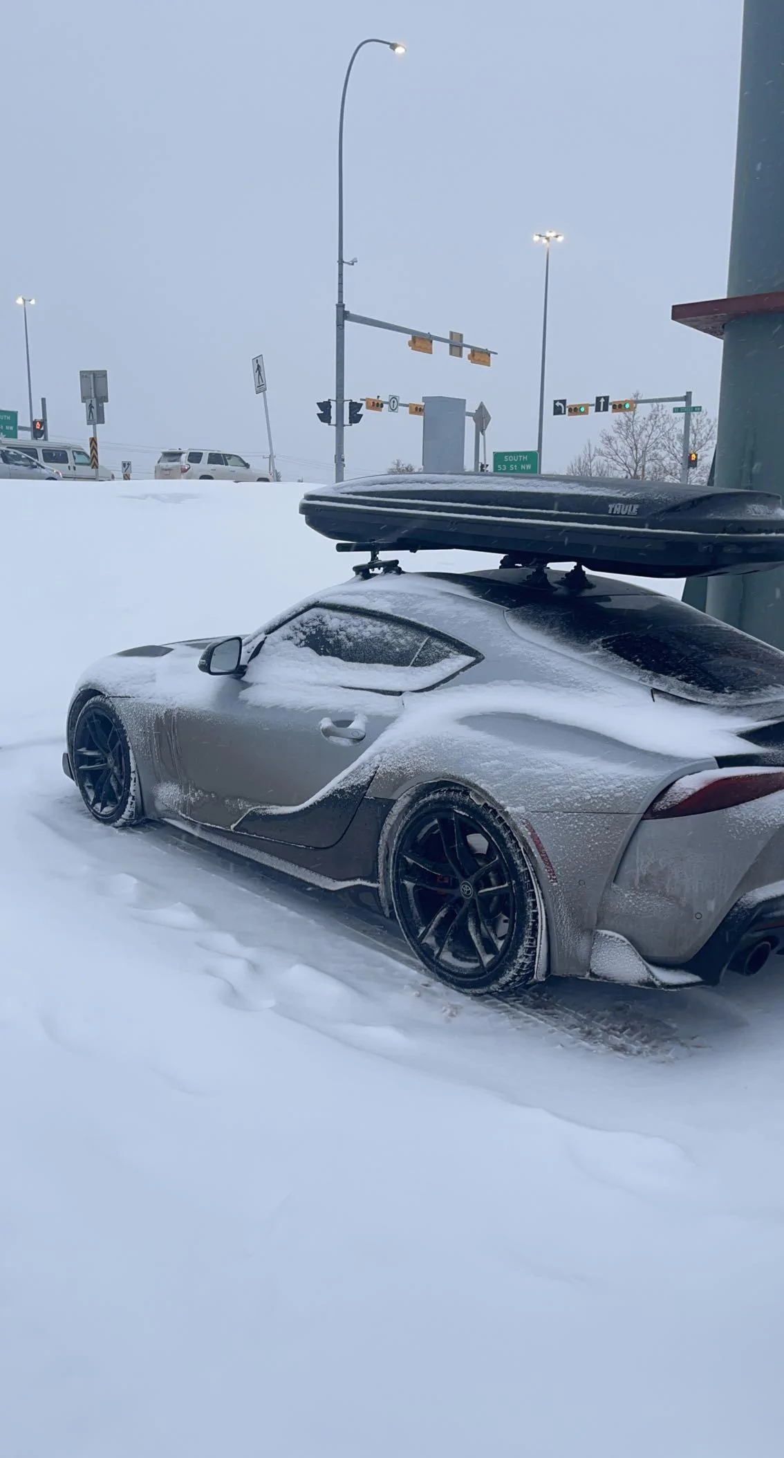

I have been driving my Supra daily here in Alberta, with temperatures the last week down well into the -30s C and a heap of snowfall. I have had none of the issues the OP is experiencing.
LMAO at posters who think the Supra should be tucked away in a garage over the winter like it's some sort of exotic car. With a good set of snow tires (mine has new Pilot Alpin 5s all around) the Supra is really no different than any RWD vehicle in the marketplace when it comes to winter use. (Actually, with the short overhang the Supra has better snow/ground clearance than my 911, which is also winter driven).
I did have an issue with the supposed Toyota safety systems doing a freakout when the sensors were completely covered in road grime...sandwiched between a semi rig on one side, a car 50 feet ahead of me (plenty of room at 40 km/hr) and a concrete divider on the other side the system decided an accident was imminent and APPLIED THE BRAKES. On sheer ice, lol. Yes, it caused the car to immediately slide. Yes, I corrected it before slamming into the semi. The "safety" systems are now fully disabled every time I start the car.

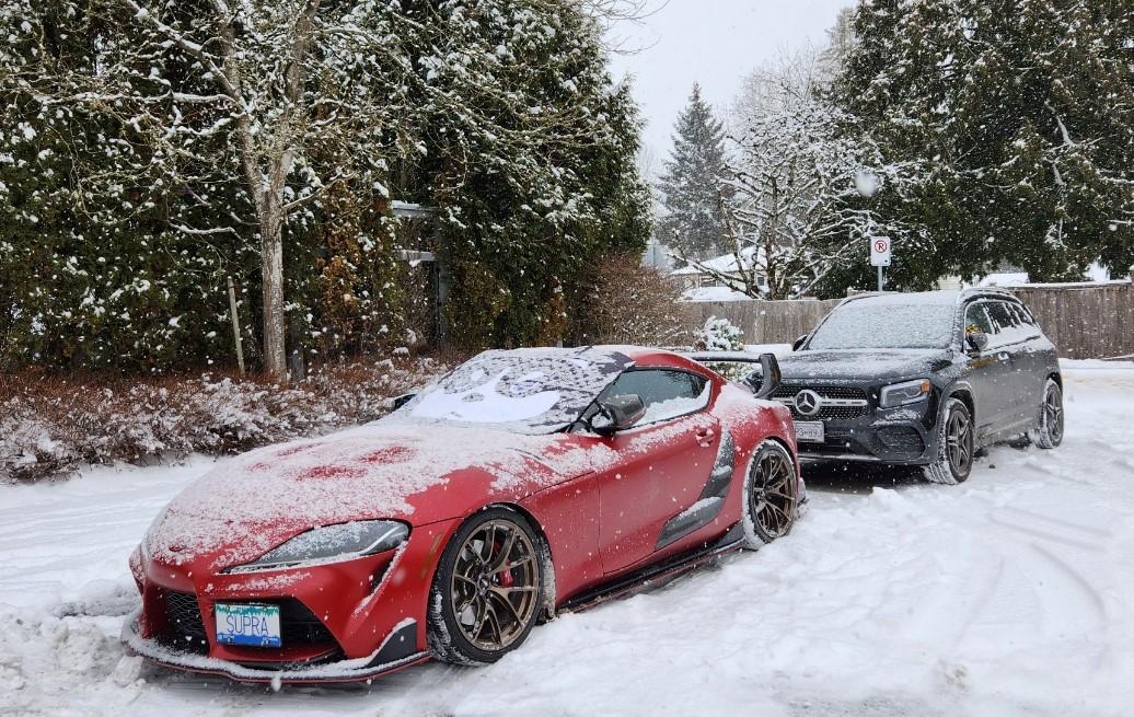

I daily the Supra in Vancouver as well.
I waxed all the rubber seals where the window touched. This made them easier to unstick themself as the car warmed up. I also carried aspray bottle of de-icer that I would spray to help loosen it.
