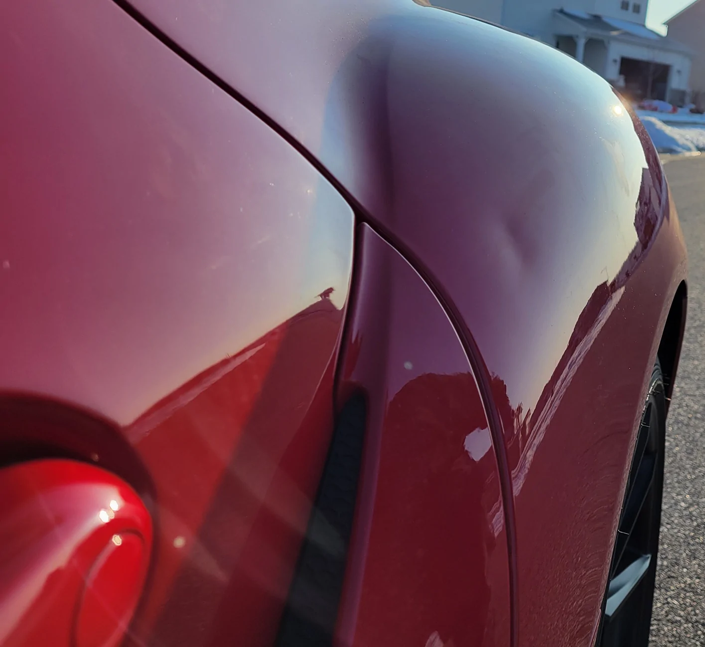

Already looking for PDR :( Had the car shipped enclosed and the driver must've kicked the panel when climbing through the window to get in.
Anyone get PDR on this area? The guy at the shop was asking if there's any body plugs that is accessible in the wheel well so he can get his tool behind the dent. I tried putting my hand behind the wheel liner to see if I can reach the dent but there's something in the way. Otherwise, I'd have to remove the wheel liner and try to find any plugs.

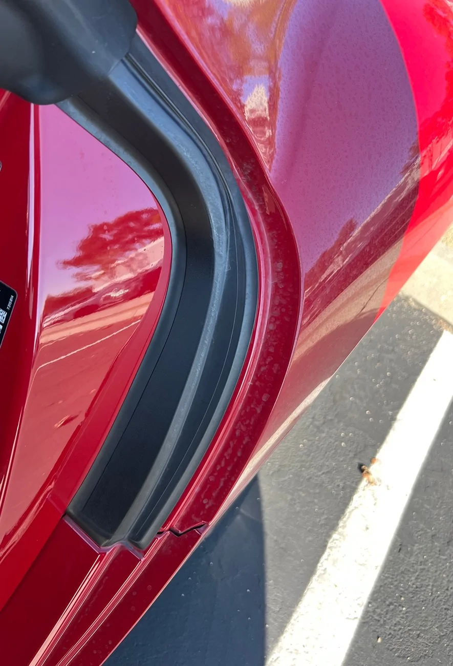

I am in the process of getting some pdr work done too on the same panel. The guy i went to hasn’t worked on supras before and asked the same question. There isn’t anything detailed well on this forum but what he found in a pdr group was that there are some decently sized holes behind the door seal rubber (that rubber area where the tire spec sticker is located) that can potentially be used, but since he hasn’t done it, not sure if they go all the way through.
(added a pic of where i was talking about)

Expert paintless dent removal guys don't even need to get behind the panel these days to pull a dent like that. They glue pads onto the area and pull the dent out. No paint damage either. I've seen youtube video of the whole process on several dents WAY worse than that. It was something to watch and very impressive. Paintless dent removal techniques have progressed a lot in the last 5 years or so but a lot of the visit your home guys haven't really kept up and just want the easy jobs and the easy way. You need to find the guys that pride themselves on the tricky jobs if rear access is an issue or you don't want holes drilled in structure.

I am in the process of getting some pdr work done too on the same panel. The guy i went to hasn’t worked on supras before and asked the same question. There isn’t anything detailed well on this forum but what he found in a pdr group was that there are some decently sized holes behind the door seal rubber (that rubber area where the tire spec sticker is located) that can potentially be used, but since he hasn’t done it, not sure if they go all the way through.(added a pic of where i was talking about)
Seems like the quarter panel is a common dent point. I was researching other threads and they seem to all be along this area. Hope that rubber area would allow access. Could you let me know if you go through with PDR what they had to do? The weather here is not so nice and I'm not sure I'd make an appointment until the weather warms up a little. I will update this thread if I find some answers.

Yeah I’ll definitely post the details once i commit to it so that others have the resources they need to get it done in this forum.

Glue was mentioned to me as well but more of a last resort if there's no other access points.

Here a quick video of the pulling method. I've seen huge dents removed with the glue method and pullers not slide hammers but this gives you and idea. You dent is pretty easy as it's quite large but shallow by the looks. Like I said there's a lot of dent guys that just wash and repeat what they are used to doing. Look on Youtube for the really serious dent removal with pullers and glue.

Not a PDR expert myself but I believe they generally prefer not to use the glue and pull method as that could potentially pull the paint off. You can damage the inside of the panel and it won’t be visible.

Push the inside and rust can potentially start there too if the wrong tip is used. I do my own PDR, and if there is no access, I use a glue puller.
I had to fix like over 30 hail dings on my dd the other year. :crazy: Looks good as new., all done with glue puller except for one.
