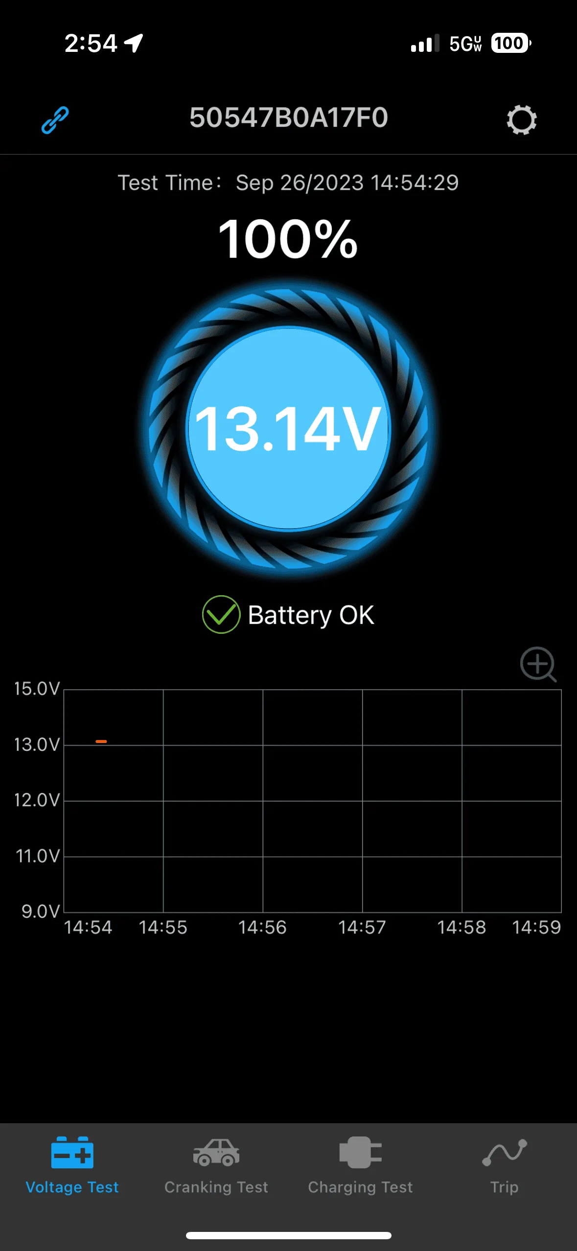

Just wanted to update the thread that this battery has been flawless. My Supra isn't a daily driver so sometimes it sits for a week or two without being driven. I have purposely kept it off a battery tender to see how it will do. I have a bluetooth battery volt logger on the battery. It hasn't dropped from 100% at all.
