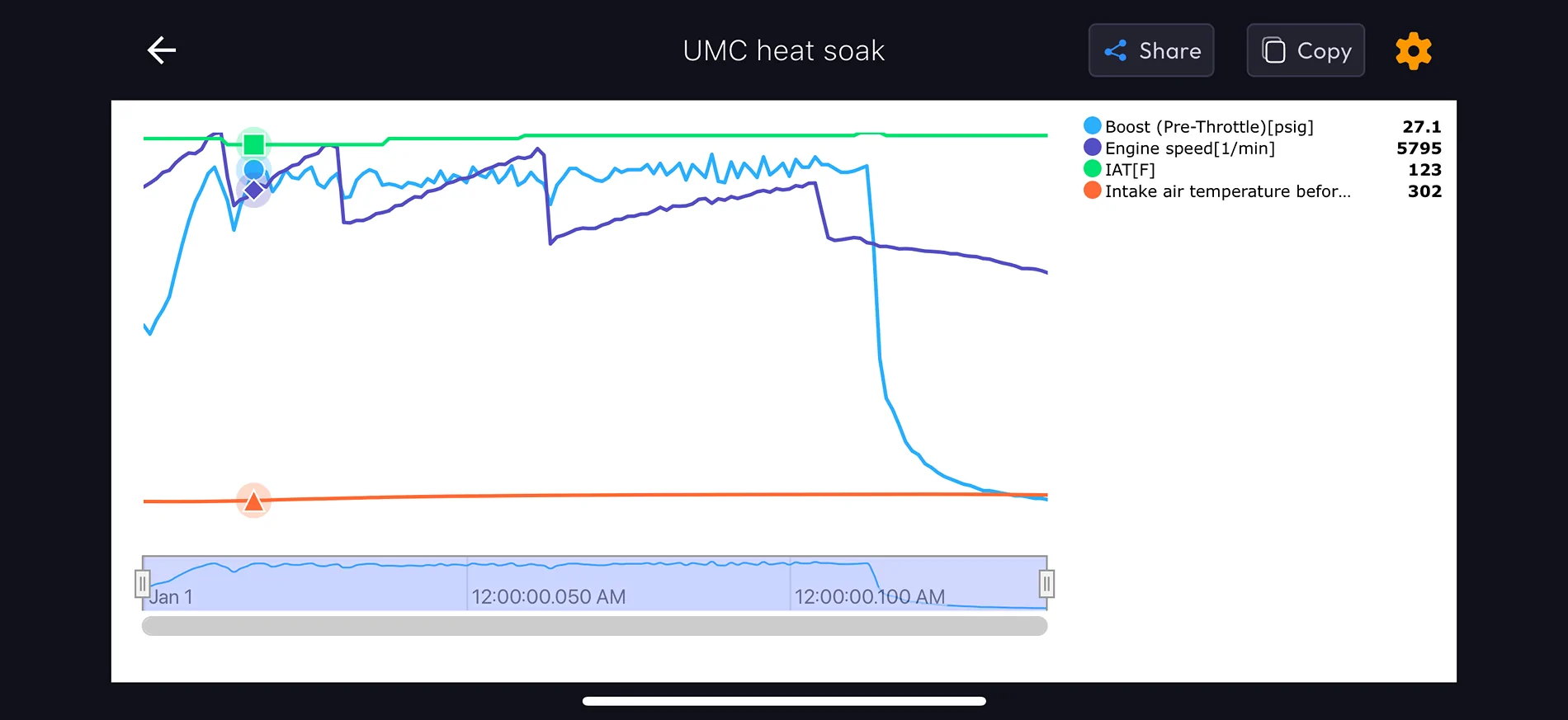

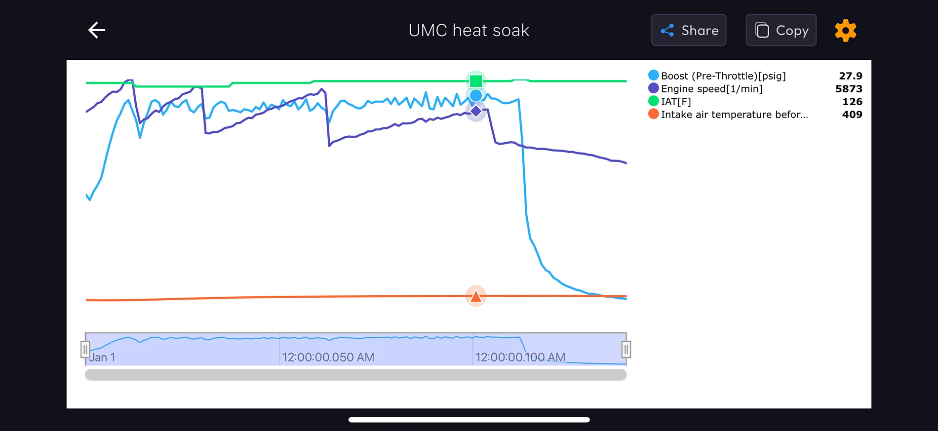

All the heavy lifting for IAT cooling is done by the manifold. Even if it does heat soak, what the actual engine sees is still virtually not impacted.
you can see in this pull, pre manifold temps are ~300F. At the end of the multi gear pull (roughly 70-160mph), it’s -400F. IATs, however, only move up 3F.
