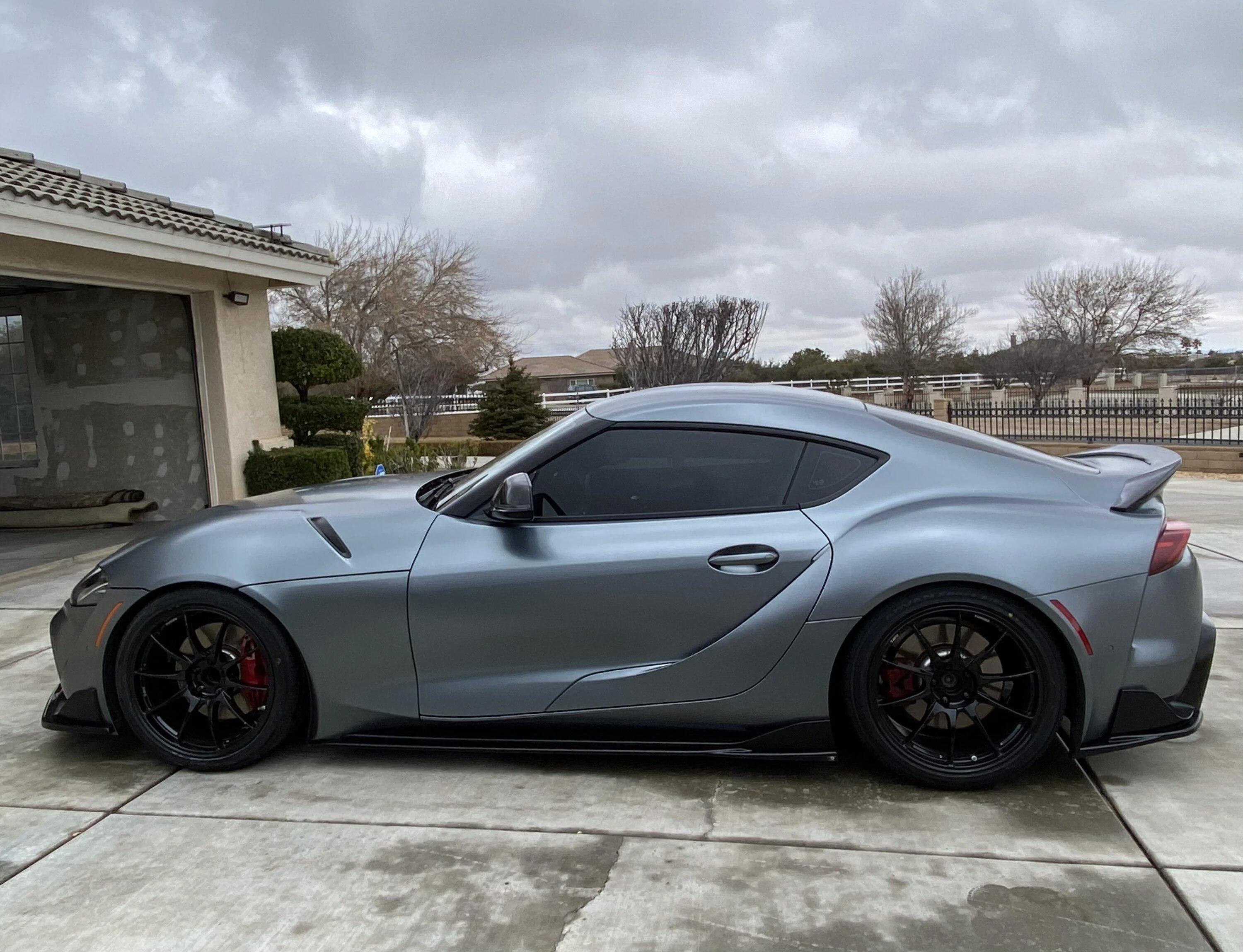

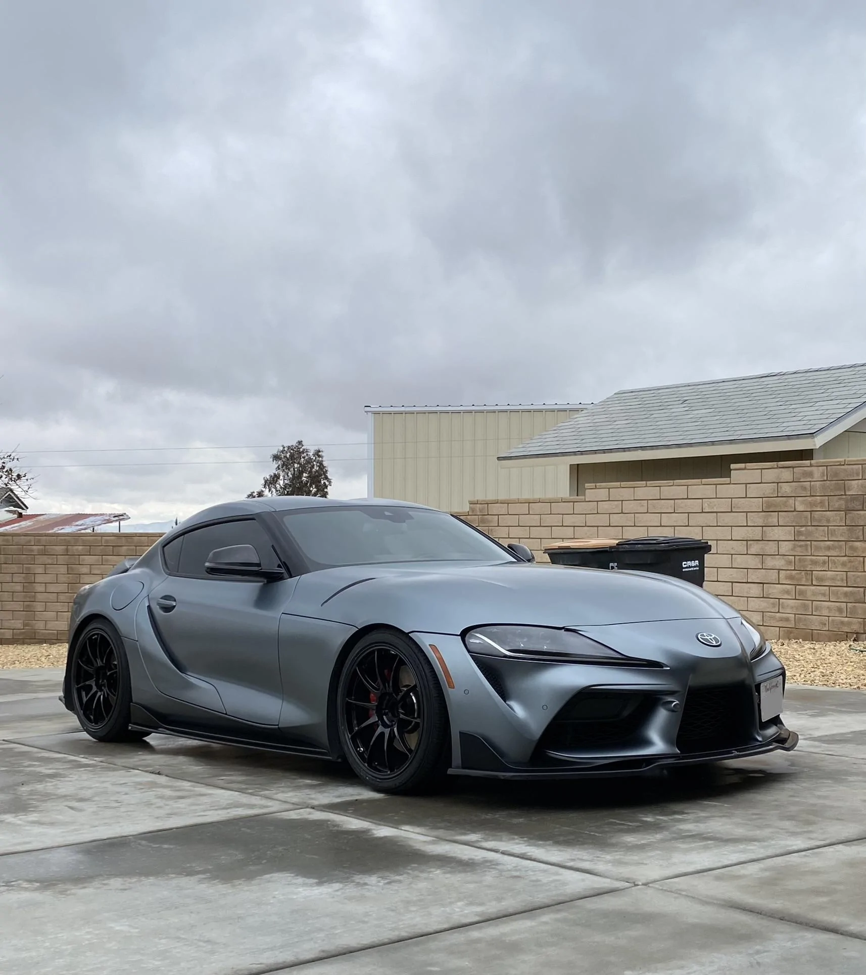

Are you running Swift Springs? Any photos or feedback or advice?
Yes I am. I think the drop is perfect but definitely much stiffer than stock. I daily my car and I think the ride quality is still comfortable. I didnā€™t modify the bump stops but have spoken to others that have

Thanks for posting the photos - your car looks awesome.
Do you have any issues with them? - e.g. rubbing, hitting the bump stops often, etc.
There are a lot of lowering spring options out there and it's almost a struggle with so many options. I just want to do my research as best as I can.
Nope not at all. Only rubs in the rear rarely when going too fast on sudden highway dips (around 85 mph). I have an issue with the the springs not being in contact with the strut mounts only when I jack up the car. But this is from me trying to install them the shortcut method. This doesnā€™t effect the ride at all, itā€™s just something that bugs me and when I lower the car back down, everything aligns back to normal
