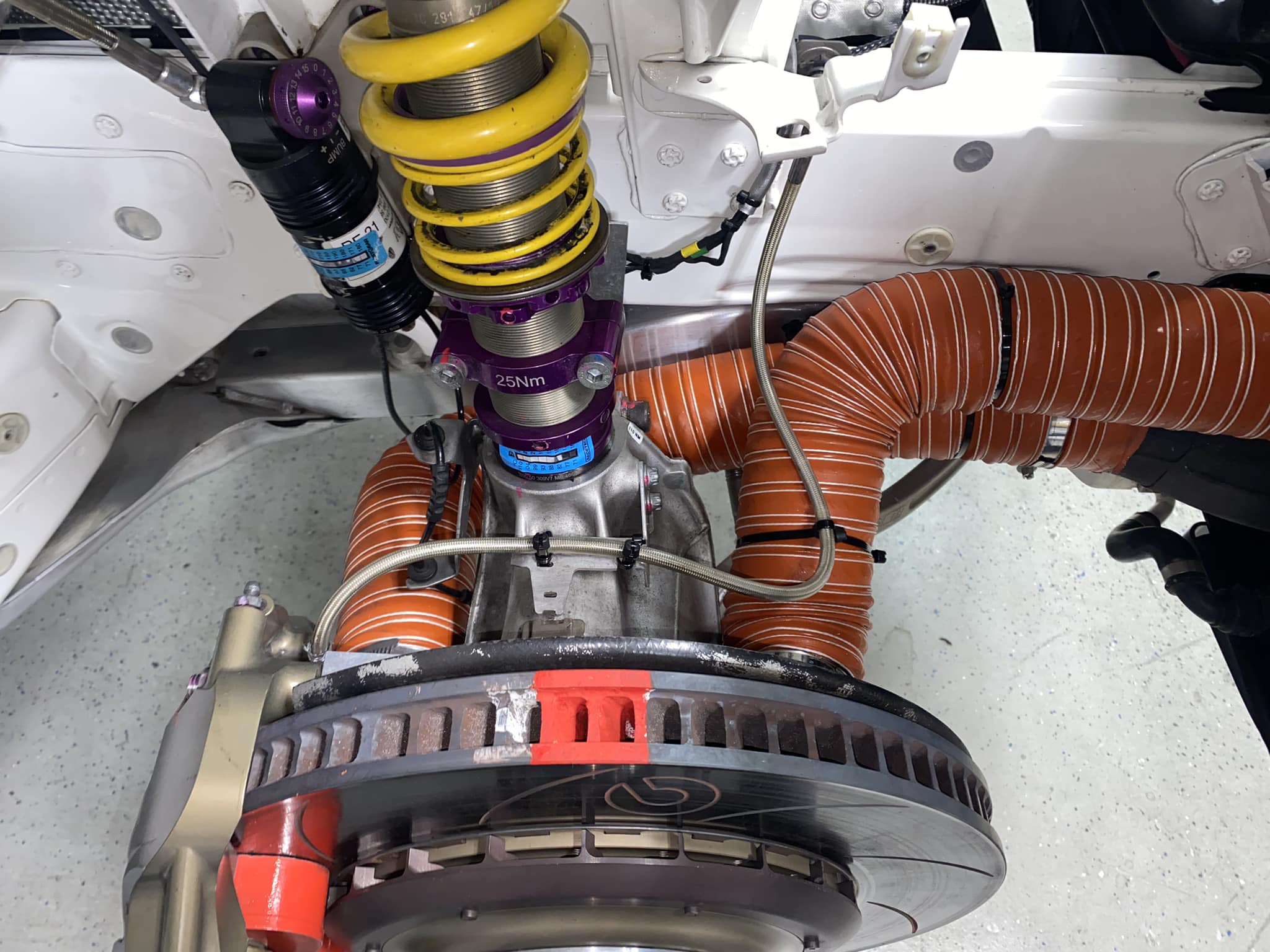

In that same vein - I would like to see what setup the Supra GT4 is using - all the literature says it has KW Suspension - which in my opinion is garbage. Whenever my OEM Dampers take a dump I'll be replacing everything with Ohlins or Penske products.
I was disappointed too when I heard Gazoo Racing went with KW. There's just so many better options available.
MCS 2-way non-remote with Vorshlag camber plates and Ohlins with Millway camber plates are on my shortlist for coilovers when I get there. I'm still exploring what the stock struts and dampers are capable of.
KW makes some decent stuff if you want a pony up about five figures. The stuff they make for the street, such as their V3, is garbage. It can't be tuned and hard to find anybody rebuild it. The club sport is marginally okay, in my opinion, but their motorsport stuff is not bad at all.
They use the KW motorsports coilovers. Very different than consumer grade.

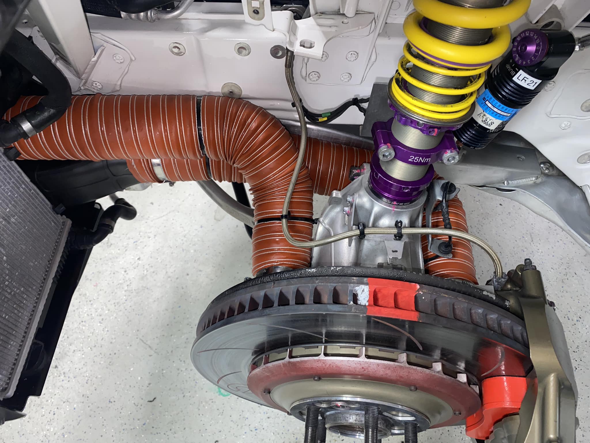

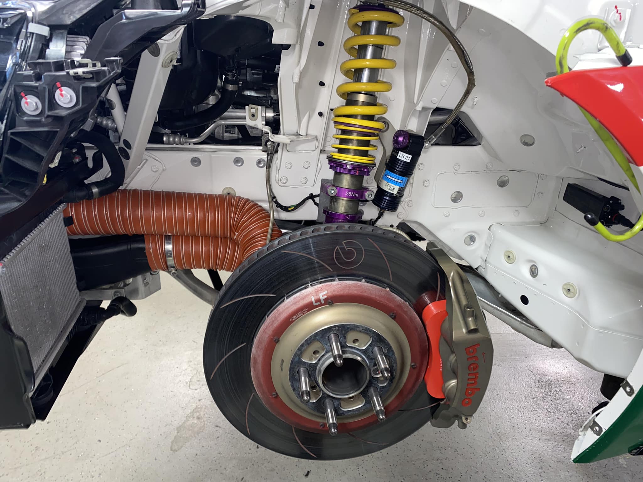

Holy friggin spring rate! Look at the size of those primary springs! They look like sausages!
Vented rotors with vented hats with not 1 but 2 cooling ducts lol.
Looks like they slap those temperature witnesses stickers on anything and everything they'll stick to.
Damn Bryan, you've always got all of these great shots of the GT4!
