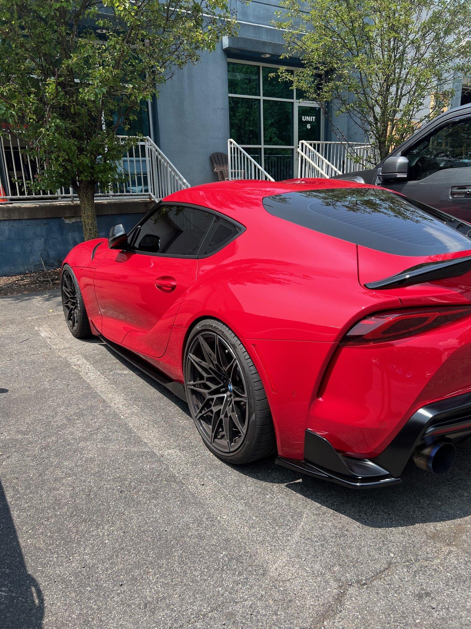

my car was at the shop and while waiting for my wheels to get back from powder coating they slap these on.
Ohh that looks sick and awesome! ? Do you have anymore pictures of the wheels on your Supra? If so I would like to see more. ?

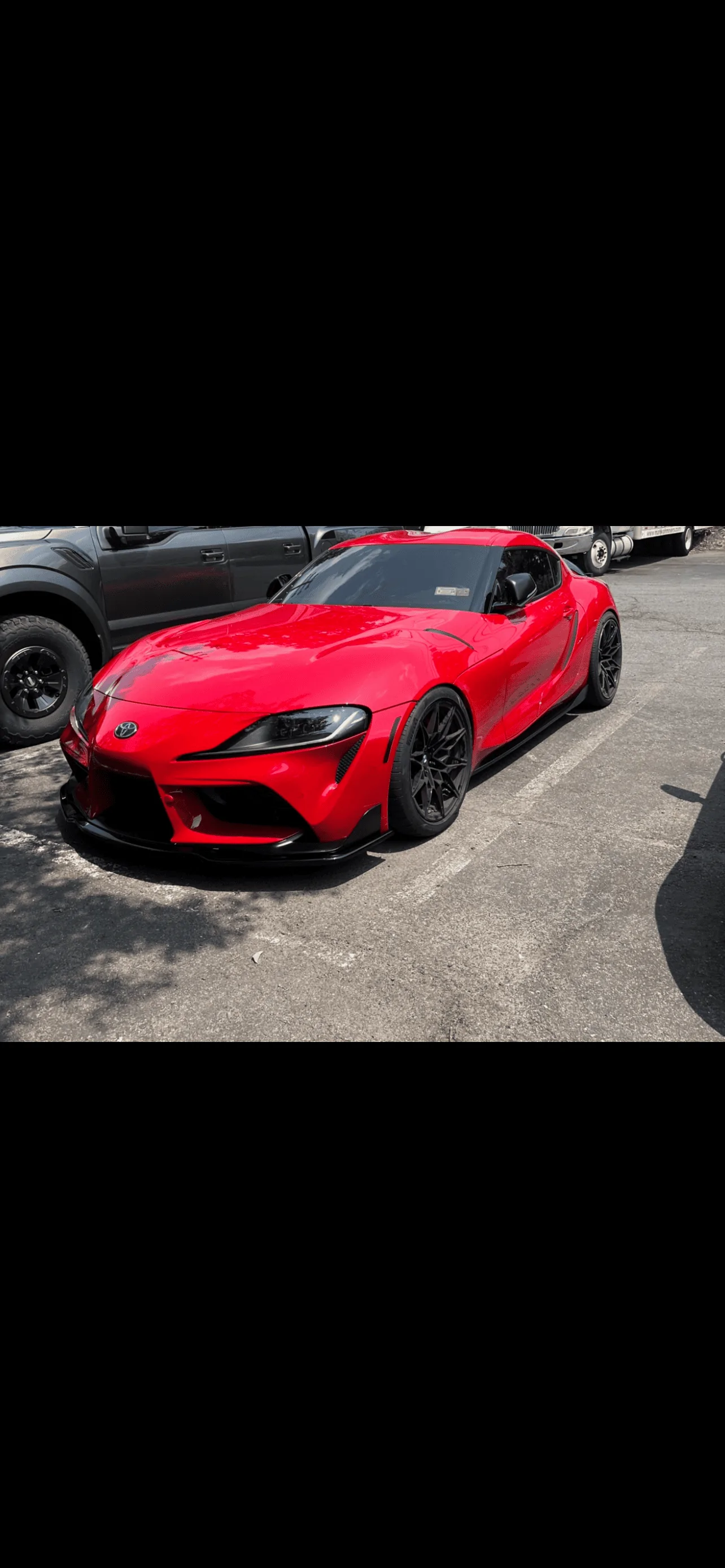

Looks like some poke on the rear?
Hi,
I was wondering do you need to put spacer? Or they just go on without any issue? Cuz the back is 20inch. Thanks
