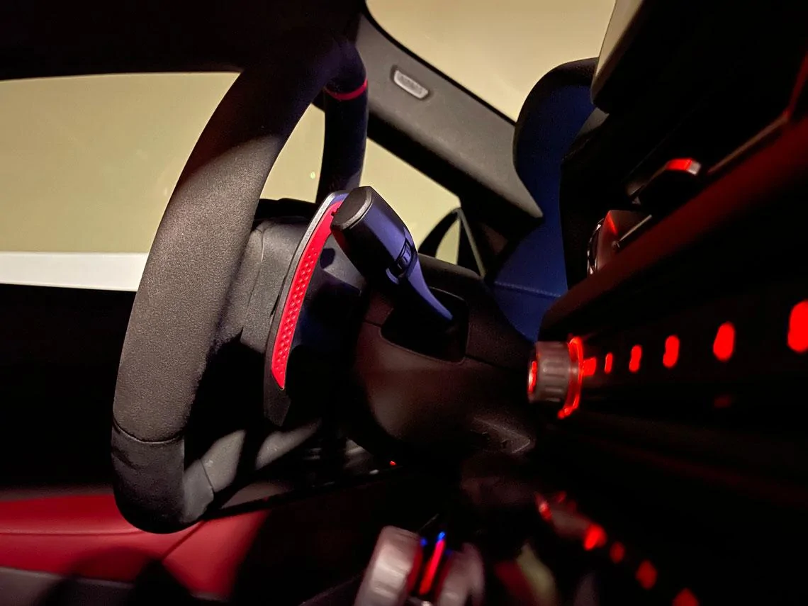

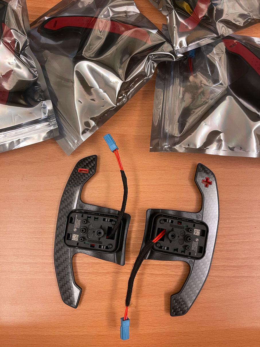

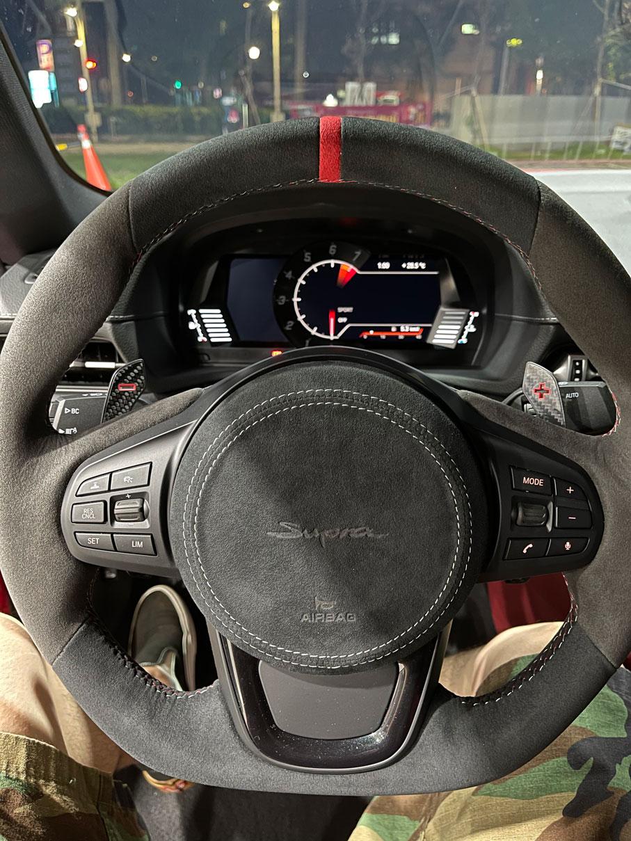

I was wondering if Supra can install the new carbon fiber shift paddles from new M3/M4 but I couldn't find any info from Internet.
I guess the only way is to try it myself.

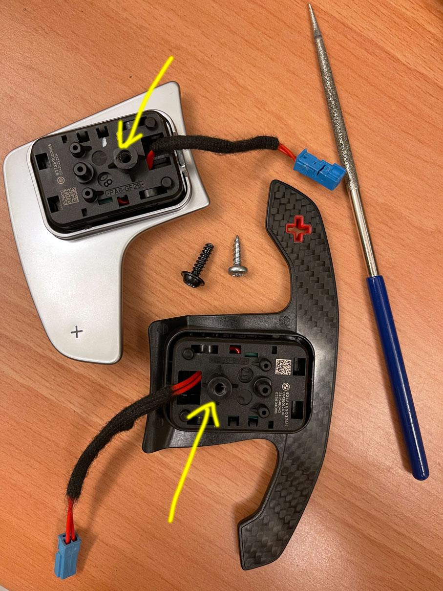

Note: The screw holes on the paddles are smaller than the OE ones, make sure to enlarge it before installing to fit the original T20 screws.
Removing the air bag is pain in the ass, but the rest parts are pretty easy.
And I'm happy the paddles fit Supra and work perfectly!:headbang:

What did those cost and did you order from BMW?
The genuine parts cost $700 as I know:doh:
I didn't order mine from BMW but local parts dealer.

Who did you steering wheel airbag ?
https://www.facebook.com/FSVehicleDesign
The trick is to press the air bag while you are unclipping it. It takes less than a couple of minutes to pop out if you do that.
I did but still very tricky...maybe just me.
It took me 20 minutes to unclip all 3 clips
