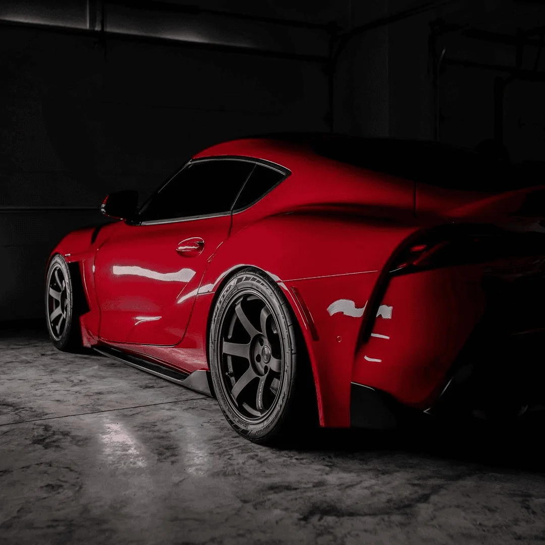

I would say definitely a nice beefy sidewall. So instead of dropping down to 30 series. Stay with the 35 series sidewall. As far as lowering, I wouldn’t even lower this car IMO. Most of the people lower this car for looks not performance. I doubt a set of $300-$500 springs will help. Lol The 35”s in wider tires and wheels will really fill up that fender gap.
And if your going to lower it, do it right and get a full coil over setup something like the RSR which also includes the plug in harness for the stock electronic dampeners. IMO of course.
Just look at this member’s car below. He is on stock suspension but just more beefy tires and wider/lower offset wheels.

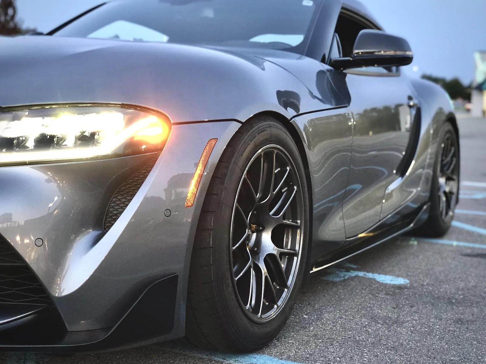

Excellent points above. It's relatively easy to both decrease unsprung/rotational mass of the wheel and tire package and increase the sidewall height of the tire by going to a smaller diameter wheel. The brakes on these cars will accommodate some 18" wheels and if you like the meaty sidewall look 18s are a great option:
275/40-18s on 18x10.5 ET38 wheels
19s look great on this chassis as well though so it can be a tough choice.
-Tom
