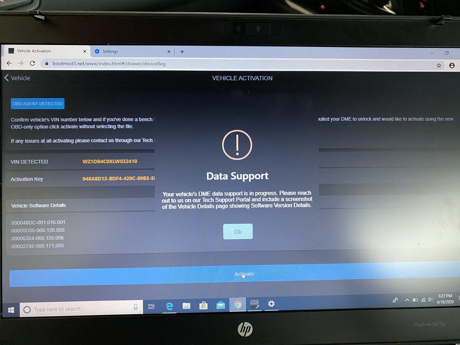

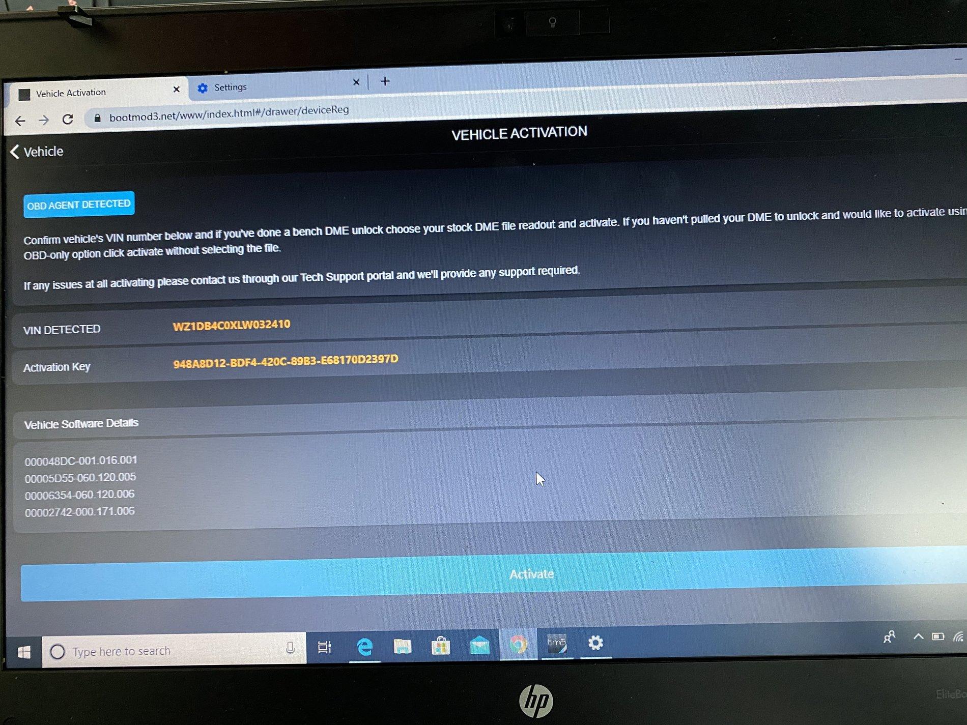

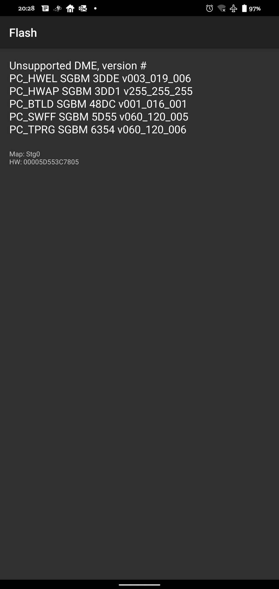

I tried to flash my car and I am getting a unsupported DME page, is this one of the DME that is locked? Never had a recall done but the production date is relatively late.
Please advice!
Please advice!
yes, you have a locked DME rom

That's unfortunate, I'll have to send this out to get it bench unlocked. Any recommendation on that?
Or should i just wait on mhd to figure out how to break these? I don't mind waiting a few weeks, can't really go anywhere anyways
I'll ask and see how far along they are with an OBD2 solution.
I am in the same situation as you. I got my MHD last week and was bummed out. Based on the response i received from MHD, it doesn't sound like theyre close.
They just told me to get in touch with one of their partners to get a bench flash done

I'll probably just send it out to get it unlocked, its not like i am out and about these days.
we can do the bench unlocks as always.
