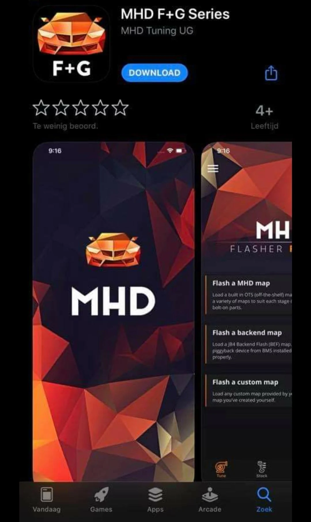

I had a JB4, wasnt happy with it so i removed it and bought one of the f/g wireless flashers. I bought the super license, got everything loaded up and tried to flash the car. I had a similar experience that someone posted earlier about it failing to authenticate, this post helped me resolve that turned out i was it was because i was leaving the door open. Took the car out for a drive just to make sure everything was fine and the battery was good and charged.
After the drive i got home and decided to give it another go with the door closed, lights off, radio and climate controls off and bingo..flashed the stage 2 map with no issue. it completed, waited at least 30 seconds that the app displayed...try to start the car..nope.... "Start Engine only with no gear engaged" is displayed on the instrument cluster and the main display. The car is in park, with the parking break on. I tried to flash it back to stock, also successful, no luck, same message. Also tried disconnecting the battery for a several minutes in a frantic attempt to resolve the issue with no luck.
Not sure what to do here? I put the car on my trickle charger for the night just to see if that helps.... doesn't seem like that will help this though. I now have a 3 thousand pound brick sitting in my garage.
