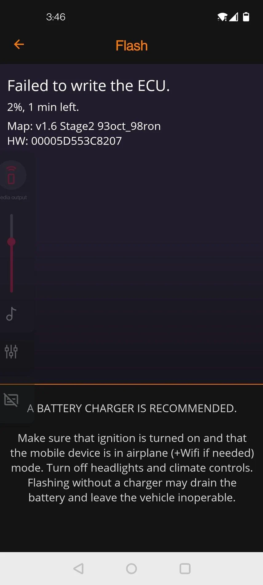

I recently had my ECU unlocked so I can tune with MHD but unfortunately, my the flashing process kept failing to write past the 2% mark and out of panic, I restored the ECU with the backed up stock file resulting in locking my ECU.
Keep in mind I adhered to the following:
  • connect vehicle to a battery charger.
  • set it in diagnostics mode.
  • turn off lights, radio etc that is not required.
Long story short, I've getting the tuning shop that unlocked my ECU to do a complete rom restore and unlocked again and am planning to flash with MHD again but am a tad nervous of the same thing happening again. Any pointers would be gratefully appreciated.

looks like you have a newer 2021 rom ID. Whats the ECU manufacturer date on the ECU label? Usually if the flash fails its due to the device not being in airplane mode or low battery. But its hard to say. Are you using the MHD wifi adapter for flashing or something else?

The ECU was a Nov 2019 production and I'm using the MHD wifi adaptor (the black one).
My tuner has informed me that he's restored the ECU and is having difficulties patching it for MHD the second time round due to a checksum error.
MHD has claimed that I have modified the stock file when all i did was restore the ecu to stock with the back up file I made in the app. I've extracted the MHD root folder and logs for them to vet through. Now it's the waiting game.
:bat: not sure if I need to obtain a new ECU and if that's even possible. ? I just stumbled on The Houston Shop that offered the ECU firmware rollback and unlock but I think it's a tad too late and besides I'm based overseas so I'm kinda screwed. ? On the brightside mechanically the car has 750miles while all this is happening.
