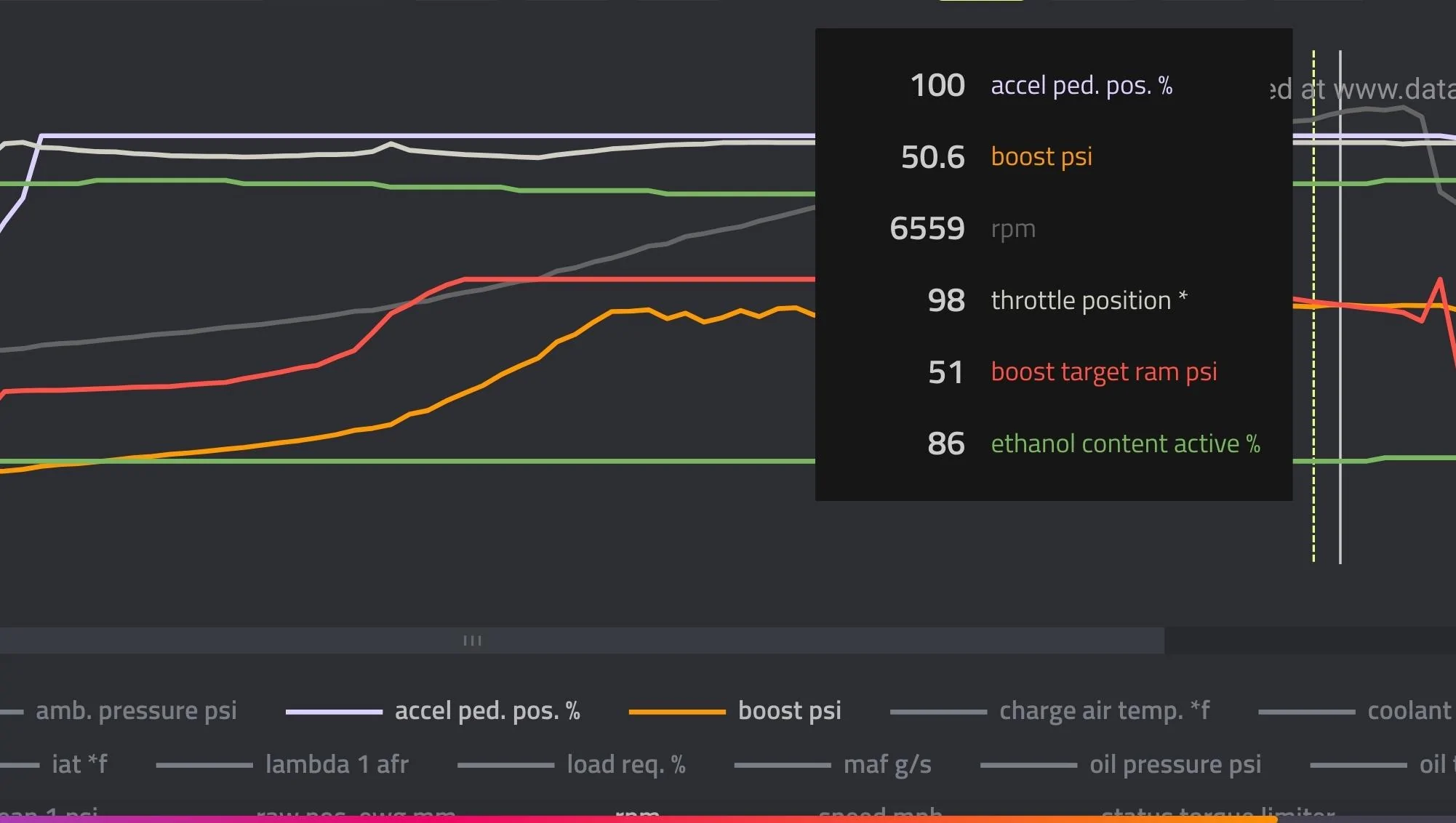

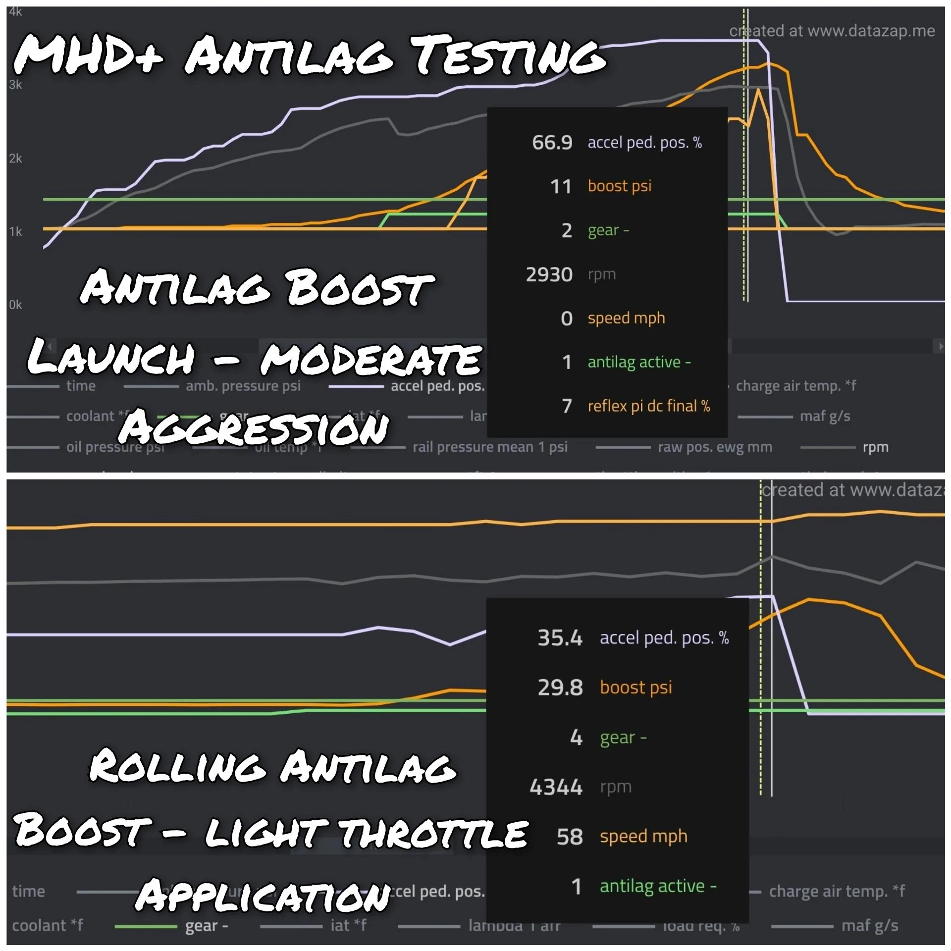

Doing some MHD+ feature testing with MHD. Getting closer to public release.
This above is a quick Gen2 B58 (which includes supra) antilag validation test from a couple days ago.
Below is a log screenshot from a day or so later after dialing in it a bit more. ww are building a hair under 40psi within 1-1.5 seconds of activating the antilag. It's as close as you can get to instantaneous boost.
Testing will continue. Also now on our car is map switching, flex fuel and etc.
Cool but need re sent ecu to femto ?
Wouldn't 40psi be wayyy to much boost on a stock turbo???? Thought are max psi was around 21psi or so.
yes still needs to be sent to FEMTO currently for unlock and MHD+ loading.
He ain’t stock turbo, he’s top mount if I remember correct.
correct, if i were stock turbo yes 40psi that stock turbo wont last. my car has an EFR9280. stock turbo max psi is subjective.

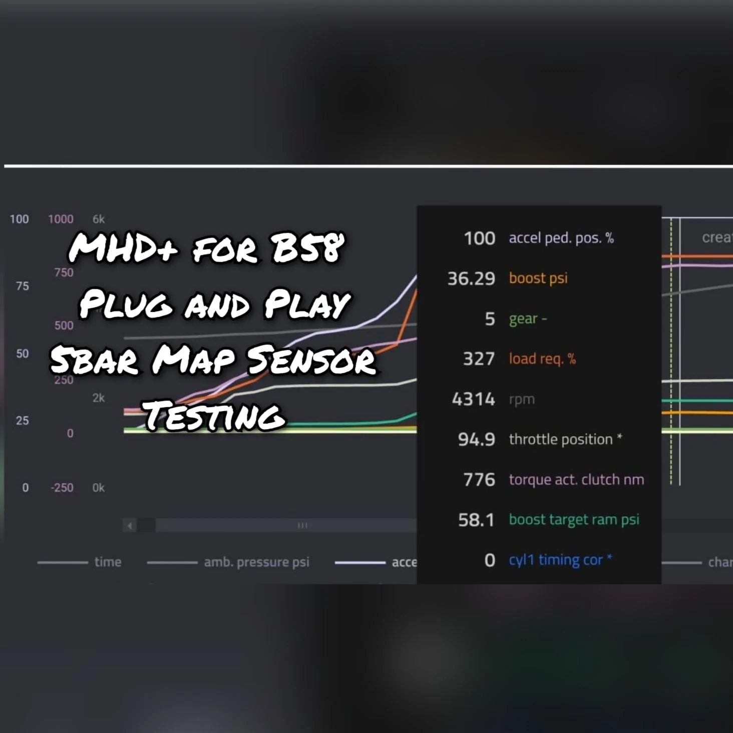

More testing using our shop Supra of the upcoming MHD+ features for Gen2 B58 vehicles.
Here we are testing MHD+ custom ECU logic for a plug and play 5bar map sensor which will allow seamless boost targeting of over 50psi of boost.
Pending your setup allows you to take advantage of this safely, it leaves roo. For a ton of power if high boost needs to surpass the OEM 4bar map sensor limits.
Map adjustment for 51psi vs 58psi target andbboost control adjustment to meet closer to target.
All this teasing is there an ETA for MHD+?
I need to femto my dme and won’t until this is released!

Are we any closer to getting MHD+, this year maybe?
ETA is this year. Before year end. I ask again to verify. But as you can see everything is working. Just waiting on their decision to release publically. MHD team are a group of perfectionists
Thanks for checking and yeah it’s been torture seeing all these awesome features that we can’t use ?
Hopefully soon as I’d like my dme sent away and returned before Christmas time ?
