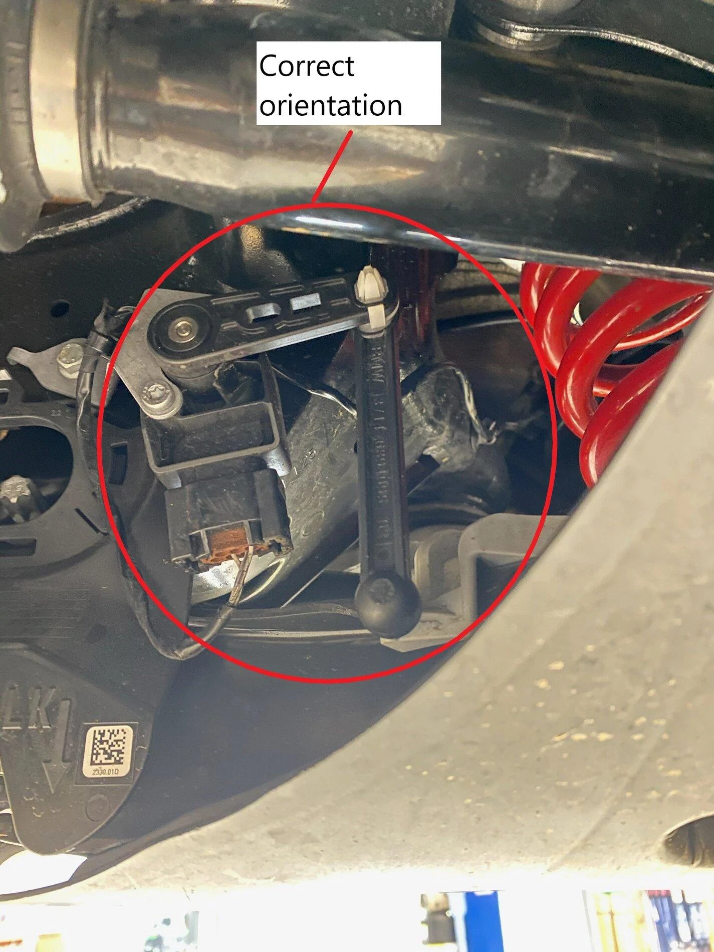

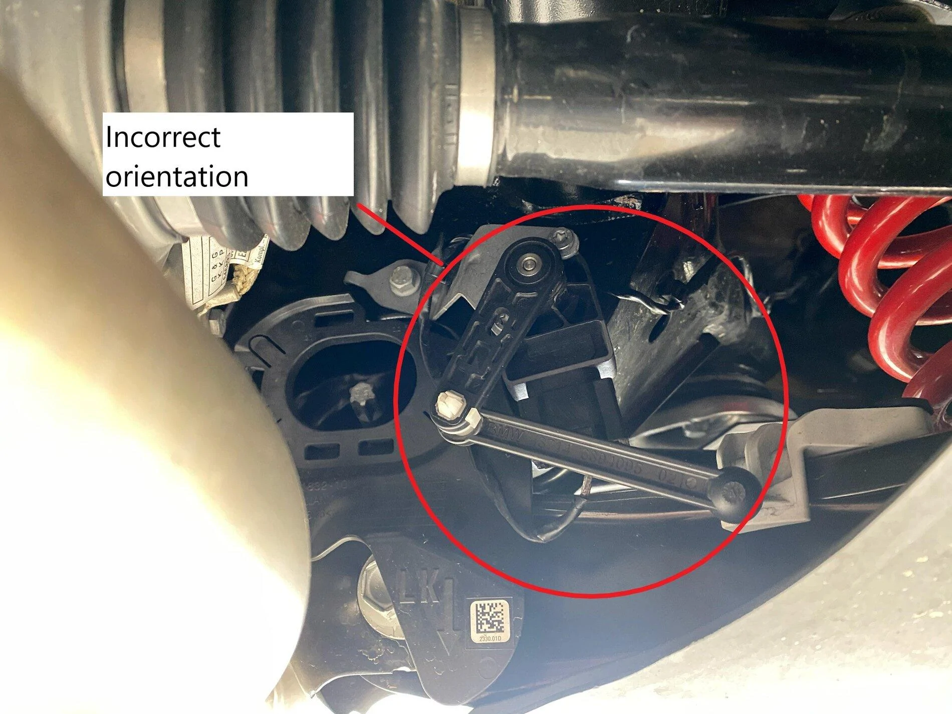

Did you check to see what's tripping the chassis error using BimmerLink or some other diagnostics tool?
If it's the rear height sensor then it could be a few things. The bracket that holds the arm could be broken in which case Visconti and VTT have a replacement. Another thing is the orientation as shown below.
I have a jb4 and no codes come up. Nor do I have a CEL. But I figured jb4 would have picked it up šŸ¤·šŸ½ā€ā™‚ļøā€¦.
going to a shop now. I would have thought if it was the orientation I would have had the message long ago (been lowered 2 months)
Maybe itā€™s that bracket you spoke of, mind a link? Thanks for all the help my brother

A diagnostics check should tell you what's causing the chassis error. Whether it be the front or the rear sensor. I've always used BimmerLink. That's how I was able to know that it was my front sensor giving me issues. I've had trouble with the front and the rear and have fixed both.
These are for the rear. Very rarely do these need to be replaced. They usually get damaged during servicing. You should at least check if the bracket is damaged before buying these because it would be a waste of money.
https://www.viscontituning.com/products/a90-supra-rear-suspension-ride-height-sensor-bracket-upgrade
https://vargasturbo.com/product/vtt-a9x-supra-billet-ride-height-bracket/

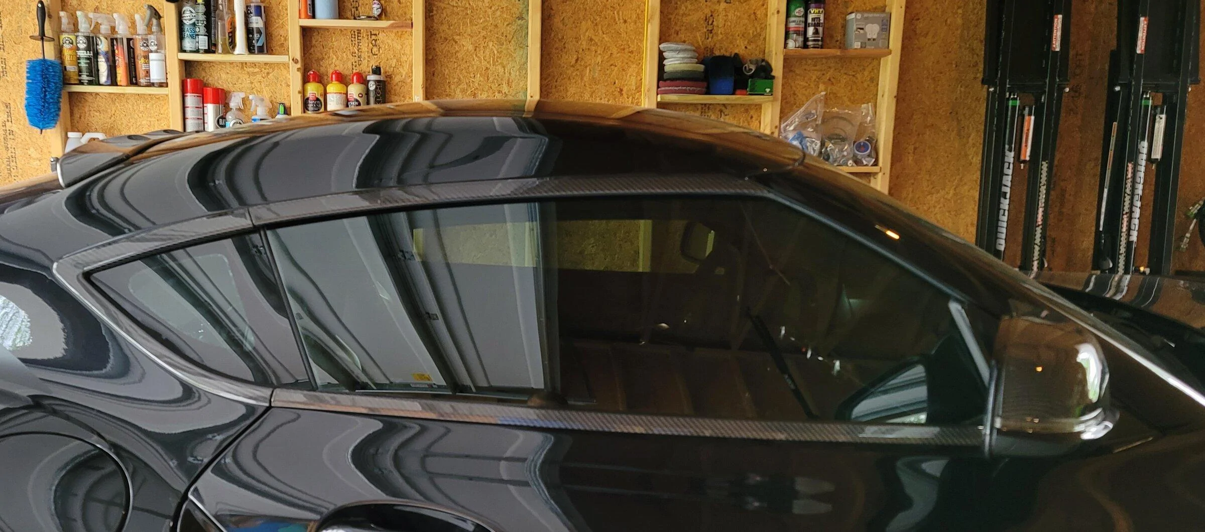

I messed up my window trim trying to clean it a few months back. I threw on the Revel CF trim kit to hide my screw up.
I don't know if I'll keep it or not.
