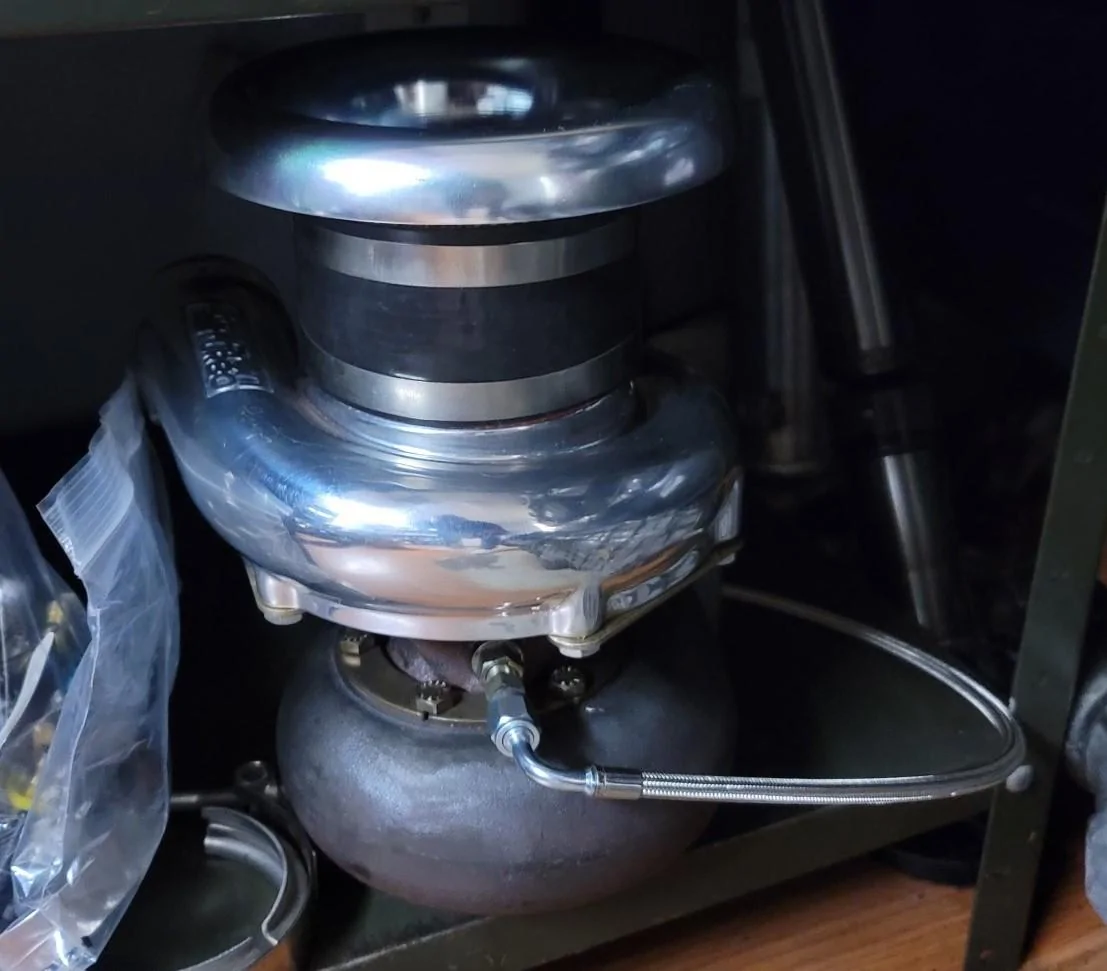

Pump, Axle, Flex, Port, Turbo, Tune, Transmission Tune.... Install show be finished Friday. Mike Botti will be by next week to do the tuning. Should have the car back by next Friday.
Some pics of the cerakoted kit and turbo (velocity stack coming off).

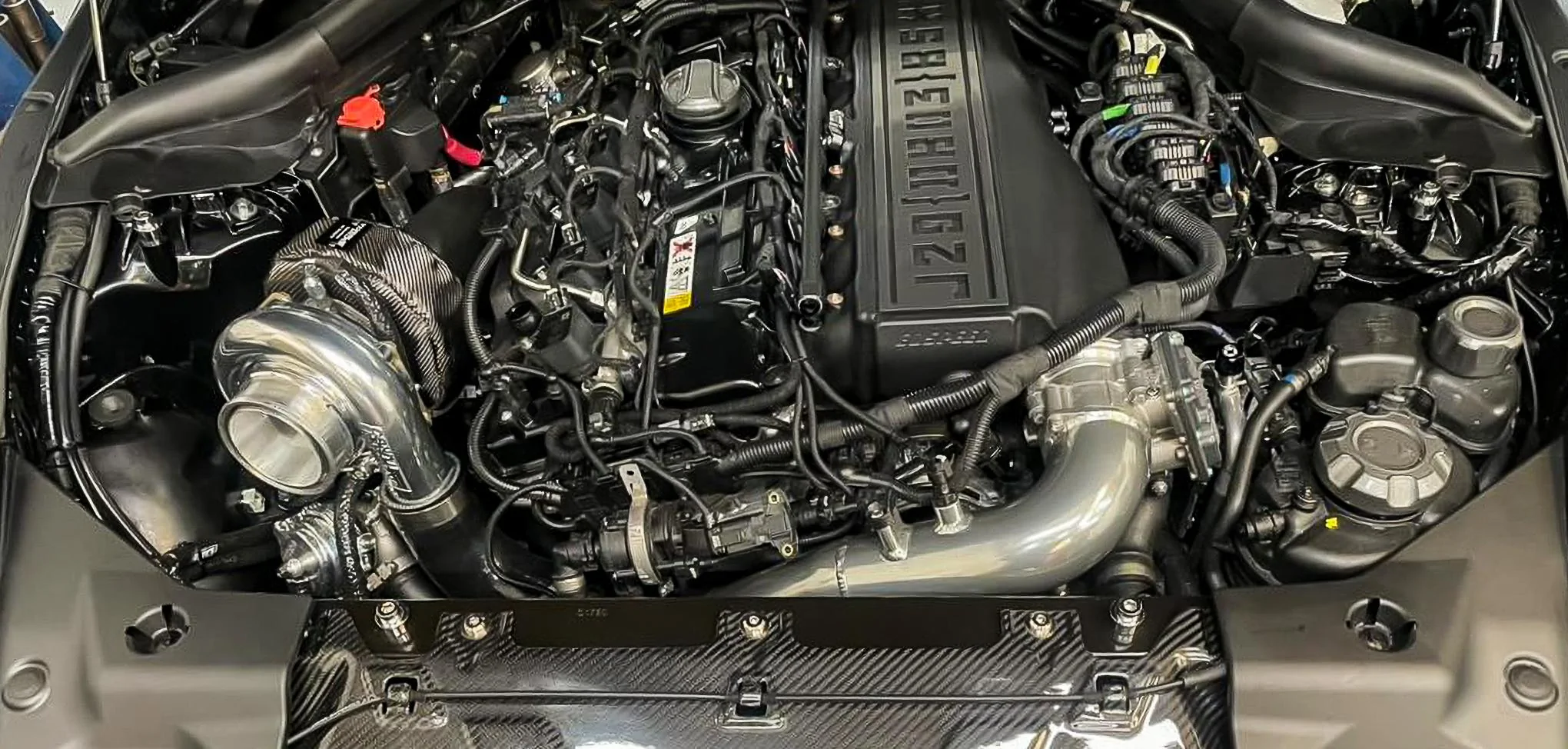

Progression.. The turbo kit is almost completely installed. Got the charge pipe powder coated. BOV installs under the charge pipe. This car is going to sound either annoying, beautiful, or both.

Drove the car today. It's only on a 93 tune @ 20 psi and no trans tune yet. It is not the same vehicle. It sounds super visceral now. The sensation of speed and g-force is intoxicating. It's not even properly tuned yet. The B58 is legendary.
We've got to mod the engine cover slightly to fit over the hose going to the new catch cans.
Strut bars no longer fit. If anyone knows of an alternative for top mount turbos that would be much appreciated. I may have to do something custom.

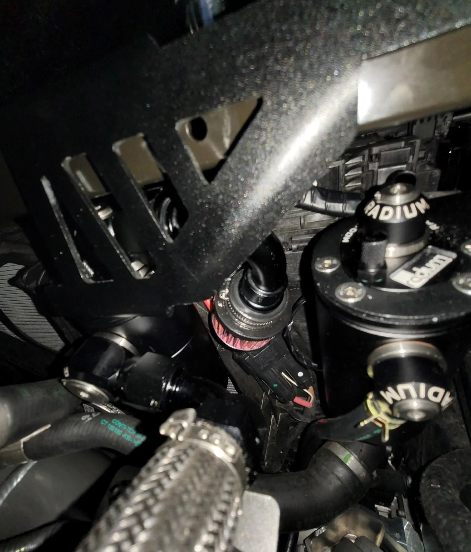

Any new pictures? I'm curious about you catch can setup.
The dual catch can setup has a vent filter and is at the very front of the car tucked under the frame. It also has a guard that blocking the cans from view. I was in a rush to get back home and it was night time so this is a horrendous picture. When I get the car back on Saturday I'll take a video or something to show it off a little better.
