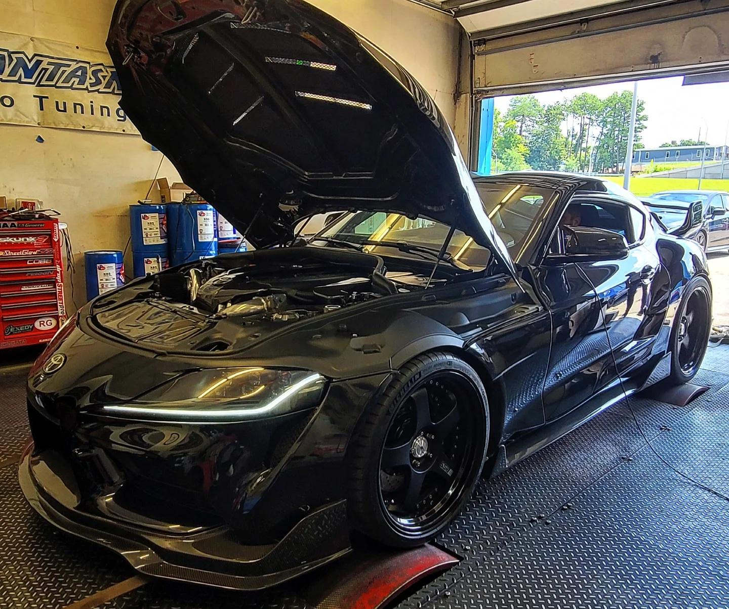

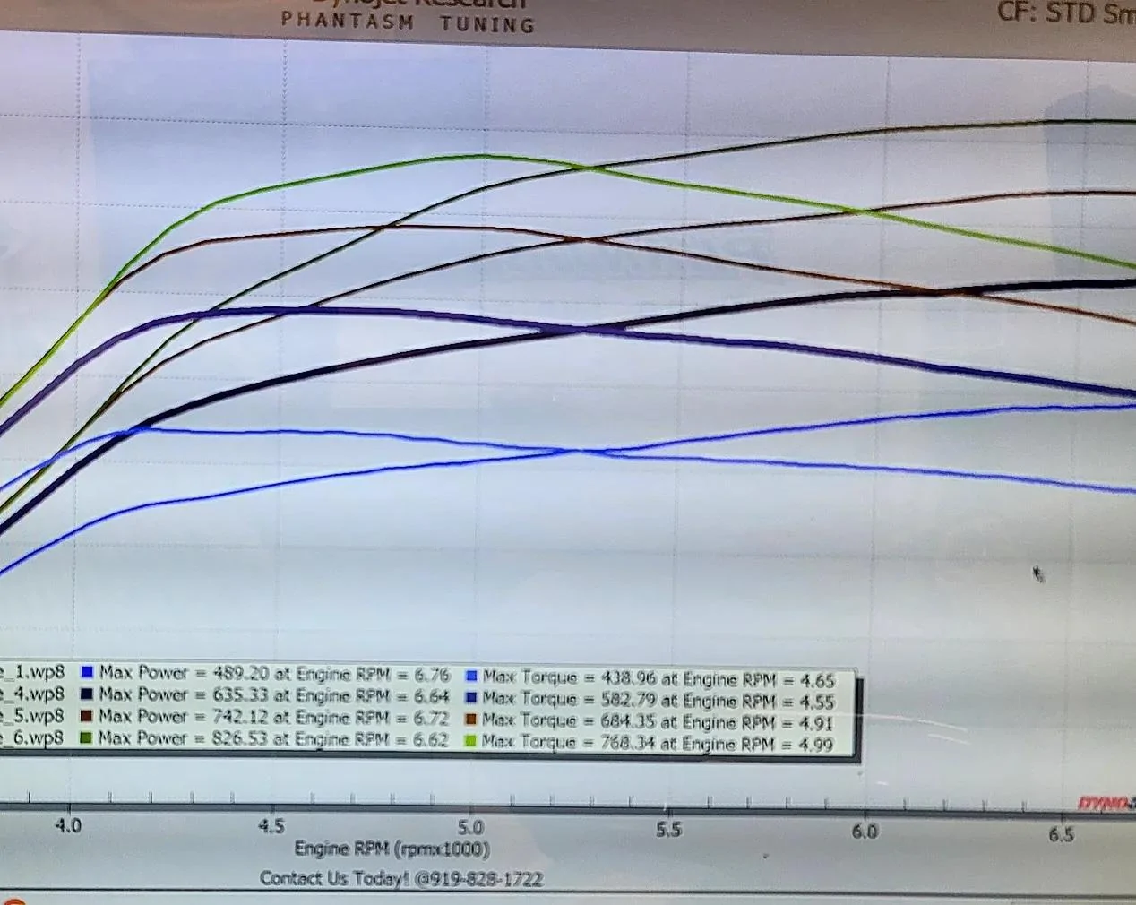

Got 3 maps done today with Mikey. What an awesome experience this was!
Map 1 on 93: 489whp / 438wtq
Map 1 on E70: 635whp / 582wtq
Map 2 on 93: 500+ / ???
Map 2 on E70: 742 whp / 684 wtq
Map 3 on E70: 826 whp / 768 wtq
Sound of the T51R mod

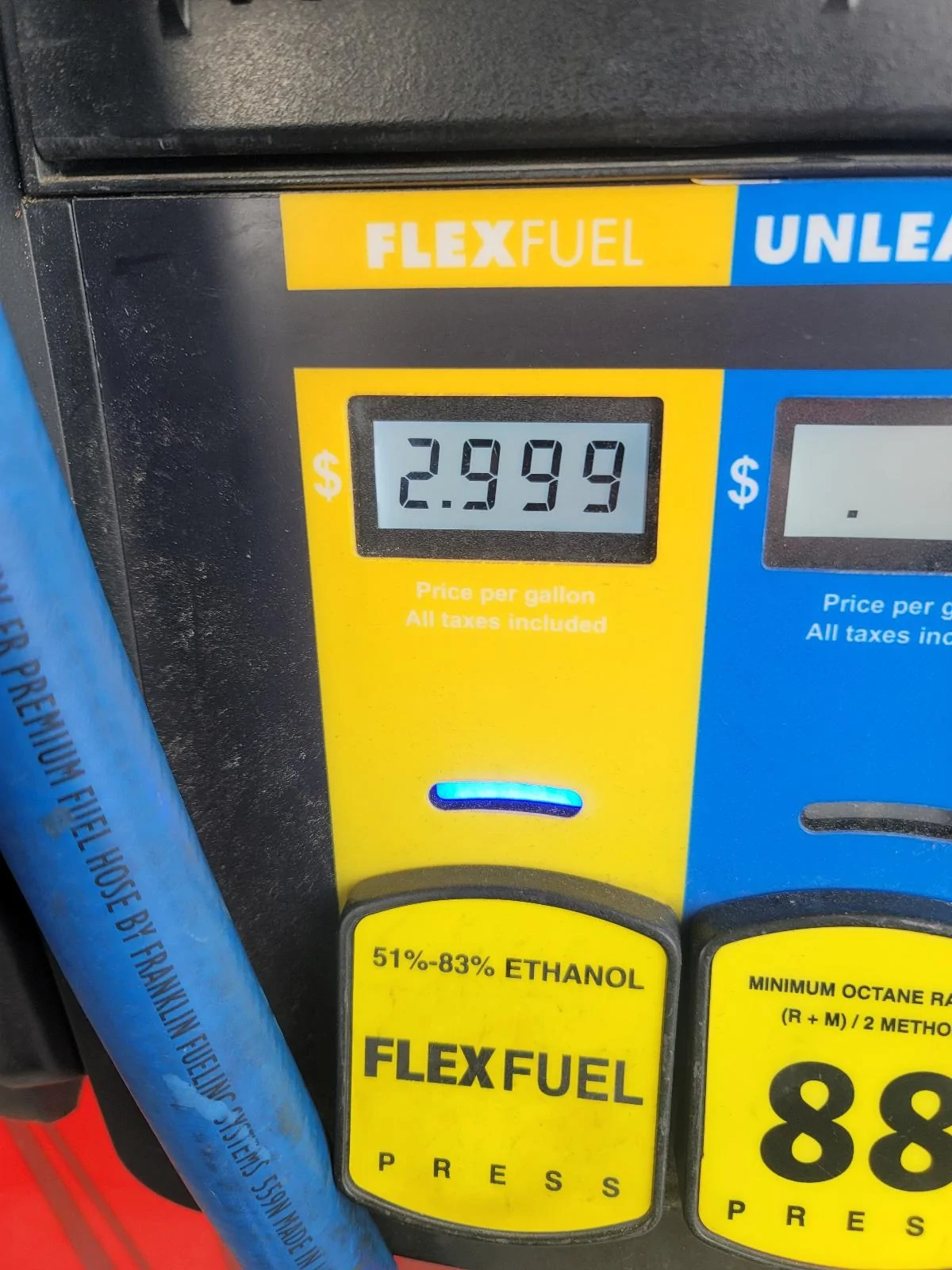

Surprised how cheap E85 is now compared to 93. Pump near my house has 93 for $4.89.
I know my fuel economy is gone, but it is still nice. Right now I think I'm getting about 10 to 13 miles per gallon. I just filled up so I will see how far I get with 1 full tank. I'm surprised at the Ethanol content ar Sheetz. I'm sitting at 73% right now.
I've been running map 2 without traction issues on the PS4S. But I'm not doing any digs. Just spirited drives on curvy roads.

Gotta love that summer time E content. Most places near me are at 85 some I've seen at 89!
