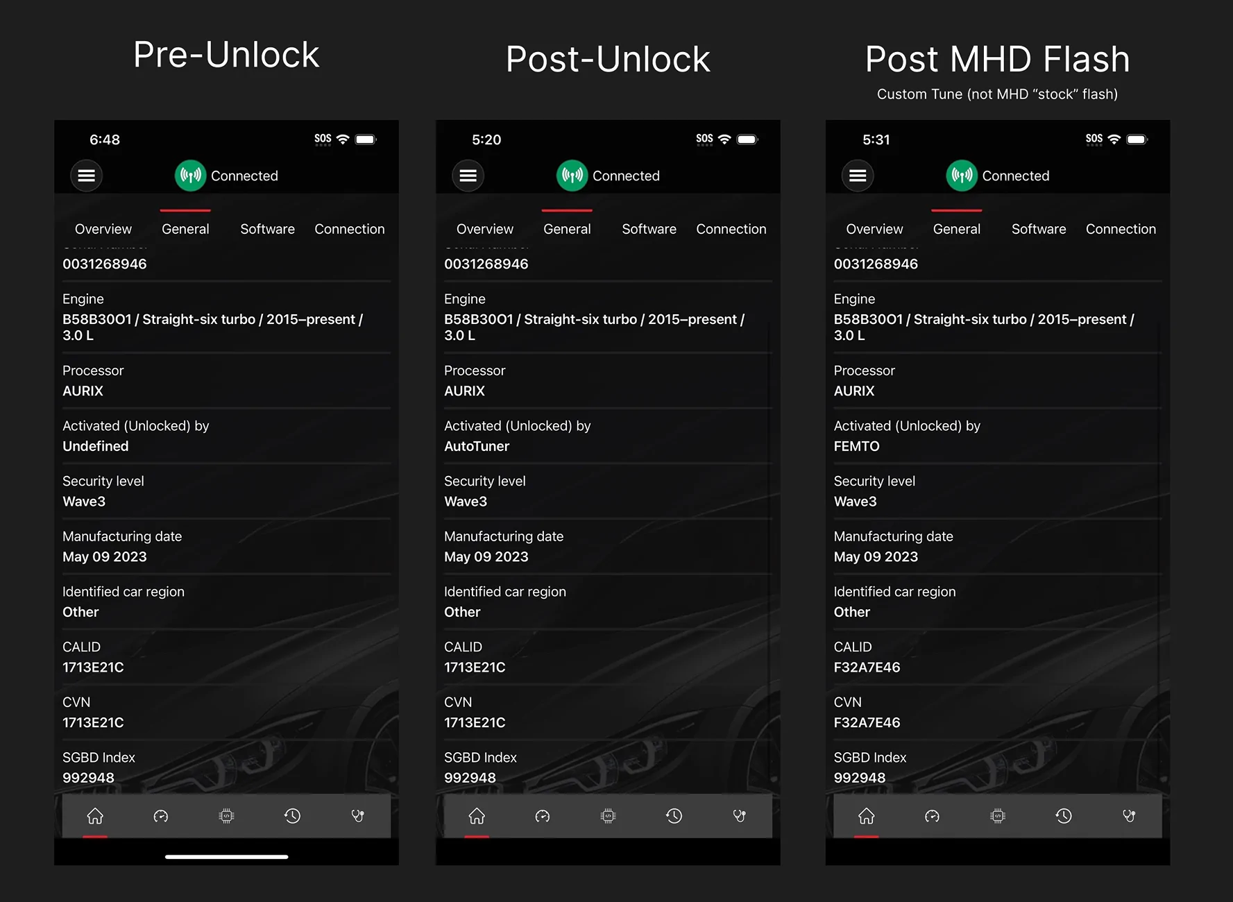

I think the only question that remains is that if you go back to the backed up image, what shows up for the state when they look at your ecu image? It seems like it should easily pass
Armin Hohvn (he now unlocks using autotuner and also does remote coding) confirmed if you have the original file, it will rewrite with the stock CVN CID numbers. So, with your confirmation that this will allow you to download and save the original stock file as a pure image (aka identical backup), I’m not worried.
So since the new unlocks by Femto and AutoTuner are advertised as unlockable, even after locked by the dealer, then does this permanent unlock alter the OEM CID and CVN when locked?
Or does it still retain OEM CID and CVN as if it was untouched?
From everything I’ve asked, put together and read, once you reflash back to stock using your own image, the CVN & CID is the original.
From what razorlab posted before, once he put MHD (or whichever tuning software) this is when the CVN & CID numbers changed. The unlock itself doesn’t change them, the tuning software does.
Ahh Okay, always thought the unlock itself changed numbers.

Unlock does not change CVN:
MHD flash with custom tune does. Also MHD changes the detected unlock too it looks like haha.
Does unlock change the CID?
Edit: NM I looked at the pic 😆
