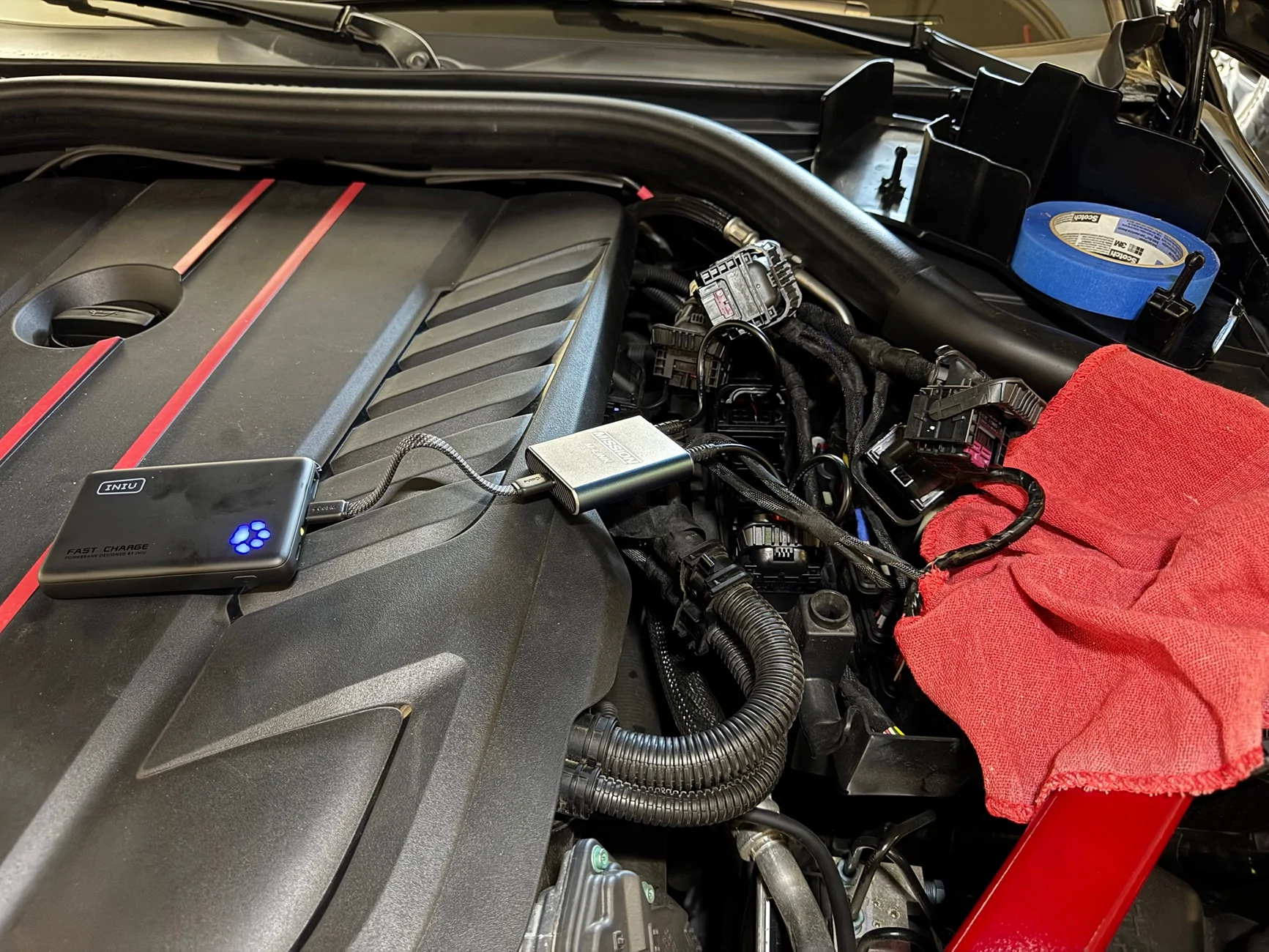

While you wait for yours to arrive, you should read the M-Link User Guide and prepare yourself: https://missiontuning.atlassian.net/wiki/spaces/MLink/pages/688383/M-Link
A few notes from my unlock experience:
Mission had a bad batch of PD power banks to power the M-Link. I didn’t want to wait so I had them ship immediately without their power bank.
This power bank worked well for me: https://a.co/d/0gOHfaKG
I also ordered this charger as a back up, but didn’t need to use it: https://a.co/d/0egp5gZ0

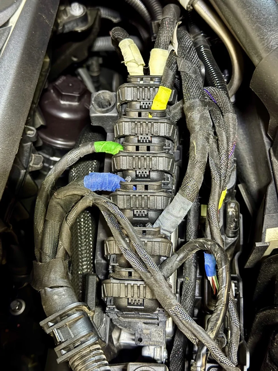

My DME harness had colored tape on them, so I didn’t bother to label them with tape:
Pos 1-black
Pos 2-grey
Pos 3-blue
Pos 4-green
Pos 5-yellow
Pos 6-white
User Guide recommends unplugging negative battery terminal, but says putting the car to sleep is an alternative. I opted to unplug the negative battery terminal and waited 30 long minutes before disconnecting the DME connectors.
Pos 1-black
Pos 2-grey
Pos 3-blue
Pos 4-green
Pos 5-yellow
Pos 6-white
Thank you. I bought there pack just in case, but have my own portable as well, figured $20 for just in case.
They already shipped mine, bought the 2 needed MHD licenses as well and pulled my stock files off the DME using MHD already.

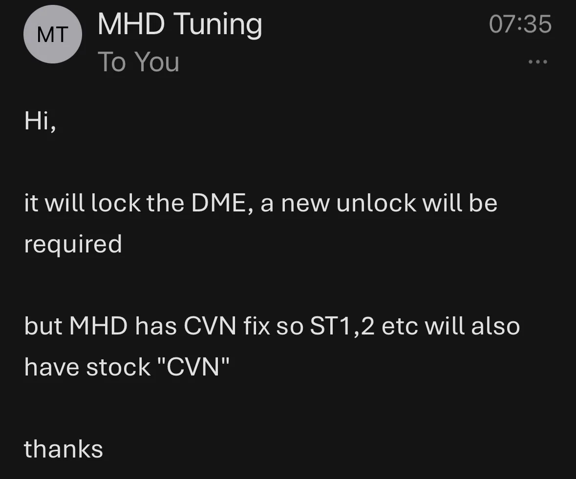

I asked Mission if it could relock the DME back to stock and they didn’t comment.
Supposedly MHD can flash back to stock without locking the DME. When the time comes and it doesn’t work I may bite the bullet and get the Mission.
So I asked MHD if using their flash back to stock feature will keep the OEM CVN and calibration ID, as well as if it will relock the DME.
They say it will relock the DME.
And I think it will give the stock CVN, but not sure what “ST1,2” means? Or if it will have the same calibration ID?
