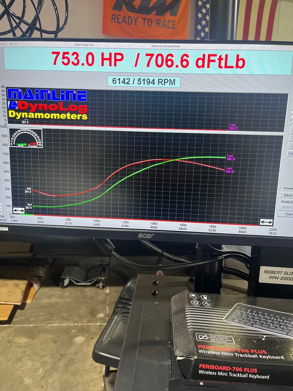

The Difference between the Nostrum high flows and OE S58 injectors is pretty insane. I'm at 30psi with a similarly sized turbo (Pure 900) my Injector duty cycle stays around 80%. Yours are low 70's running more boost.
Log attached just for comparison https://datazap.me/u/manjot14/multi-gear?log=0&data=4-23
I have the Nostrum's as well and i'm at 76% at 35 PSI near redline with an Omega 65 V1 (shoup tuned). Great product, I think dorch has a larger non OEM set in dev. +100% iirc.

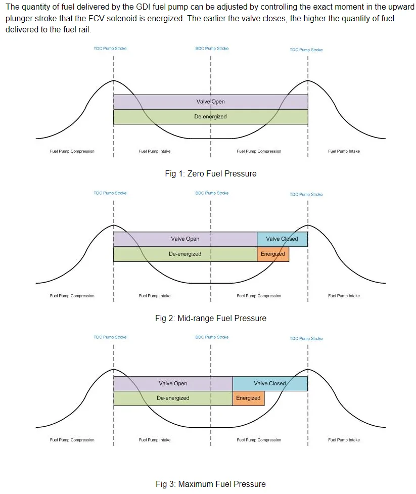

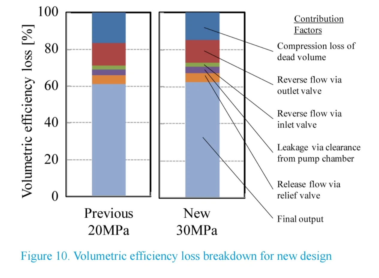

DECREASING the rail pressure to 4070 psi (from 5071 psi stock) to try and get more out of the HPFP,
Do HPFP's even work like that? I know that trading pressure for flow is a common strategy with electric pumps, but I was under the impression that cam-driven fuel pumps deliver the most volumetric flow when the commanded pressure is high.
https://openecu.com/gdi-fuel-pump-control/
edit: time to check the literature
https://legacy.sae.org/publications/technical-papers/content/2015-01-1273/#:~:text=Besides these topics, one of,pressure pumps for GDI engines.
Looks like from Modern design fuel pumps, running higher pressure has a negative effect on leakage and reversion losses, but has a net positive effect on dead volume compression. Resulting in higher overall efficiency.

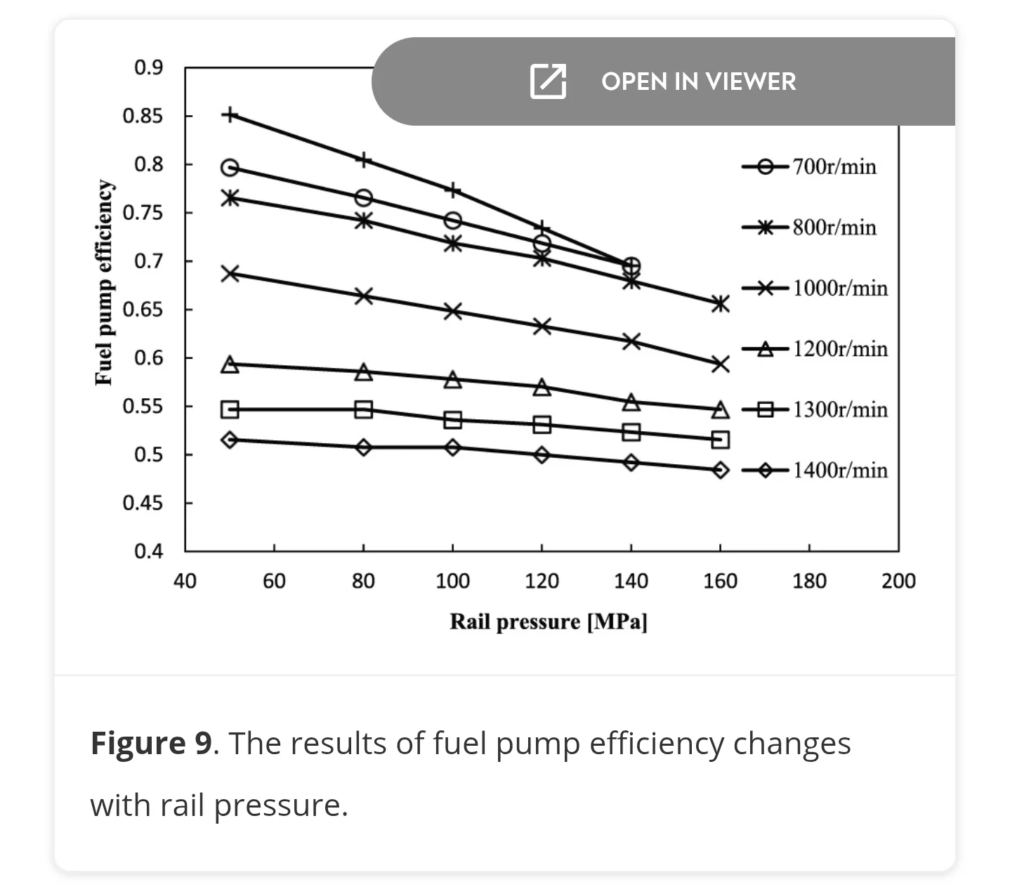

Edit 2: for diesel common rail systems it looks like the strategy works, but the efficiency gain is nothing compared to what is wiped out by rpm. Not sure if this is representative of gdi...
https://journals.sagepub.com/doi/full/10.1177/1687814018795591
