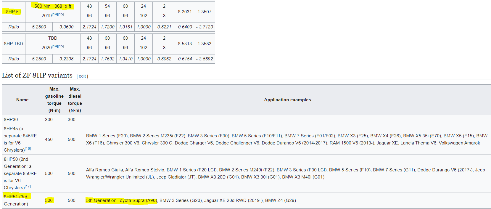

People don’t realize but our 8
Speed zf transmission comes on the $200k Lambo Suv too.
Since Urus has 850 N⋅m (627 lb⋅ft) torque, it must uses a higher spec model, the ZF 8HP51 Supra uses can take only 500 Nm (368 lb·ft) spec-wise.
I tend to disagree.. So your saying our ZF can only take up to 368lb ft of tq only? Lol

@bigcat is correct... There are bunch of different variants of ZF. Dodge Demons have ZF in it and they are 800hp from the factory.
If you are pushing big power, you will need to get your trans built
This doesn't make sense, right? Isn't the 2021 engine rated at 368 ft-lbf? I doubt a manufacturer would pair an engine at the max torque rating. Even if there is some factor of safety built into the design. Doesn't add up to me.
I know people running much more power (550 tq) without issue. I'm not sure I understand that graphic either.
Gonna say a nope to this. These cars are making 400ft/lbs on the dyno stock.
Big power would need a built trans but that chart is wrong.

It's just like the engine or the CPU in your computer, you can always mod it to get more power until blowed up, but the spec is the spec.

Guess that explains why the "official" torque rating for the 2021 only went up 3 to 368 while the horsepower went up 47 to 382. They probably couldn't advertise more because of the torque rating on the transmission.
