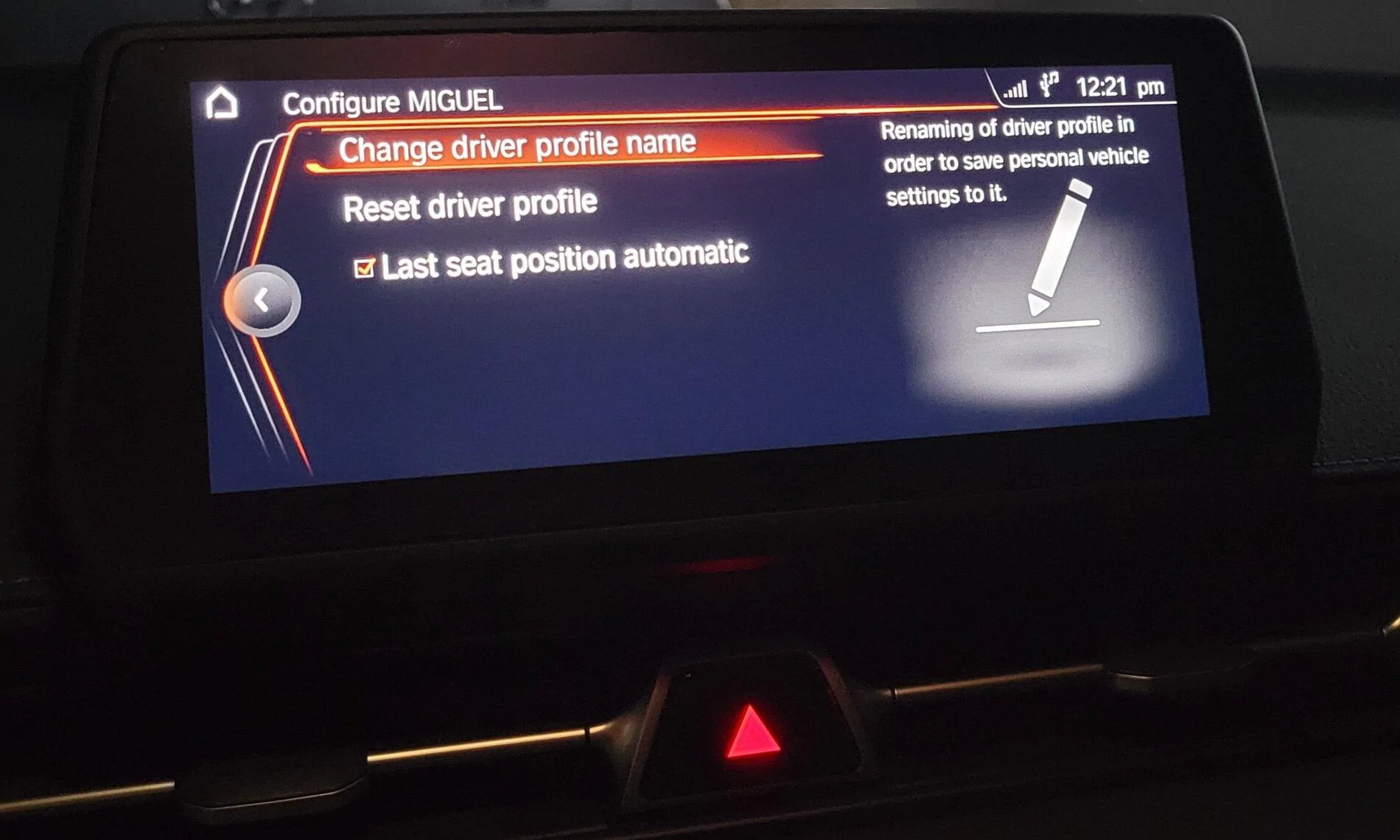

If you donā€™t have full screen carplay the I-level has not been updated, which means the brake booster campaign has not been completed (if your vehicle was subject to it - my understanding was every 3.0 supra made was the subject of the recall).
To verify your I level:
BimmerCode shows it on the vehicle information screen; or
Export your driver profile to a usb, then use any text editor to view the resulting .mpd file and it shows the current I level in plain text.
To export your profile, Navigate to "My Vehicle" and select your profile,
Select the ā€œExport to USBā€ option.
If the I level is below S18T-21-07-519, (Supra, 2021, July, 519) you wonā€™t have full screen carplay and the brake booster recall campaign has not been done.
This workflow pic may assist the tech.
Am I missing something? I don't have an option to export my profile. Is there any other way to check this?
Edit: Ok at least BimmerCode shows the version, but still would like to know how to export the profile
