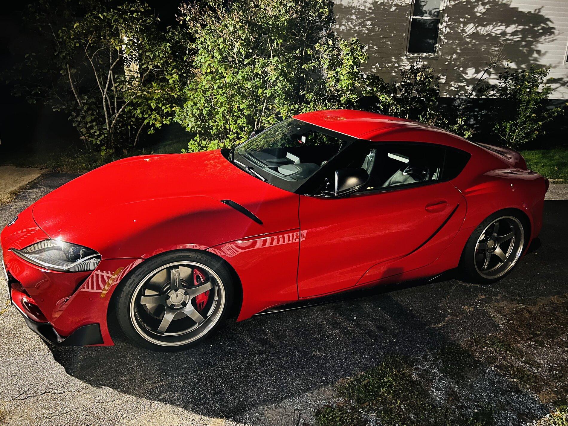

Had my recall done along with an oil change this past Saturday. No issues what do ever. Loving my full screen car play and definitely noticing that it’s braking better.
was also really impressed how the MasterTech ( only one allowed to touch Supra’s-from customer hand off point to customer pick up) doesn’t work on them on a lift. He works on them on a brand new state of the art Hunter alignment machine.
he’s made it a “ best practice “ thing to give any Supra he’s working on a soft alignment when he’s done doing whatever he’s gotta do. Which is awesome.
I definitely noticed my car driving more tighter and straighter Than what it was when I initially dropped it off. I came to find Out that they kinda go around and tighten things up for you, also grease/lubricate things if they can. Clean up the brakes etc.
those small little touches makes a difference. I love it when Mechanics take pride in their work and make sure to give the Car back better then it came in. Granted if it’s nothing major of course.
dealership I deal With is in Massachusetts. They again also only let the MasterTech touch it. Who in this case is a grown ass man in his mid 40’s. Not some punk ass scrawny vape Boi.
sitting pretty at home. Really feel bad for those who get these horrific experiences.
